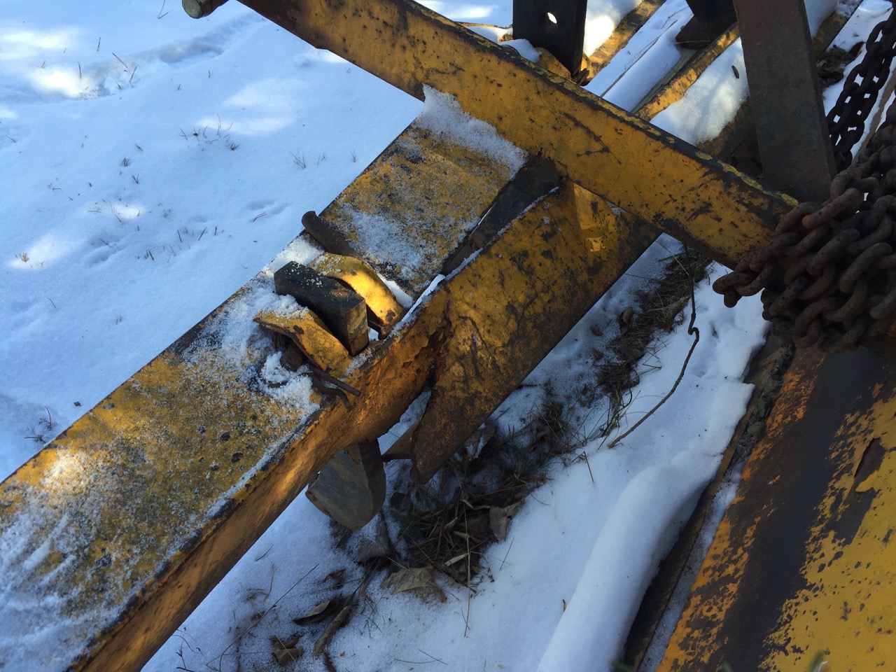

trying to figure out if it is worth trying to repair this box blade, or do I need to starting looking for a replacement... (I don't have any welding skills, but that is something I'd like to start learning)
/ repairable? #2
More pictures please. You will need to show both ends of the blade and how blade is mounted to frame.
It appears to be a cutting edge like on a grader blade, those you unbolt and replace when worn.
/ repairable? #3
My first impression.
Looked to me like the square tube holding the scarifiers and hitch. Appears to be made from 2 angles welded together. Probably broken by hitting an immovable object with the bent scarifier.
Doesn't look hard to fix based only on the one photo. The other end may make a difference.

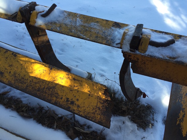

this is the front edge of the box blade that holds the scarifiers

Most welding shops could repair with no problem. Shouldn't cost no more that $100. Ken Sweet

Perfect job to learn to weld on. Your first few tries will likely fail. But you'll have a welder & increasing level of skill to keep re-fixing it. A skilled welder could make a box blade in a few hours if all the parts were pre-cut. I'd imagine you are looking at an hour or 2 to patch it back together tops if you have a pro do it.
Learning to weld would be a great investment for any tractor owner. A welder & gear costs less than an implement. And once you learn, you can fix modify & even build your own stuff to suit your needs.
Who cares if it looks ugly or fails a few times? A box blade isn't life critical & failure just means a little bit of your time.

Certainly repairable. But I wouldnt spend more than $100 at most on it. IF you cannot find anyone to do it for that or less, either learn to do it yourself, or get a new one. That double angle isnt really a heavy duty blade design. And I see 5' box blades all the time on c-list for ~$250-$400 That would be a better blade than yours would be AFTER it were fixed.

I agree with LD1, if you cant fix it yourself, then the cost to fix at a shop is going to be at least half the cost of a used one in good shape that is a bit heavier duty than the one you have. I really cant imagine what happened to that one to cause that damage. I have stalled my 70 HP pulling my box blade without damage. I do sometimes break a scarifier when hitting large rocks but never damage the frame. I do try to go slow when scarifying with the tips buried to the hilt though.
