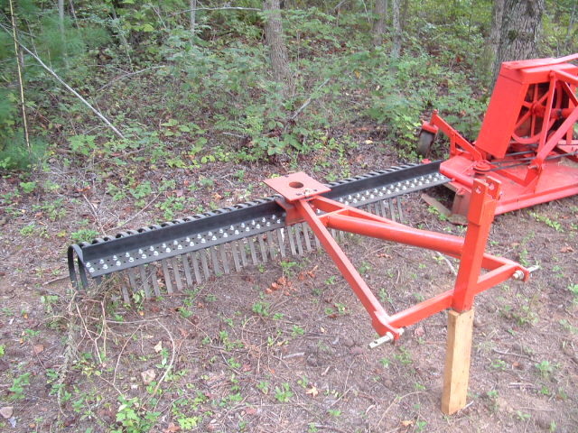

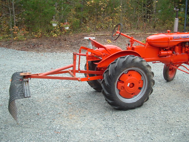

That will definitly work, but I have found in the past that a landscape rake is one of the most indispensible pieces of equipment that I have. I use it to smooth the drive,level rough ground, pile brush, spread gravel/dirt, and ,oh waay, landscape.
I built mine, a 72" for a 3PH and love it. I used it today to windrow a lot of small rocks on a place I am going to sow in grass. HTH, later, nat
BTW the B allis in the pic is about 19-20 HP
