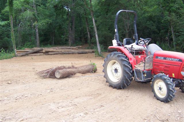

I'm not a big fan of the box blade and rarely use mine for anything but storing stuff on top of it. If the damage is light, then it will work fine at smoothing things out, but for large areas, and for really rough ground, I don't think it's a very usefull tool.
I have hogs on my land and they do some damage from time to time. I have a pretty good selection of implements and tractors to use, but my favorite is my log drag. I have an 8 foot length of oak that's almot 2feet thick and has cyclone fence wraped around it. Then the fence drags behind the log. I have a chain bolted to either side of the log, and I just hook it over a tow ball on my draw bar.
The first few passes are always the toughest because of the roughness of the rootings, but then it starts to smooth out and you can pull dirt from the high spots to fill the low spots. The weight of the log will crumble the large dirt clods and the fence will break them down and make it smooth.
If it doesn't work, you're not out very much money. I found mine to be very useful at smoothing my trails and even wiping out tracks to see what's around during the night.

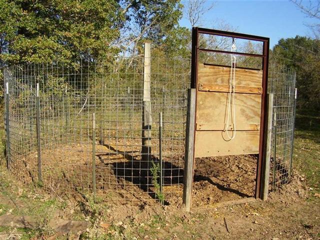

I just don't think a BB will work that well the way the hole is wallowed out.
But for pig control...put up a hog trap. Around the weekend place they'll catch them, it they are big enough they'll take them to the cattle yard and sell them. If smaller they'll pin then and fatten them up. The guys quickly soak the corn in diesel, this keeps the crows and deer out of it. Of course some just kill and disc up. Depending on the trap and herd, you can get several at a time. One guy came by the house once with 14 piglets in the trap. All about 15#. They were fattened up and sold.
