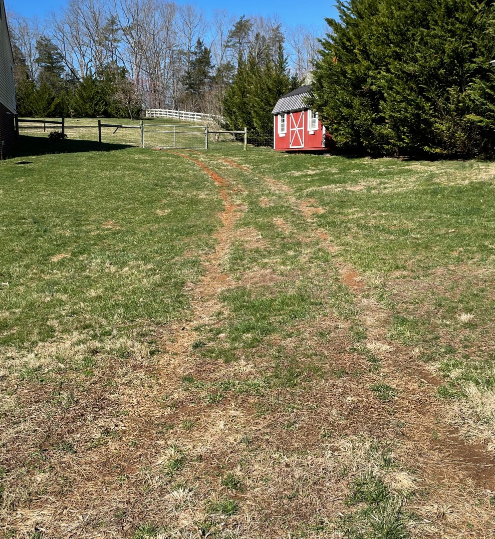

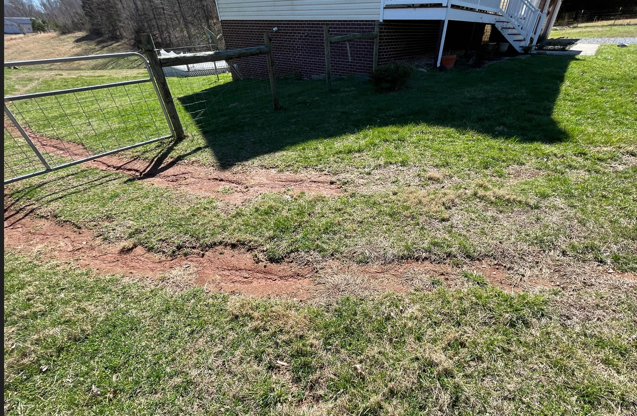

Thanks for all the replies folks. 2manyrocks mentioned that pics would help so I took a few so you could get a better idea.

first and second picture I would just add soil not much of a ruts there at least from what I can tell from the picture's. The one with the hill and the wash out I would make a ditch on both side crown the road and restore the vegetation or add A gravel or better 2inch minus... but if one or the other is not done you will always have to deal with this but in all cases you need to restore the vegetation or add materiel that will compact and keep the water out from the roads to keep it from happening.

The yard ruts arent what I was thinking they would be. For those, I would just use a rake or chain drag to smooth. The field road, I marked in red because, IMO, the water source is somewhere higher up. The water source needs to be diverted away from the road. From what I’m seeing in your picture, the area marked in orange is sloping away from the road. IMO, I would slope the road (blue arrows) to the right and cut a ditch (green arrow). I would not crown this section.
