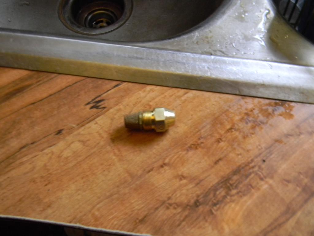

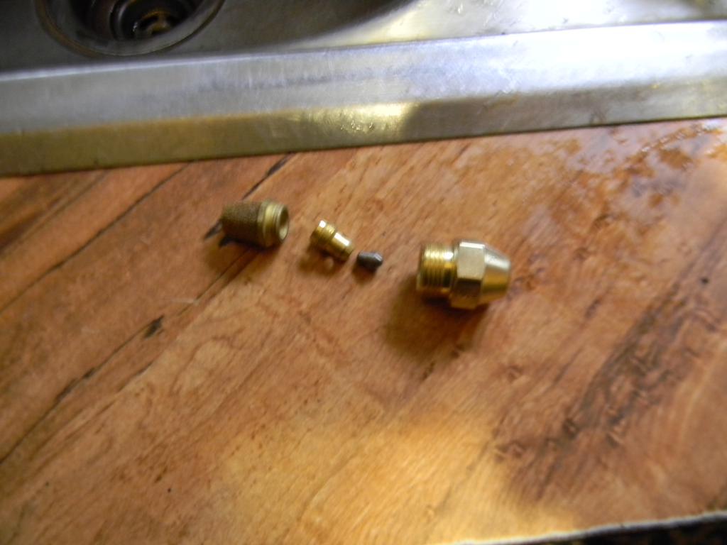

I have a similar if not the same type nozzle for my furnaces. When the nozzle is removed as your picture shows nothing rattles if I shake it and air (or fuel) will blow through easily. Inside the nozzle tip there are parts that will rattle if they come unscrewed. Not sure if there is a check ball in there or not. I hear no rattle on mine with the nozzle removed. Once a year I change the nozzle tip. Then take the old one apart and clean it in lacquer thinner or similar solvent then reassemble and put back on the shelf for next year. I always keep a couple spare tips around as my filter doesn't seem to catch all it should.
