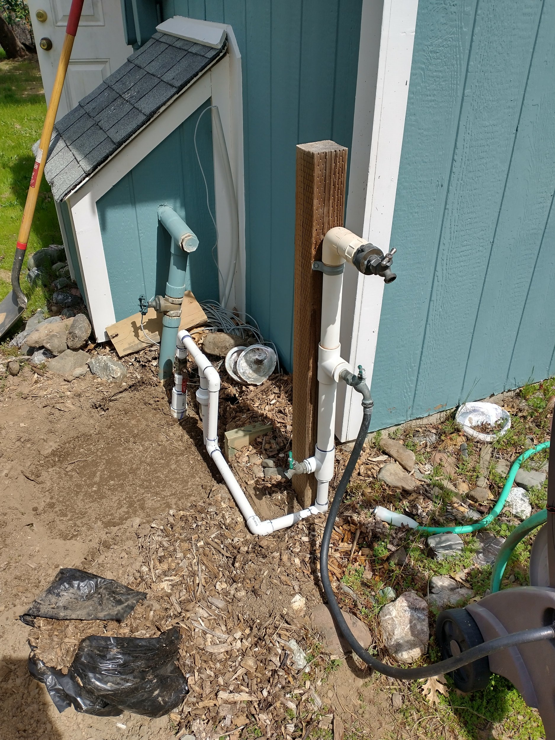

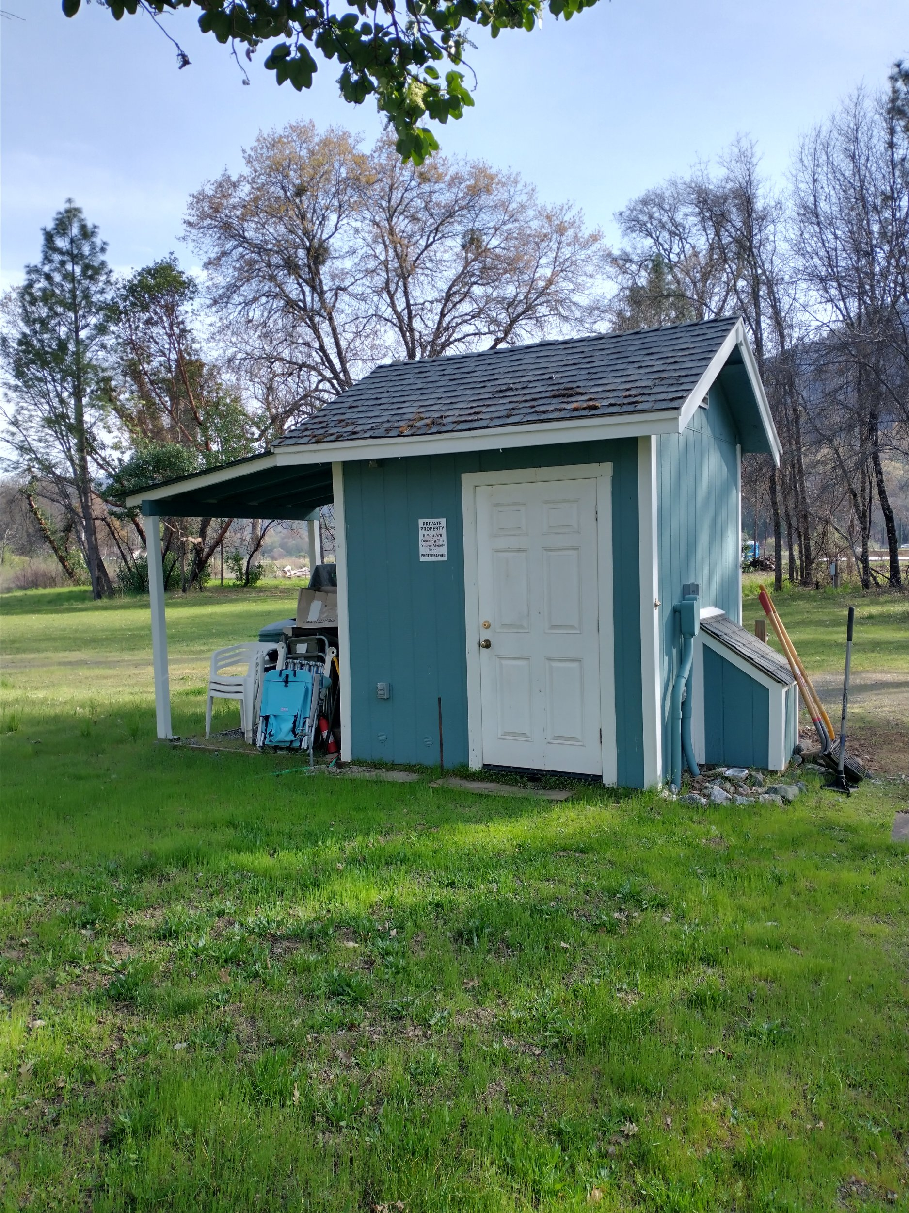

Here's my pumphouse. 8 x 8 feet with a 2 x 2 feet 'dog house' extension covering the well itself. The dog house lid is held on with deck screws. No need to move the building for pump removal, and there's a slab under all of it. I built the walls and trusses at home and hauled them up to the property on my truck/lumber rack before we built our house 25 years ago.

Dirt or concrete - tight to the well casing and sloped away in all directions. Main idea - no ponding right around the well casing. That's why recommendations are - above ground well house. A pit well house poses a potential problem.

In the final picture, is that an easily-removable one on top that can be used to hook up a fire hose? What do you call that (and a link, if you still have it)?
   / Replace or extend slab around water well? #20
Fire hose threads can be somewhat local. If you want to make sure that your local fire department can also connect to your standpipe, I would check with them before buying.
I have bought from Fire Hose Supply | Buy Fire Hose & Adapters Online FireHoseSupply.com My local fire department wants a blue reflector on it as well. If you are connecting to a tank system, I would suggest a high flow fire valve as well.
A friend found out the hard way the importance of having a metal standpipe when a grass fire came through and melted his PVC standpipe...
All the best,
Peter
