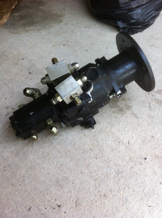

If you look at the VVP pump picture, you'll see a thick black vertical plate between the VVP and engine. That vertical plate goes down and meets the end of the horizontal engine mounting plate.
I was wondering how the pumps bolted to the engine on the stub shaft mounted on the fan end, since the fan would get in the way of any bolt holes.
I guess I see why PT went to stacking the pumps; a lot less work then using both ends of the engine.

Yeah, they have a little more cost with adding the stub shaft, but I'd guess they have a little more cost getting a VVP with an output shaft to drive the stacked PTO and Steering/lift pumps.
On you folks that have all three pumps in front of the engine, is there a bracket that hold up the pumps, or are they all hanging off the engine mount?

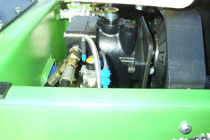

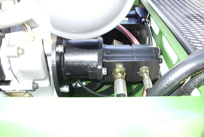

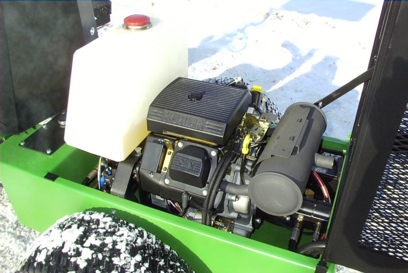

Here's some pics of my 2001 425 with the Kohler. PTO/Steering pumps behind the engine, variable volume tram pump in front of engine.
The PTO/Steering pumps are attached to the factory output shaft on the Kohler.
The VVP is attached to a stub shaft that comes through a hole cut into the fan guard. That stub shaft is a factory part from Kohler for those kinds of applications.
I'm gonna guess the 422 was set up the same way.
Looks very similar.
All of them are just bolted to the side of the engine. No support bracket.
   / Replaced engine on my PT422 #18
on mine the pumps are bolted together and then the rear flange is bolted to the engine mount....there are no brackets or seats it just cantilevers off the flange bolts
pump.jpg....Jack
   / Replaced engine on my PT422 #19
View attachment 563893....Jack
Interesting. I'd have thought there'd have been a support bracket. Thanks. Just curious as to all the different setups/generations that we've seen over the years. Hard to believe mine is 17 years old already.
