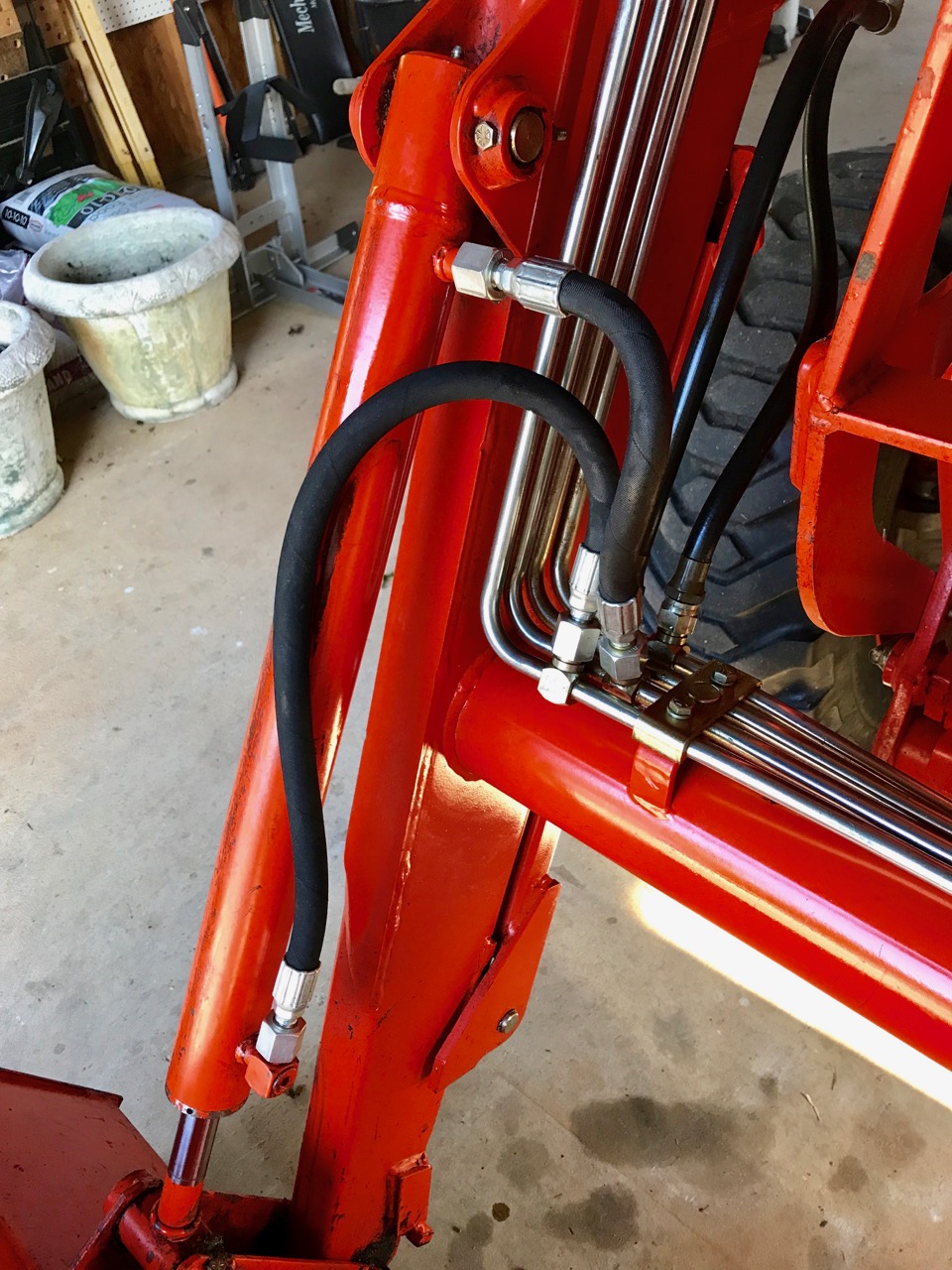

The correct fix for this could be obvious. The 2 cylinders may be fighting each other because lines are crossed on 1 of the curl cylinders. But, the pics seem to indicate correct symmetry.
So, looking at the right side of the loader frame, the 'top' line is push (extend) pressure (which is happening). The 'pull' (contract) pressure is too low, or the pull return is blocked. Loosen the hose connectors and check for the presents of pressure in each direction. Watch out for jets of fluid, only need a small turn on the hose nut. Use a rag to receive the oil jet.

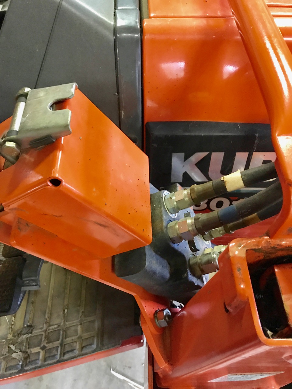

On this part?
   / Replaced Hydraulic Hoses...Bucket Issue #38
No. Follow the in hose to that valve and it well go down under the right floor and hook into a hyd block that I am talking about.

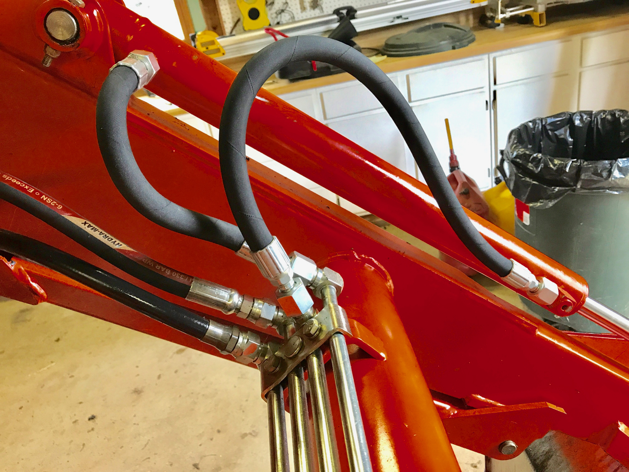

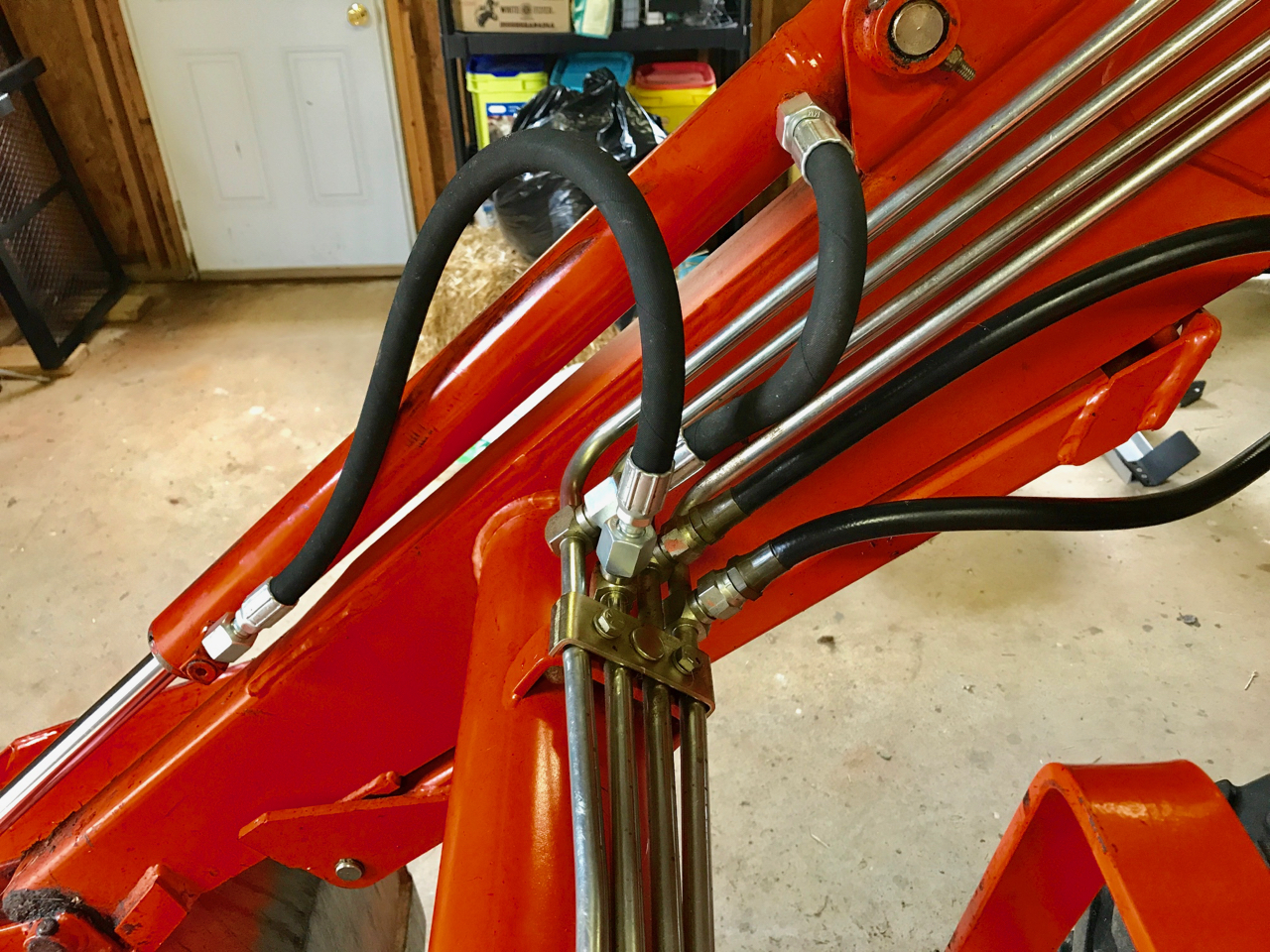

We swapped the hoses and fired it up. Instantly corrected the issue. Bucket fully functional...dumps all the way, rolls back all the way, boom runs up and down fully. No leaks.
Thanks for everyone's effort to help. Guess I should have focused more on whether or not the hoses were correctly connected.
