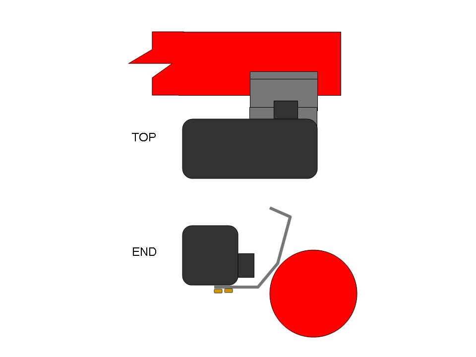

Lance, why don't you build a simple deflector made out of thick sheetmetal or aluminum? All you want is to keep the heat off the cylinder and deflect it upwards. I think the illustration below would work. I've shown brass screws into the bottom of the muffler, but you might find another way to mount the shield that would not require screwing into the muffler itself.

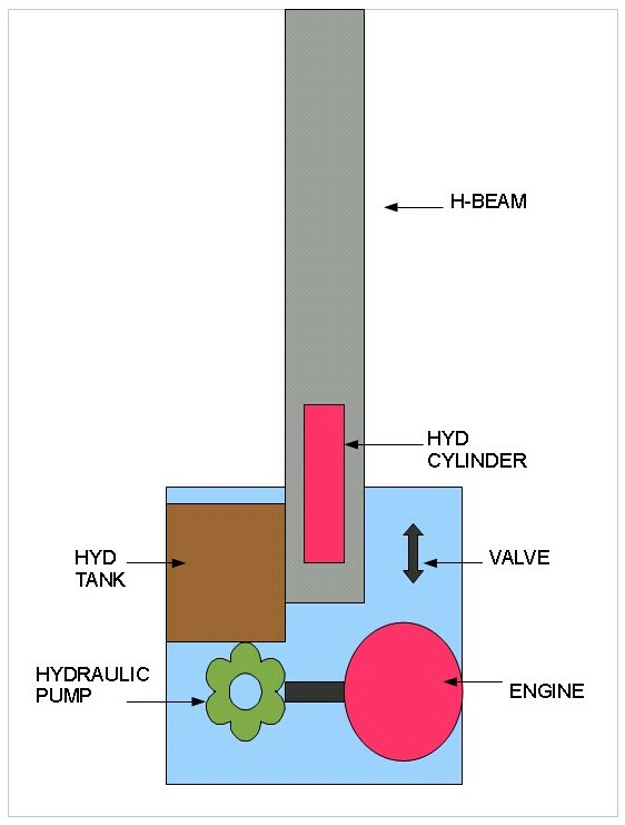

Instead of modifying the muffler, I will suggest changing the components layout. Attached a drawing to help with idea's. In the long run, I'd think you would be happier.
Great idea, i bought a piece of 22 or 26 gauge sheet metal from Lowe's after reading your post, but when building my push plate, found that my cylinder arrangement could move forwards and away from the muffler. I'm still going to construct the deflector plate, but it is not needed as critically now. Thanks for the great idea though!
Thanks for the idea Rhett!

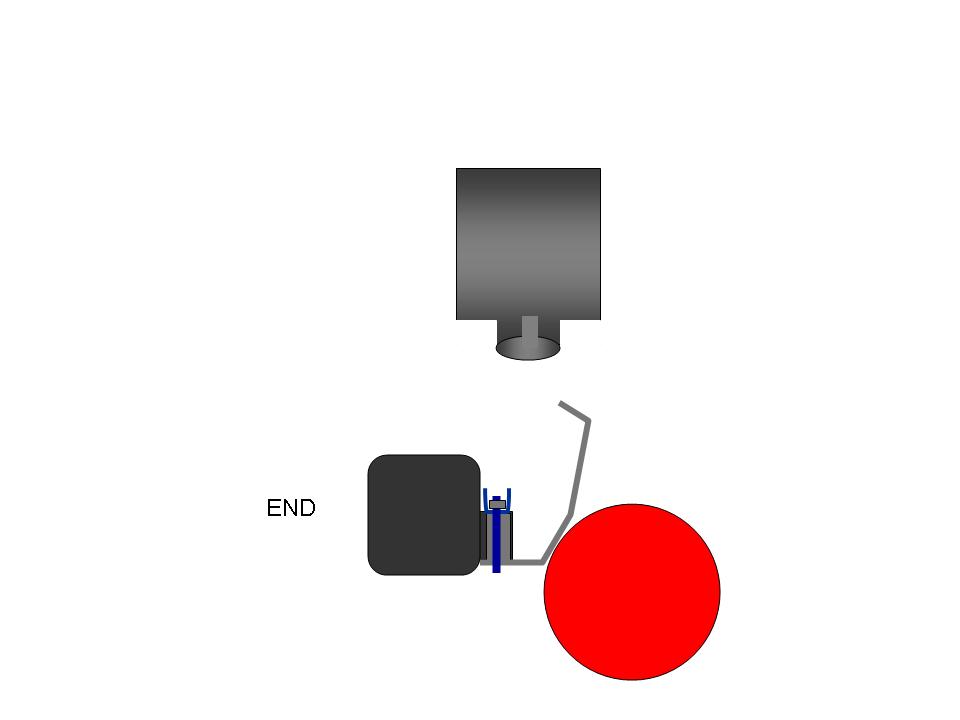

As usual, I thought this through a little more and came up with what I think is a better idea. I'd cut your sheet metal about 3/4" in so that you can form wings up around the outlet of your muffler. It looks like plenty of tubing there to put on a muffler clamp around the wings and just let that hold the deflector in place. If your metal is strong enough to do that and support itself, that's what I would do. It might weaken with vibration and the buffeting of the exhaust, but I doubt it will be an issue with 22 ga material.
