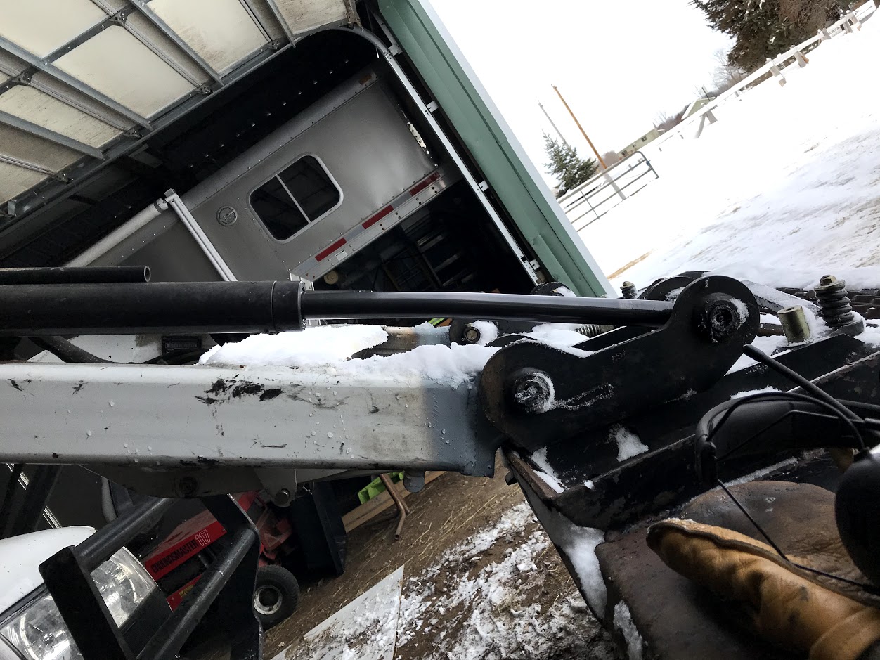

I managed to bend a curl cylinder on my 7TL. Bobcat wants $900 to replace or $330 to replace rod and seals.
Has anyone found a cheaper option?

Just curious, how did you bend it?

If you just bent the rod stick it in a press and straighten it .

I broke the pivot point off the loader arm with a over-sized bucket full of snow. It twisted the other pivot and bent the rod.
   / Replacement 7TL Curl Cylinder #8
That's a very slight bend easily straightened. As for the pivot points a machine shop may be able to get you back in action.
