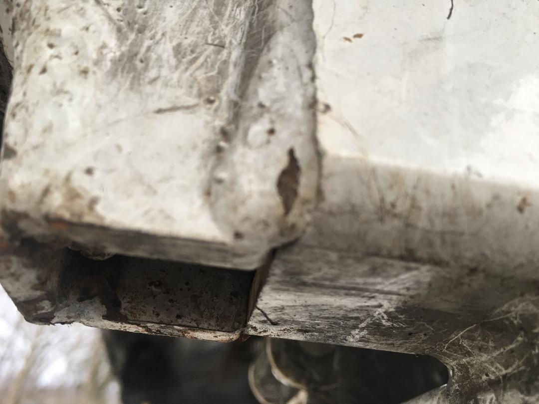

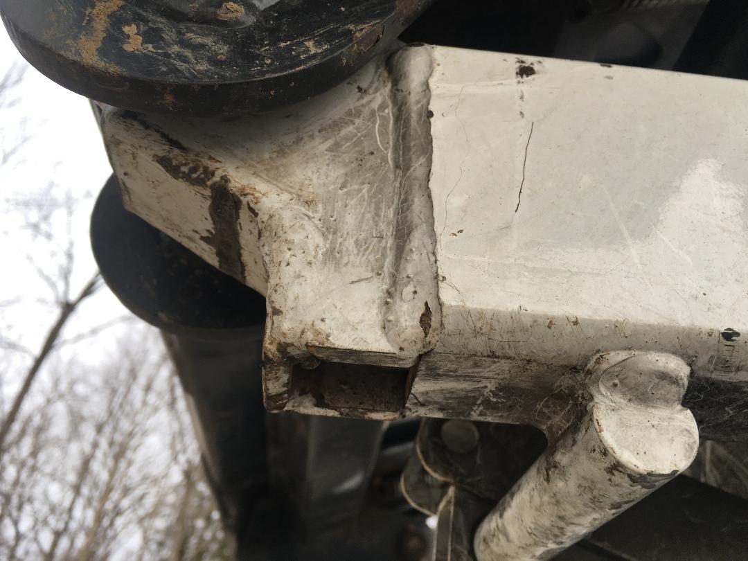

Like I stated in a earlier post, that I was going to go inspect my loader arms.
Below are two pics of what I hope is not the beginnings of an issue.
371 hours on my tractor.
Does the "scratch" at the bottom of the weld appear to you to be the beginning of a weld failure or just a scratch in the paint?
I am almost tempted to go ahead and grind that part of the weld out this spring, drill it and re weld it.
As you can see, it is almost directly through from the location of the pivot mount
   / Replacement 7TL Curl Cylinder #14
also one other point, I know there have been many statements on here that back dragging with your bucket is not very good on your loader, and I have to own up that I have never taken heed of those warnings.
   / Replacement 7TL Curl Cylinder #15
I am guilty of the same. You just have to do what works sometimes.
