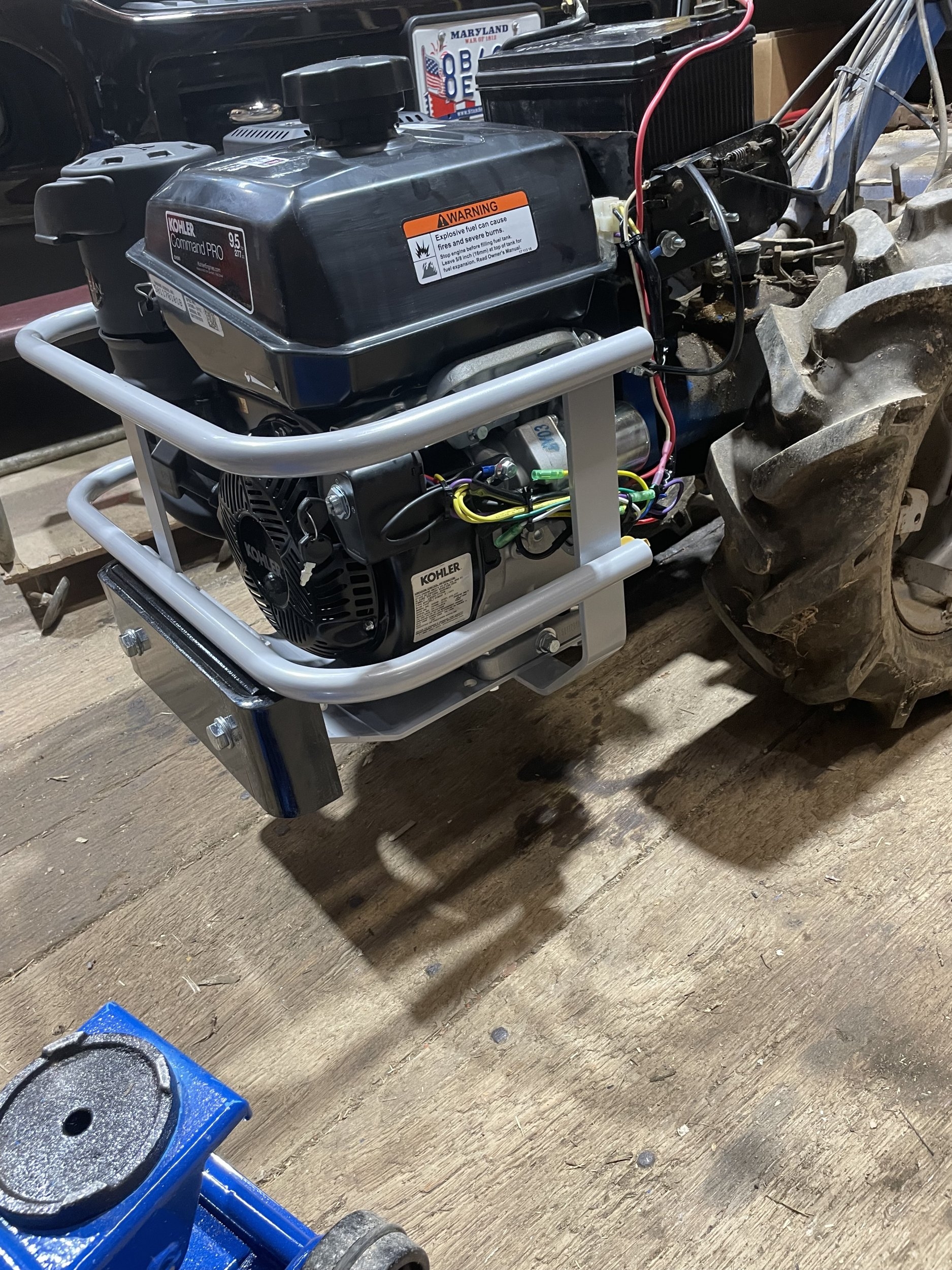

I replaced the original Acme 10 hp with a Kohler electric start from Earthtools:
