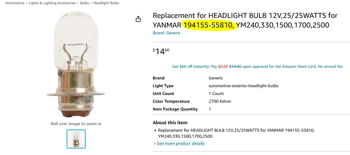

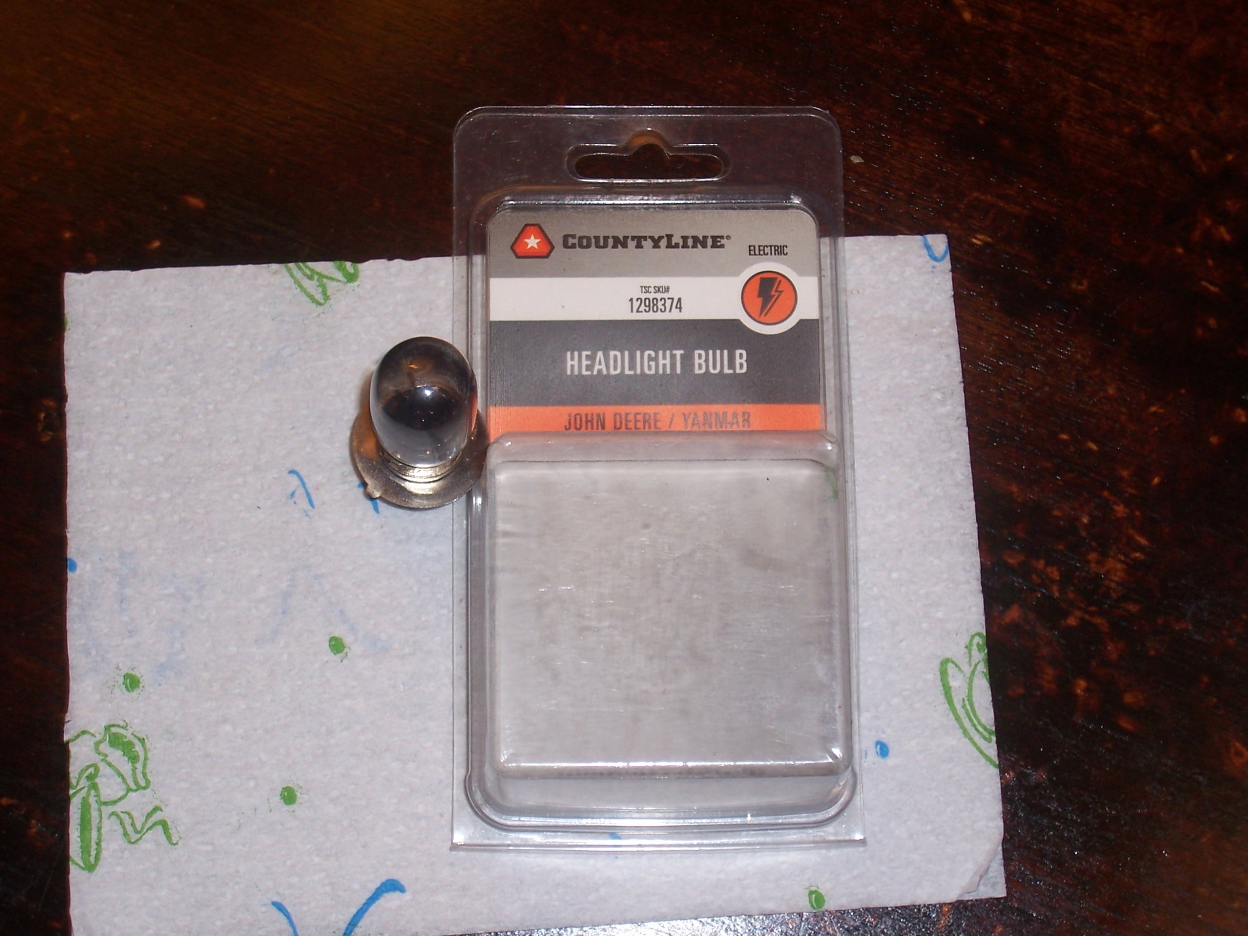

LB-4155 195 240 276 330 1500 1700 2000 2001 2200 2210 2301 2310 2500 2610 3000 3810 4300 One of my Org. Yanmar lights is Org. never changed that one and the Fredricks 4115 has been in use since 09.
P15D25 is a lower watt bulb. 12V-25/25W and the correct Yanmar bulb LB 4155 is 12V-35/25W a smaller Watt bulb. One of mine is Org. and the Replacement has lasted since 09.
May try the correct Yanmar Bulb you might be surprised how well they work.;)

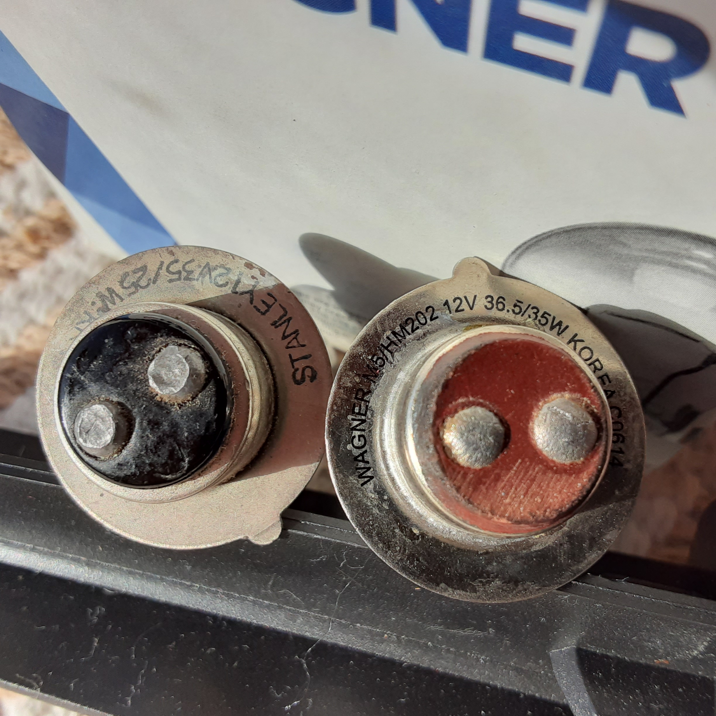

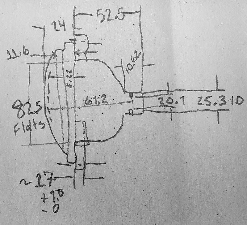

The Stanley 001-1259 headlamp assembly is used in these YM and Deere 50 models

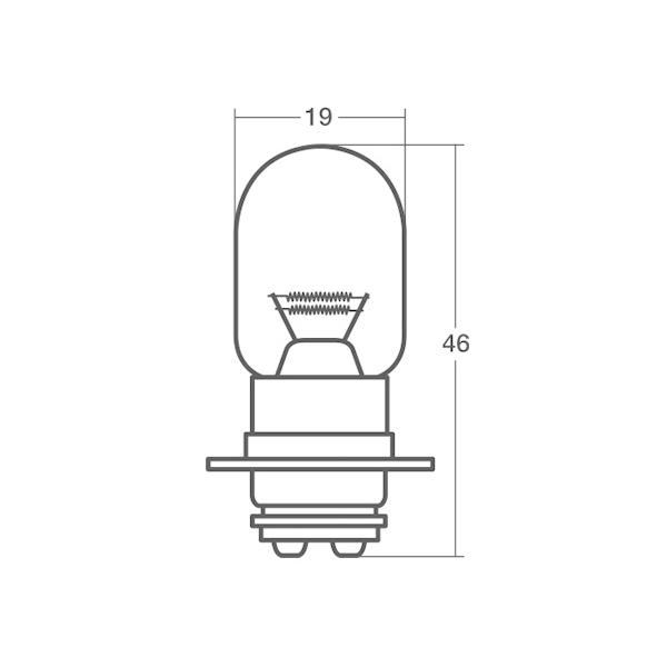

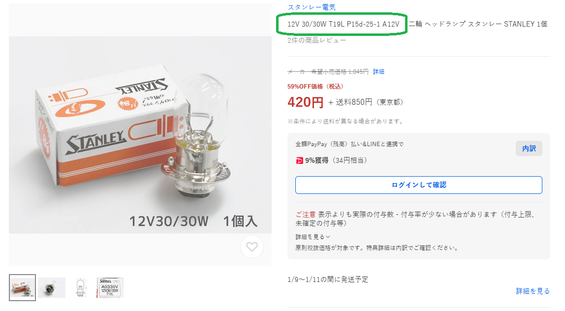

My Fredricks UTDA YM2610 came with the original Stanley P15D25 25/35W from Yanmar in Japan. See it right here:
The Yanmar p/n is 194155-55810. In the description is the Stanley p/n of A12V 3.4W
I go to Yahoo market in Japan and find, A12V = P15D25 sold by Stanley on the website.

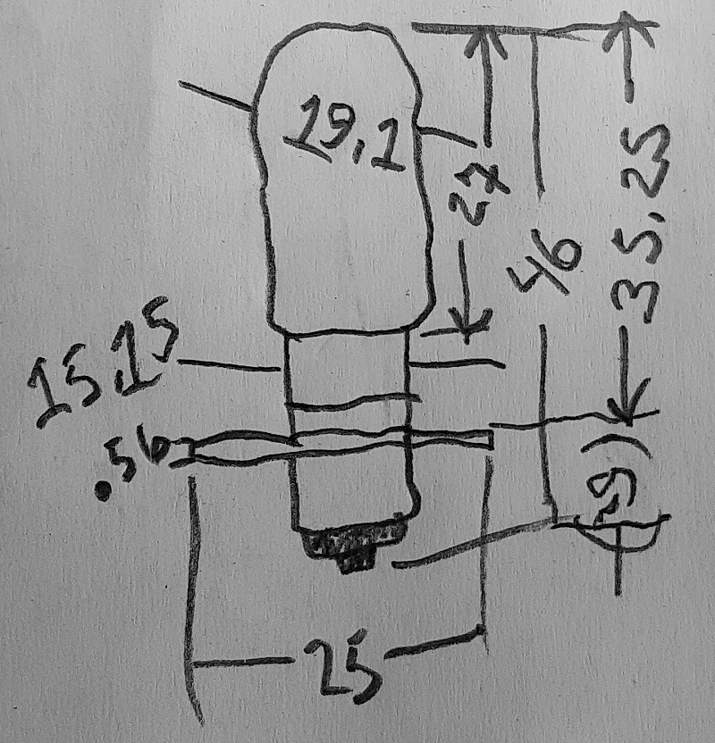

The Stanley bulb dims for the glass diameter is 19mm. Yes, this will fit into the 20.1mm hole.
I used a digit caliper to take these measurements.

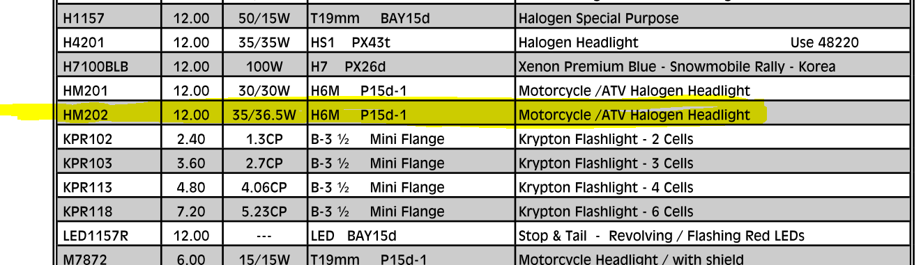

When I looked at the Japan ATV and motorcycle cross references from the 60s, 70s, 80s, no 4155 turns up as a replacement. In fact, the 4155 designation is not assigned to any bulb in the mobile 12VDC industry. Fredricks, Hoye and Southern just use this generic 4155 number as an inventory item, not a bulb size classification.

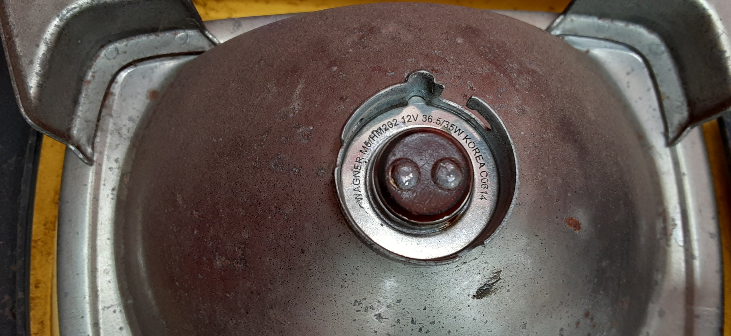

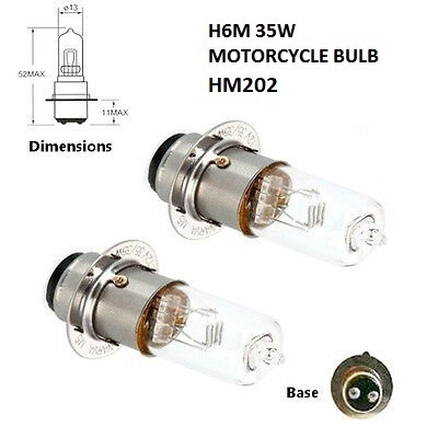

And we now arrive at the modern halogen replacement.
How does the HM202 35W halogens fit in the Stanley headlamp assembly? P E R F E C T L Y. :love:
You can keep the old incandescent bulbs and have dim light using the 4155 stocking number that fits the hole. There is no trace back reference on the Fredricks site to who the bulb manufacture really is. Its just a basic generic.
I'll have 2X the distance and illumination using the halogens.
