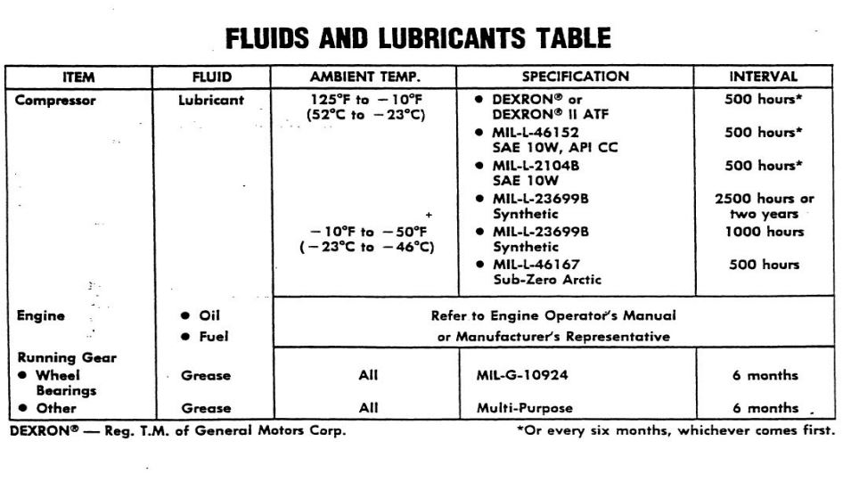

Found a buddy who works for a local oil supplier and ended up with a 5 gal bucket of 10W motor oil with the right API rating delivered to my shop for $36. Not bad.
Thanks to everyone for their help.

Hey guys, I'm changing the compressor oil in my Ingersol-Rand air compressor. The information tag on the door says use a MIL-L-46152 SAE 10W oil for the compressor. This is a 1980s vintage air compressor so I think this specification is obsolete. Anyway, it looks like transmission fluid and probably is, but I know there are different types. I'm going to make a run into town tomorrow to look for a 5 gallon bucket. If anyone knows of a current spec to look for, please let me know. Thanks.
This compressor uses dexron iii. Replaces dexron ii
Transmission fluid.
Go to 301 Moved Permanently and under mamuals there isa manual for this comressor.
Good luck
   / Replacement oil for MIL-L-46152 #17
Actually this particular spec was cancelled on 31 Oct 91 and the cancellation letter said to use the CID (Commercial Item Designation) spec A-A-52039 which was Automotive engine oil API spec SG.
If you came to me asking for this, we would give you Rotella 10wt in a commercial designation or I would give you Mil-PRF-2104 10wt in a MIL-spec Oil as we stock for Tactical vehicles.
Most compressors are not very fussy as to what they run though.
