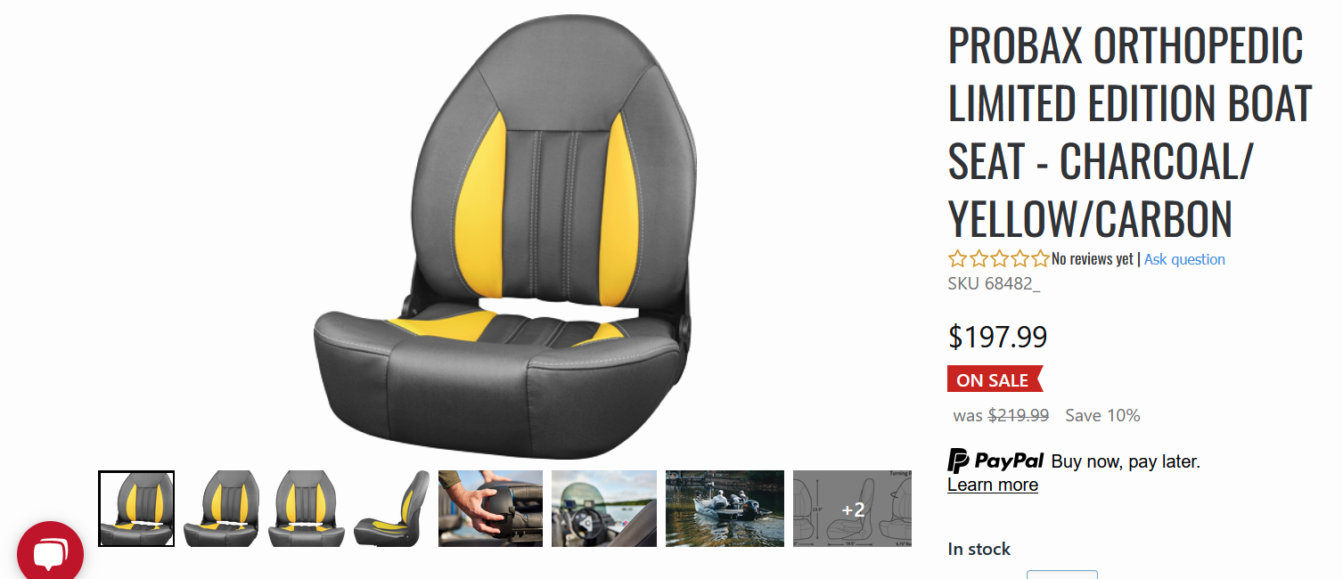

There was a post on this subject about using a replacement seat for a fishing boat. Since they live outdoors in the sun and last for years and are cheaper then tractor seats. Just had to find the style that had the same bolt pattern. Thought I saw on a post about Kubota seats, just couldn't find it.

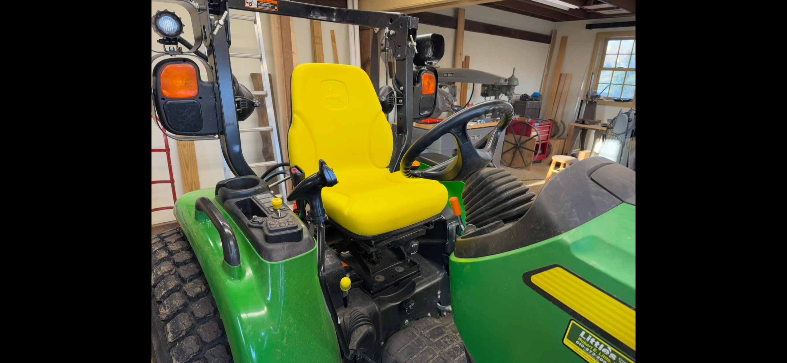

Damn new seat is almost too bright and clean for the tractor it’s on!
Credit to @DarkBlack for the screen shot method.
I think I’ll find an OEM cover to go on this one. Just gotta figure out how to get the right cover for this seat, since it’s a higher back than the common garden tractor seat.

That looks fantastic. After comparing side by side, would you say it is a duplicate of the original?
The shell is 100% identical, as is the molding of the seat. But the finish on the vinyl, or whatever that material is, seems to be different. The one that came off the tractor was a more shiny glazed vinyl, and this new one seems to be more matte finish. I haven't been able to decide if they started life the same, and the old one has just become burnished by weather and my butt, or if the materials are actually a little different.
I also notice that where the covering material is tucked in the corners, the old one is smooth where the new one has "folds", making me think the covering material is indeed slightly different.
I can't remember if you posted the specific brand listing off amazon, but if you could identify it some way in this thread for future reference it would probably be appreciated by some down the road who needs to buy one.
Brand was OEM Deere, just a different part number. The seat I bought was Deere LVA12909 from Green Parts Store, for $326. The Deere Parts Catalog calls out LVA23751 for $940.
As stated, shell is identical, mounting patterns identical, even foam and coping are identical, but the vinyl covering may be slightly different... I'm honestly not even 100% sure of that. All I can say is that I'm real happy I didn't spend $940.
