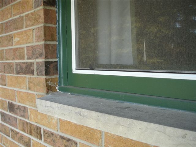

My wife would like the windows in my 35 yr old ranch replaced. Yes, they are old, but are still in a very good shape. No rotten frames, single pane with outer storms with good glass and screens.

No need to patch the brick. If its an older aluminum window in a brick home, we remove the strips around the glass, take a heat gun (a really good blow dryer will work) heat the seal around the glass, push the the glass out, and collapse the aluminum frames inward off their nailing flanges. If your window guy measured right, the new window will fit snug up to the brick. Caulk the exterior, Most better replacement windows have a built in adjustable trim on the inside that moves to fit the interior case opening. some caulk and your done. The keys to a good job are getting REPLACEMENT windows, not in stock new construction windows, and get good measurements.

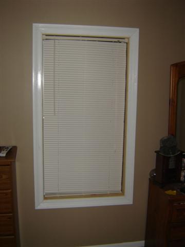

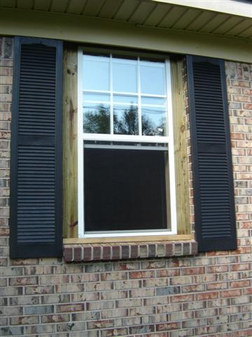

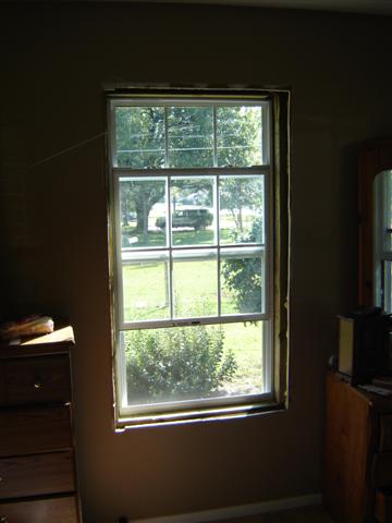

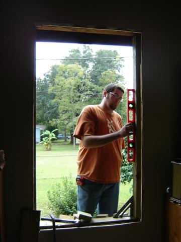

Here are some pictures of the windows that are going to be replaced (per the BOSS :D ).
I appreciate all the help.
