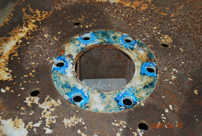

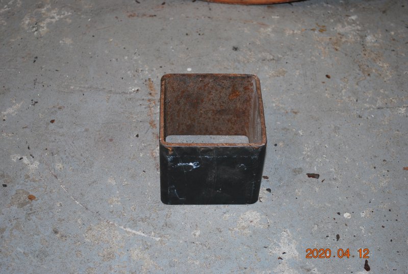

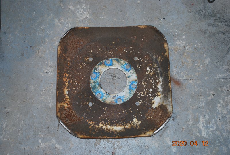

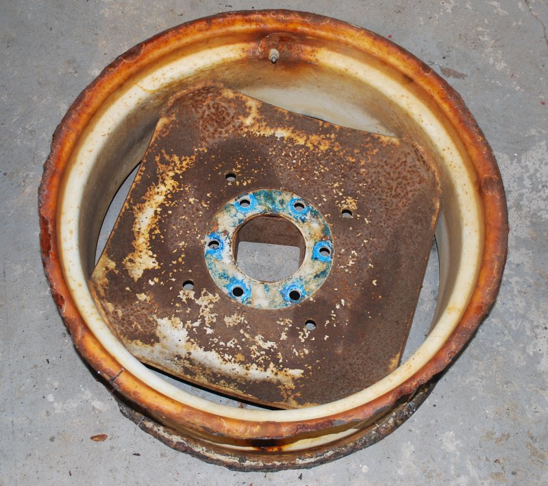

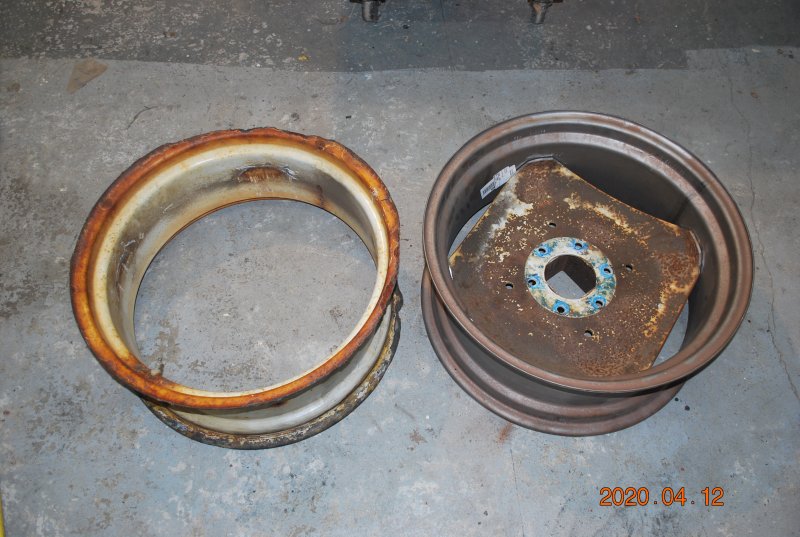

The 1715 rear wheel/tire replacement project is under way. Pics below show how I am cutting the center out of the old wheel and welding it to the new rim.
1. Drill a hole in the old tire and drain the fill (valve stem rusted shut), not much was in it, most had leaked out.
2. Cut the tire off with a sawzall
3. Bring the old wheel in, lay it on the shop floor and measure from the floor to the bottom of the hub, then cut a metal spacer to those measurements.
4. Cut the old hub center out of the old wheel, I used an air cutoff tool
5. Test fit the old center in the new wheel using the previous made spacer to position it for the correct offset.
That's as far as I have gotten.
6. Sand blast the old center
7. Weld to the new rim
8. Paint
9. Mount the tire and fill
Got a this new tire delivered to my door for $213 ... not sure why it went up in one week: https://www.amazon.com/gp/product/B011O2C2NU/ref=ppx_yo_dt_b_asin_title_o00_s00?ie=UTF8&psc=1
$60 cheaper than the next nearest price and I didn't have to pick it up at the freight office one hour away. Rim was about $130. Plan on mounting it myself ... did a quick test with the new rim and it seems doable by hand (and large pry bars).
About two hours from getting the tractor up to getting the center cut out. Beats $600 for a new wheel assembly from New Holland.

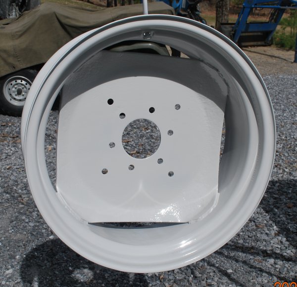

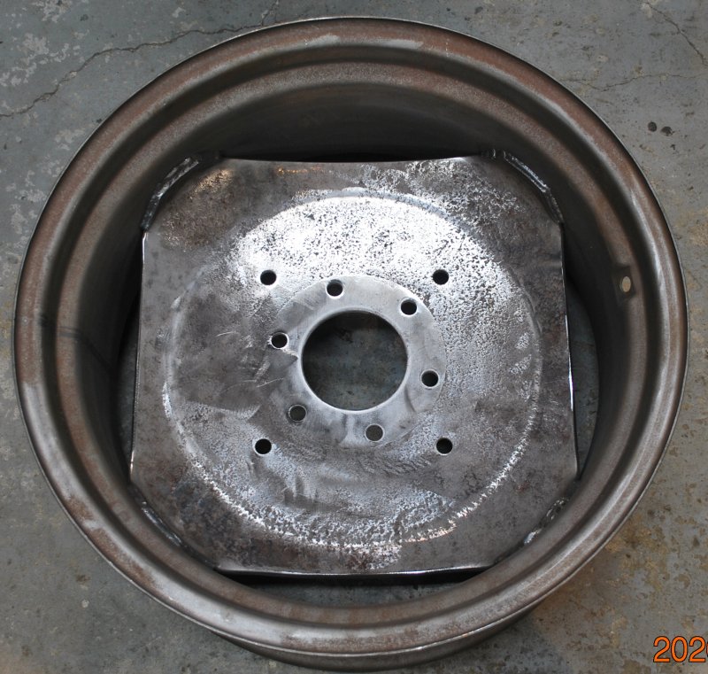

Here's the rim welded up to the old center section, almost ready for paint.
   / Replacing a 1715 rear rim
#16
Wheel finished .... paint will have to harden for a few days before I try to mount the tire.
attachment.php
