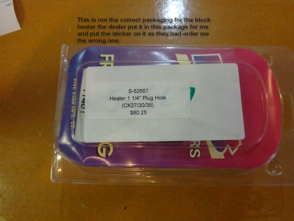

Sorry for the way the pics. loaded I should have done it individually. I first installed the sleeve because I could I could see no way to safely install it without possibly harming the heater & used that long brass punch to do so. One thing I would do next time is mark the heater so the pins are horizontal to the motor. There is no top and bottom the wire plugs in either way but with them being horizontal the plug on the wire could be installed with the wire straight down. Not critical but neater and less kinks. With dope on the threads there's no need to over tighten but let it set over night before firing up this will allow the sealer to set and insure no leaks. I realize I'm not great at explaining so just ask and I'll do my best with any questions.
Could you post part numbers and sources, please?
/ Replacing Block Heater #14
This is the only thing I have to indicate part nos. but I seen more info on other posts with the correct plug and heater nos.
I think this here is the correct one but don't have a no. for the plug.
Amazon.com: Kat's 1149 4 Watt 3/4" NPT Frost Plug Heater: Automotive
