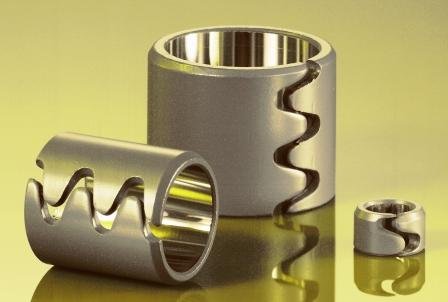

Where I used work the 3 weld bead method worked about 99% of the time and
we switched to liquid nitrogen for installation of solid bushing steel and bronze.
We also used a lot of these for replacements:
Spring bushings, spring pins - Connex Inc
