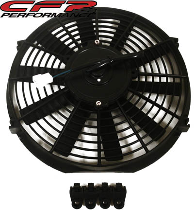

I thought the same thing and I am with you 100% - the lower volume might also help not "cook" the sap driving it (me) also. I don't have any experience with electric automotive fans, anyone know if they will run backwards? Many of them say "Reversible" but I don't know whether they are talking electrically or how they are physically mounted.
   / Replacing BX fan w/electric fan
#15
BTW- This is the type of fan I was looking at and here is the description .... It does say reversible motor so if everything else checks out space wise, I am encouraged to move forward.
10 inch high performance universal electric radiator cooling fan. The fan is 10pcs flat blade type. The motor is reversible and the fan is 12Volt 2407RPM and 775CFM. Four point mounting bracket kit. Dimensions 11 1/4 "x 10 5/8" x 2 1/2" This fan is high torque motor features sealed ball bearings and fully balanced blades which insure low noise levels and a long life of smooth operation.

Technically a neat idea, and that fan looks like it might work. My concern is exhaust and other engine compartment fumes. You would have to run the exhaust far enough back to not be drawn in with the cooling air. And, any gasket/seal leaks on a hot engine could create fumes. I'm guessing you want to avoid the hassle of a heater core. How about some form of electric heat?
