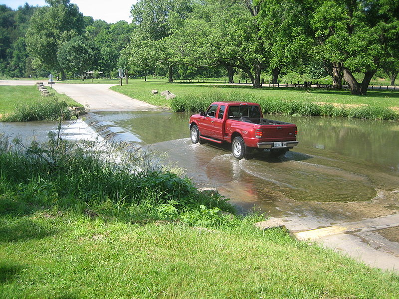

I like fords. A 14 foot wide ford 6 inches deep will be about the same volume of water as a 36 inch culvert. It doesn't get plugged, or wash away in a storm.
Small version:
Larger version:
297506d1358040636-bridge-questions-800px-ogle_county_il_white_pines_state_park_fords3.jpg
Bruce
