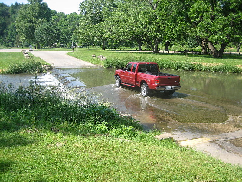

A crossing like that may not be legal here.
Yeah, it's nice but the DEP would probably consider it a fish blocker. They are replacing culverts that don't allow the movement of spawning fish, or traps hatch-lings into a particular portion of a stream.
I don't know if it applies to the OP's case, but the DEP has been using big diameter "U" culverts and embedding the lower portion into the stream bed. The goal is to maintain an approximate natural stream channel bottom.
Most of the streams around me have very rocky bottoms, the water has cut down to the ledge (bedrock). Stowe, VT is probably similar. That does limit the choices.
