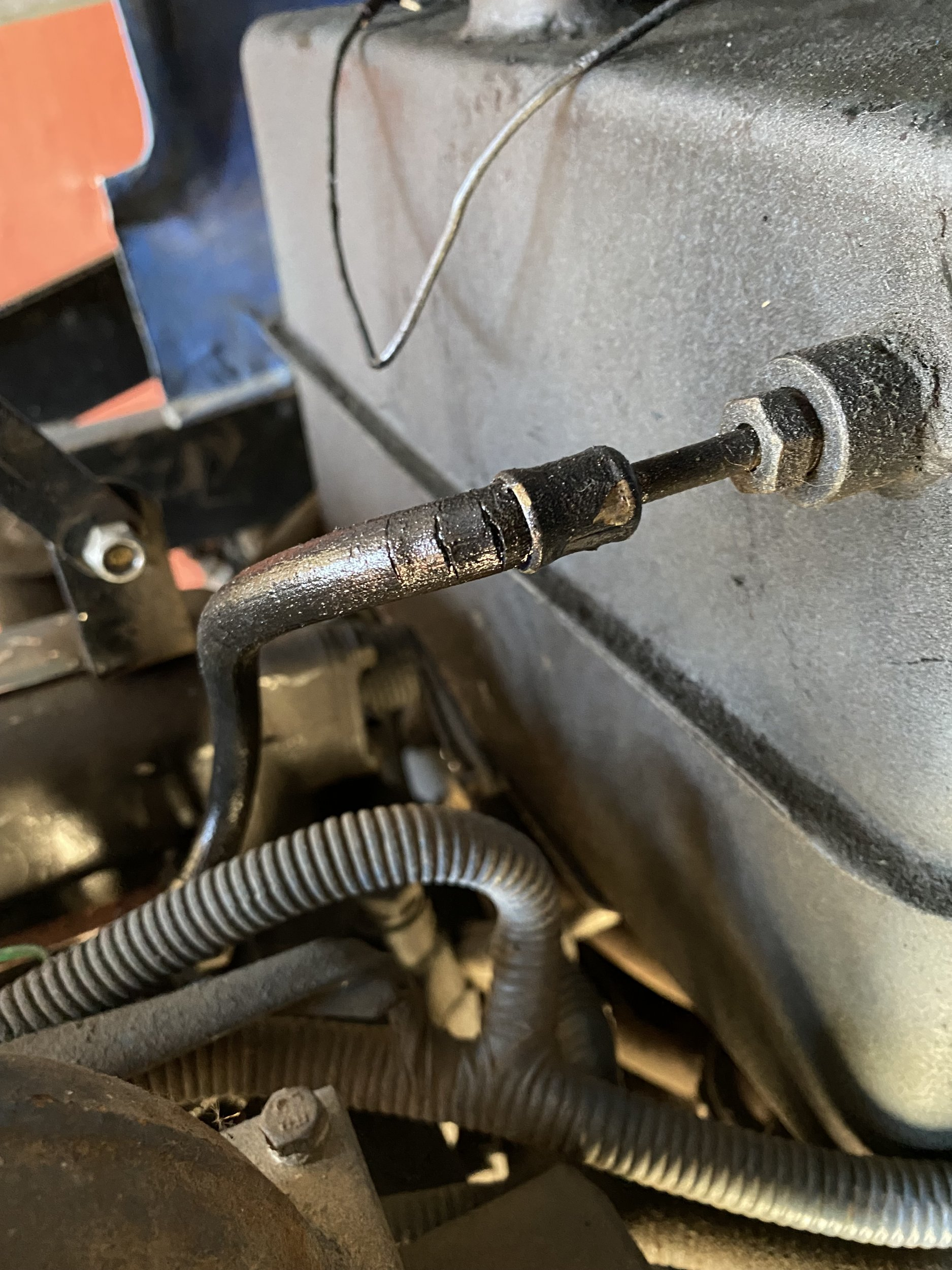

Can anyone advise how to go about replacing this fuel line on a Jinma 284? I'm not too mechanically inclined so I could benefit from pretty explicit feedback!
Thanks in advance

Use same diameter brake line? Remove your line and take to auto parts store to match up length? If you don't have tubing cutter and flaring tools some stores will shape and finish a line for you?
   / Replacing fuel line? #3
remove it, an auto parts store can sell you all the needed parts
Thanks in advance
I'm not familiar with Jinma, but I'm guessing you cannot simply order one from them or you would do that....
One problem I have with changing what you have is we we don't know what that connection to the fuel tank really looks like. We know what it resembles....from what we can see it looks like it is probably an inverted flare nut holding a flared connection to the fuel tank. That wouldn't be simple if it were a standard US imperial standard thread, and is complicated because what you have is probably to some metric standard. Or even to a manufacturer's own standard.
There are several different threads and types of flare that it could be. It could be a compression collar or a formed flare. It can be a single or double flare. For a flare to work, it has to be exact, surgically clean, symmetrical, and it has to match the existing flare in the fuel tank exactly. Add to that the probability that it is made to a metric flare standard and now it is unlikely to be a flare you will automatically find at your local auto parts store. There there are many flares and flare threads, all different....and we don't know which one you have.
If you have a local hydraulic shop, you might take that photo you posted to them and see if they have an idea. But if they do, they will want the old fuel line in hand before they do anything.
I've got a simple idea that might work. It involves hoping that both ends of the fuel line are identical, and if so then we keep the existing flare and metal tube on both ends, but replace that poor quality central rubber portion. Removing the old rubber and then sliding a better quality rubber or silicone fuel line over the metal tube and securing the replacement with a pair of small hose clamps on each end. For this to have any chance of working, the other end where the fuel line screws into the fuel filter needs to look pretty close to being like the end in your photo.
So since you said you wanted explicit feedback, step 1 is to take a picture of the other end of the fuel line and post it here.
While you are doing that photo take notice if the fuel line gets exposed to a engine heat in normal operation, how long it is, and approximently how far the other end is below the tank end. (Vertical distance).
BTW, we are concerned about vertical distance because the fuel line should always be decending as it travels between the fuel tank and the fuel filter. Otherwise it can trap an air bubble and shut off the flow.
Good luck,
rScotty

Agree with rScotty..... Just cut off and replace cracked rubber portion if both ends have enough steel tube to clamp to...And for clamps use quality Fuel Injection style, lot better than "worm" style clamps...

And just to clarify, the new rubber portion will have to be a larger diameter if we're intending it to go OVER the top of the existing tube, correct? In other words, the rubber line will now serve as the "female" and the metal tube will become the "male" ... am I following correctly?

Sounds stupid I guess but it looks easy. I'd have an extinguisher at hand and rubber plugs ready once removed to plug hole.
Then line off should be easy to match size...as mentioned a steel line should work fine, (tubing) bent to fit.
Yes, that's the way I see it. The fuel line would slip over the metal tube. It might require cutting the metal tube. If so, I'd say to use a tubing cutter or very fine tooth jeweler's saw. You want to preserve the metal tubes.
So next is what kind of rubber fuel line to use. The rubber hose is not just to carry the fluid, it serves to isolate the rigid tank from the vibrating engine. There are a lot of types of rubber fuel lines in the market right now - and I don't have a clear feeling for which would stand up the best. For my own work I've been using some medium heavy rubber fuel line I got from a guy who services Honda Generators. It is holding up well, but I have no idea what it is made of. I'd say - guessing - that what I'm using has less wall thickness than what I see in that photo in message #1. Just get good quality fuel line and inspect it is what I do.
On clamps, I usually use two per end & confess to using worm drive clamps all too often.
The world of clamps is divided into those that follow the expansion and contraction of the rubber as it ages....and those that do not. Worm drive and most bolted types do not follow dimensional changes well. Spring clamps of the "constant tension" type do.
But really for low pressure gravity feed systems as long as the fuel line hose material remains elastic either type will do. It's when the fuel line gets old that you get leaks with them all.
