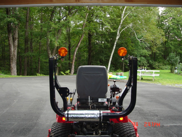

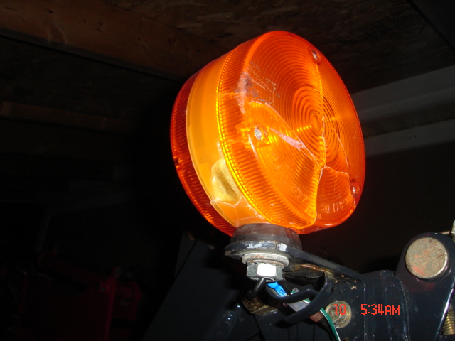

Lights area bit different on the newer ones, but I found that Kubota lights made for a much less expensive replacement for my OEM Massey ROPS lights.
I also had trouble nicking the darned things (and got tired of repairing/replacing them), so made some clamps to mount them on the inside of the ROPS. It doesn't hinder me when using backhoe, and I haven't had one issue with the lights ever since.:cool2:
I think a lot of the problem is that the lights are situated where you're NOT looking while using the tractor; that is, up and a bit behind the operator. Yes, maybe a "newbie" issue, but I bet I'd still be hitting them if I hadn't moved them!
Here's a bit of "after & before", also showing the Kubota light:

Irving,
Your "before " picture is a considerably different light than what is on the gc1700 series. It appears the gc2300 series tail lights were different.

I had no idea the TLB ROPS was so much wider than mine. Yours widens at your hinge but mine rises straight to the top.
