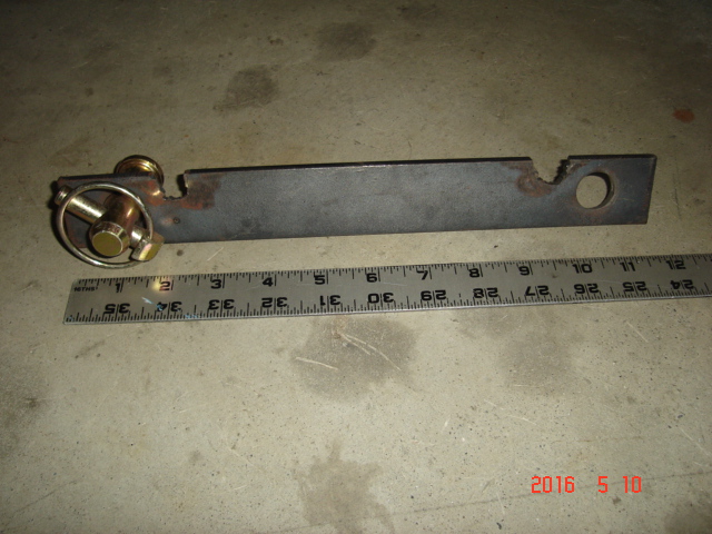

"Also the rops only has one position all the way down. Their is no 3/4 latch to stop it from folding in half."
Ookla-- here's what I made to hold my ROPS in a roughly half-way position; I found I couldn't use my 3PH tiller with the ROPS down, but as my garden is very small --and on level ground-- I prefer not to have the ROPS up. (Also keeps me from forgetting to put the $#@ thing back down before trying to back into the garage to remove the tiller!! :ashamed:)
I made two, using 3/16 steel bar stock, and purchased two additional pins to fit. They essentially extend the distance between the ROPS locking holes, holding the ROPS in an angled position-- just enough for the tiller to clear when it's raised. The notch I had to cut out is for clearance on the edge of the stationary portion of the ROPS.

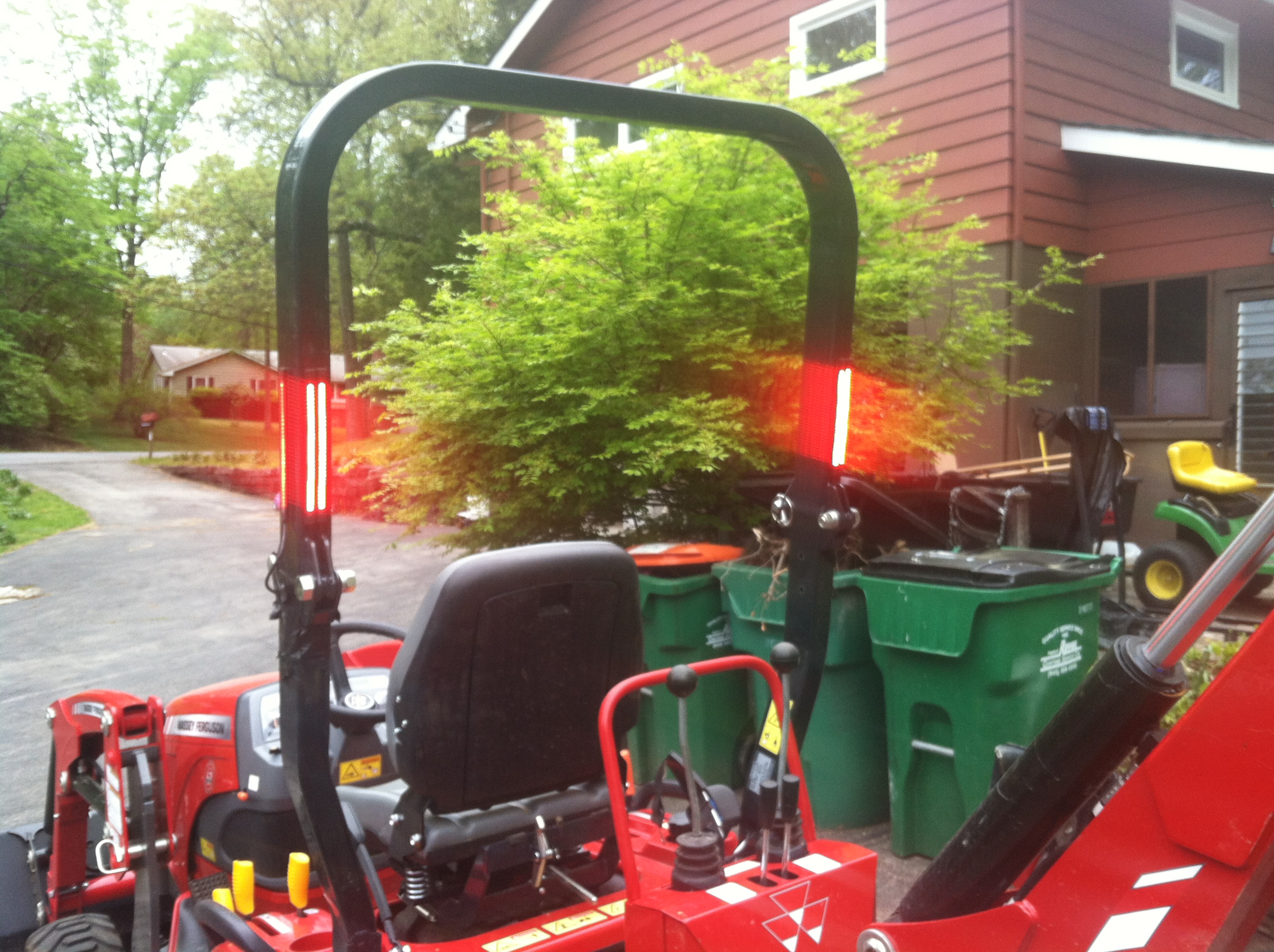

Just received my other side brake lights. Ill post up more oictures when i have everythig finished.

Finished both sides of lights. Really, really bright. If anyone needs help with the wiring just let me know. ,
Would you mind sharing where you ordered the lights, and how wiring and attaching works? I'm liking this idea a lot.
