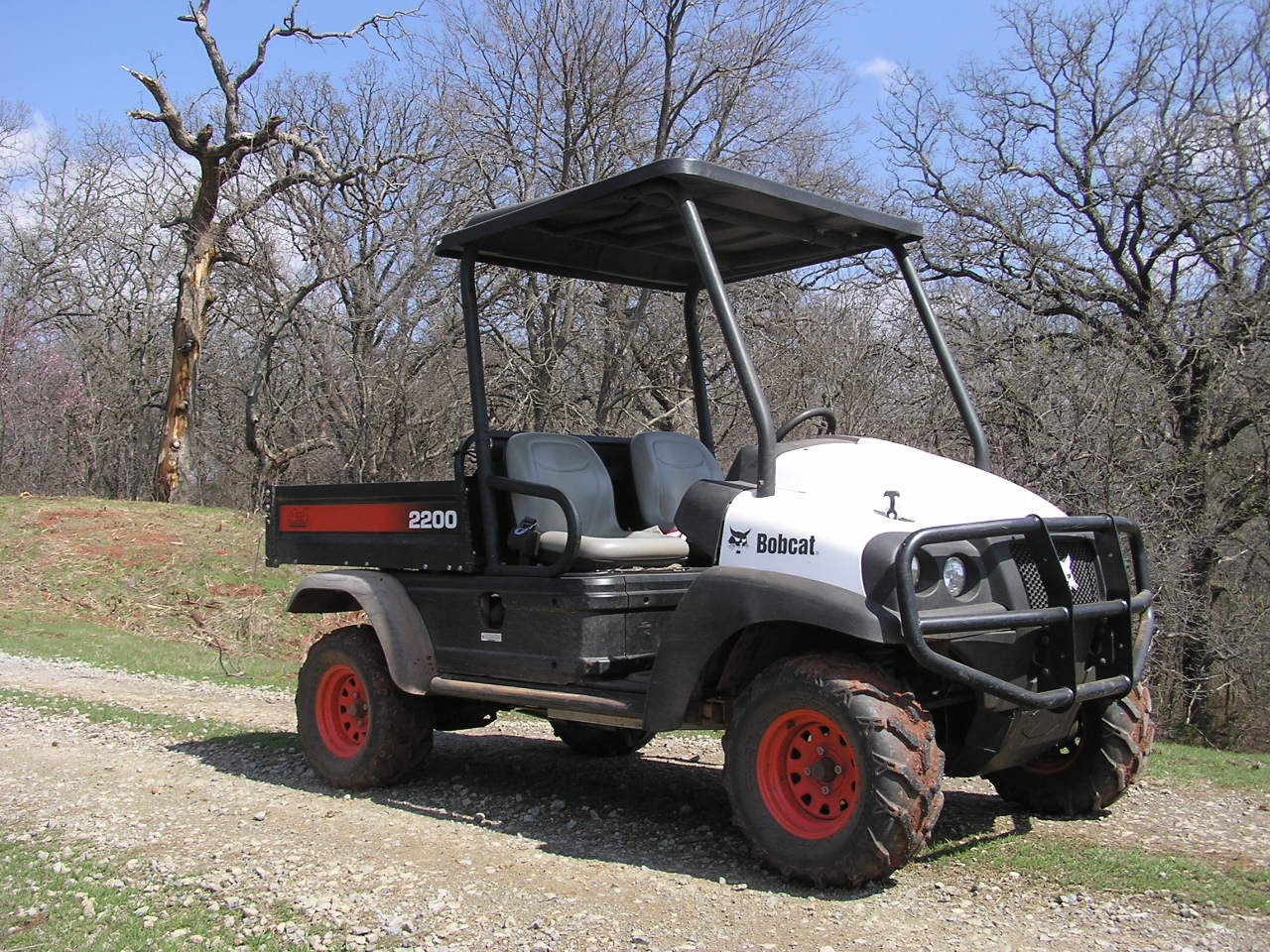

Been looking for 2 months, ready to purchase, wife says just bring home the one she will use. Only have 4 acres, but some relatively steep areas where cart slips and I end up getting the tractor to tug the cart. My wife will not go in steep areas due to traction loss of golf cart. I want to use for spraying and wife will use for planting, gardening and moving items around the property. My wife will use 3/4 time so ease of use is very important. ------------------
She's not interested to test driving, speed is very secondary, turf tires only. Thoughts before I make a 10K mistake.
This is the one that my wife liked the best for ease of use. Only one lever for forward, neutral, reverse. 4WD is automatic, it runs open differential, switches to 4WD if needed, and locks either or both differentials it if needed.

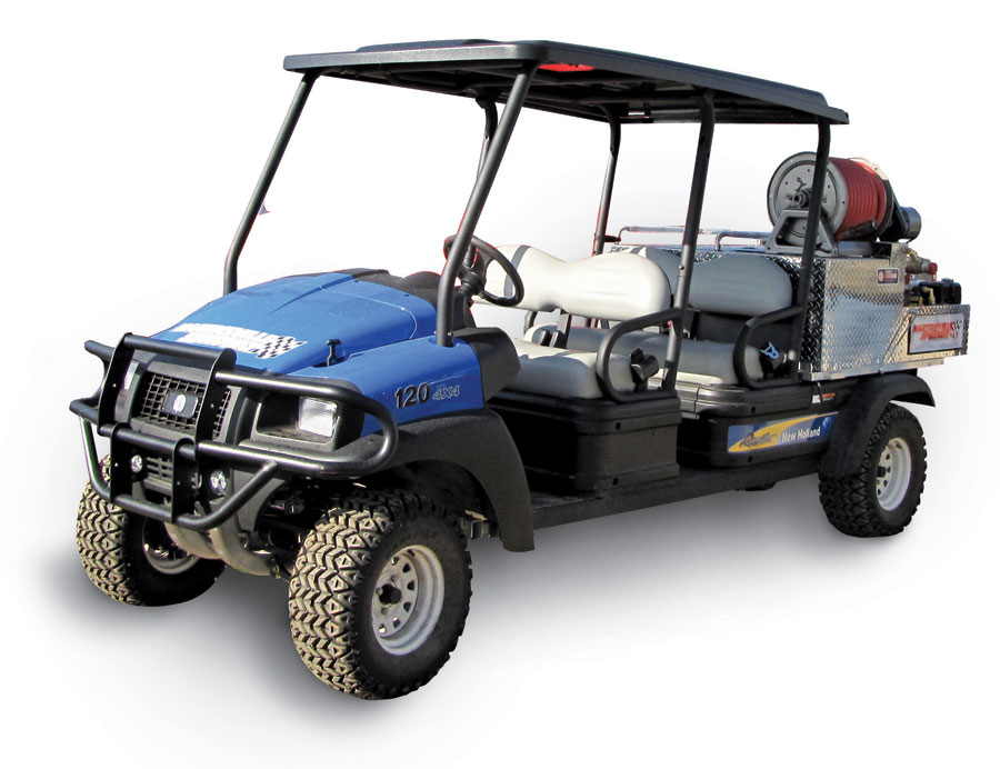

And if you like blue: Rustler™ utility vehicles - Overview | Utility Vehicles | New Holland (US) | NHAG

Xfaxman,
You started me looking at the Bobcat 2200 / Club Car XRT 1550. 3 questions..
1) How does the UTV manage going down steep slopes - specifically engine braking without Hydro Trans. 2) with the Kubota Diesel under the seat, is the noise level excessive - I know that is subjective question. 3) slow speed operation - spraying etc, smooth, not jerky? Like you might get with high HP gas UTV. 4) Thoughts - no separate hi / lo range - I would appreciate your thoughts.

Xfaxman,
No problem. ​It has engine braking through the CVT, just keep the RPMs up at the top, to keep the clutch engaged.
The 3 cylinder diesel was louder than the 2 cylinder gas engine. That was the main thing that my wife didn't like about it.
Very smooth and powerful.
It has plenty of low speed grunt and is fast enough for a "work" machine.
It was the only machine on the place that I never got stuck. My wife used it several times to pull me out when I tried to mow too close to the pond with the TORO.
Go drive one and let us know what you think.
Club Car made it for several other brands, just look for the aluminum frame.
Here is the New Holland Rustler:

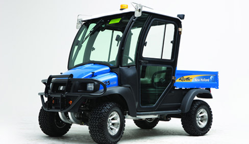

And the Husqvarna HUV 4421G
