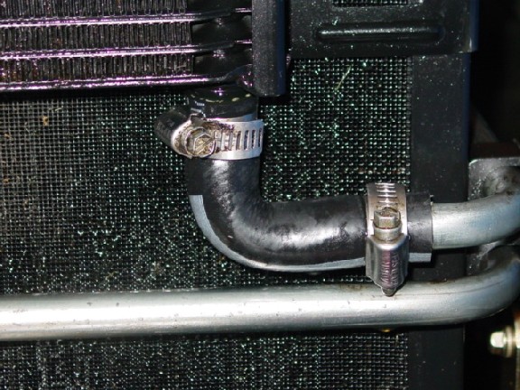

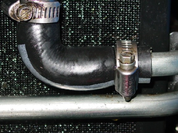

My hoses broke on my TC29D. The first one went and I lost a lot of fluid. Dealer did not have one in stock so we made one that was longer and then I just put a loop in it. Before the new ones came in the second one was leaking. When I put the new ones on I had a heck of a time getting them to not leak with the new hoses. You almost have to get the factory ones because of the bend. If you are just changing them just rig up a funnel of some kind to dirct the fluid away from your machine. Attached is a pic of mine after I changed the hoses. My new hoses expand an awful lot when running. I took it back in to my dealer and even though they expand my dealer said not worry about it. But I guess i am worried.
Pic with tractor off

Pic with tractor running

I put zip ties around the new hoses - 1 about every 1/4 inch.
This gives me a little more faith but I must agree that they sure swell up. Seems like a ticking time bomb. /forums/images/graemlins/frown.gif. My brother recommended a braided line but we could not find anything with the 90 degree bend.

This is an issue NH needs to address. The problem is either the hoses are too weak for the job, or the cooler and or cooler bypass valve will not flow enough oil, particularly in cold weather. I replaced a hose on a TC33 the other day (LH side, the line feeding the cooler) the replacement instantly distended just as badly as the hose I took off. I am interested in testing the pressure at the cooler bypass valve, and perhaps temporarily bypassing the cooler completely to see what the resulting pressure is in the curcuit. Clearly there is a problem here, and it may well not be the hose in question.
