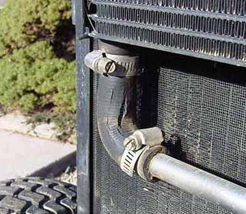

OK guys, here's my story . . .
Being the owner of a TC29D with 288 hrs., I inspected the hoses in question. Yep, just as you might expect, the hoses showed some small cracks upon initial inspection. Once the engine was running, yet still cold, the intake hose (left hose) swelled up enough to expose the hose braid. The right hose also has cracks, did not show the inner braid, but boy did it swell up! Which would lead me to believe that it is not high back pressure that is the problem here.
I took pictures of the hoses and off I went to my NH dealer. Neither the owner of service manager were aware of this problem, but took great interest in finding a solution. The service manager looked to see that they had sold ten (10) of the hoses in 2003. They contacted NH and spoke with them concerning this problem.
The service manager had discussed this with NH and came away with the following information. NH is aware of the problem. NH is not looking to change the Oil cooler for the Class II Boomers. It is suspected that the fabrication technique used in forming the 90 degree bends in the hoses has weakened the hose considerably. NH is working on a new hose for the Class II Boomers, but has no specific availability as of yet. NH also suggested that the dealer braise 90 degree fittings to the tubes, and then use straight pieces of hose for the connections.
This information is a little different than other information posted here, but I trust my dealer. they have always gone the extra mile for me when needed. At this point, my tractor usage is down to a minimum, so I am going to wait until late January to see what, if anything, the NH engineers have come up with. I'm not sure I like the idea of altering the tubes at this point.

The bend isn\'t the problem
Boomerboy said:
"Since the hoses would be straight sections, the integrety of the hose would be as the manufacturer provided, not compromised thru the molding/bending process that NH had specified to the third party manufacturer of the hose elbows."
Formed low pressure hose is not a new concept. The manufacturer is responsible for delivering a product that meets the design specification. The cause of these hose failures is not that they are 'bent' but that thay simply can't stand the operating pressure of the cooler circuit. Either because of excessive pressure or substandard hose manufacture. Brazed elbows will allow only a short hose which may well not absorb vibration enough to maintain the integrity of the cooler fittings themselves or the newly brazed joint. Good luck.
