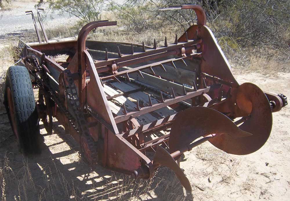

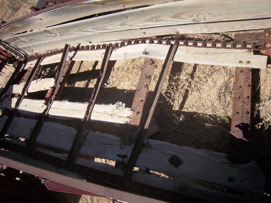

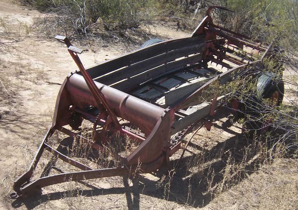

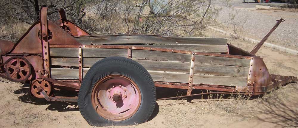

My spreader needs just a Little work. :laughing: Once your done with yours, :thumbsup: would you like to work on mine?? :D:D
You wheels are in better shape than what I started with. :laughing: The rest is a bit of a toss up. Mine has metal sides except for the very bottom. Not sure why there is one bottom wood rail on the sides. It looks like you have lost some structural integrity on the left side. I fear when I start tearing into mine that the rust might give way. Good luck with yours.
