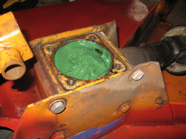

Dress up the shaft with emory cloth. Coat the shaft with anti seize when putting it back together. This helps the next time.

Here are a couple pics of the corn head grease in the gear box. I added 3 tubes, which just about filled it. The first pic is when I just added it, and the second is after running the mower for a few minutes. As you can tell, the box is pretty full! So far so good. :thumbsup:

   / Replacing seal in the bottom of a bushhog cutter #14
Cool. ... Too much grease. Probably wont hurt it tho. Just enuf to reach the highest bearing is good.
Theres the mysterious stuff i have heard about but not seen! Thanks for the pics, i to would say to much. Do you have a fill plug in that thing or a fill level hole where the oil should run out of it overfilled?
I just got off the phone and ordered my seal. Really it wasent that hard if you knew what to take apart, which i didnt at first. Well then there is the thing with the powerbar and if yours was put on with a 1" impact or not :laughing:.
If it happens again i will just replace the seal not go the grease route, as i will coat the shaft in antiseeze and just put the bolt on as tight as i can get it, there is no reason this thing has to be that tight it has a cotter pinned castle nut on it.

I figured if the case was full, there was no chance of forming an air pocket in a bad place. :D There is a small bleed valve in the fill plug, so pressure can escape if it should need to.
BTW, I also replaced the blades (mentioned in another thread) because the old ones had been sharpened a loooong way down. They were quite imbalanced too, like 1/4 inch difference in the front edge -- no, I didn't need a balance to tell me they were off! I suspect the difference in the blades led to the bad lower seal.
