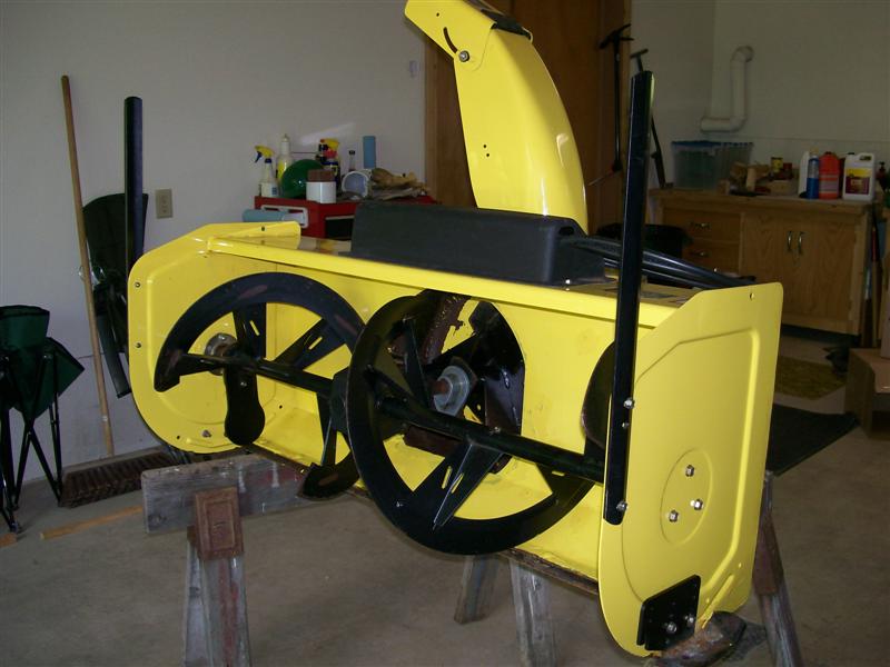

Here is the 47" snowblower I sold last summer. No chain drive. Will be interested in seeing pics of yours. edit....yes, there is a chain drive. Duh! Sorry, just took awhile.
Chain is on the other side.:D

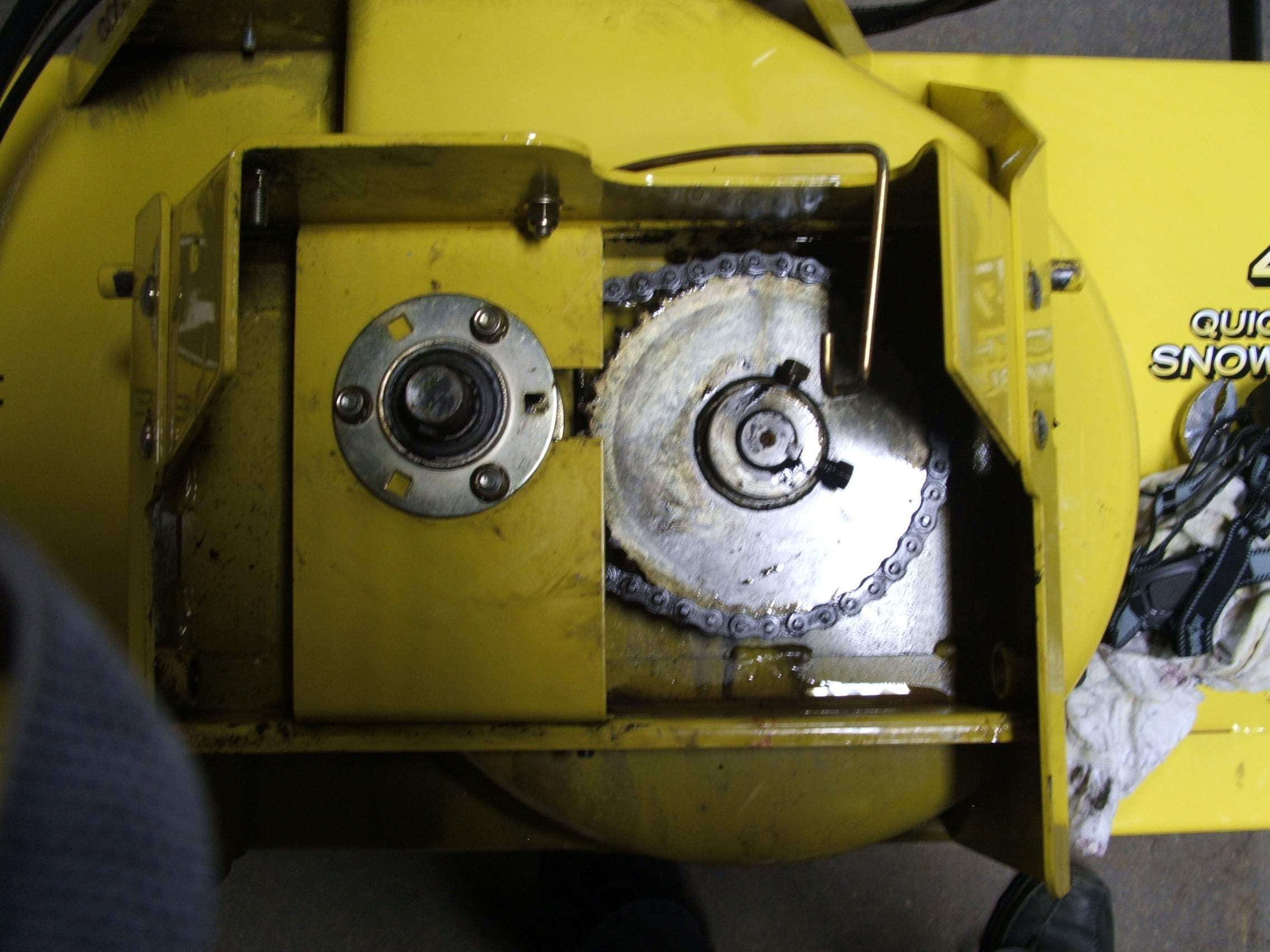

Few pictures.

Here is the other side. Is the chain hidden in there? There may be different 47" snowblowers. I found the same pic as you show in jdparts. Not sure how, but found it. :)
edit: yes, I found the chain drive and see where it is "hidden".
Good luck with the repair. That locking collar can be "some fun" and it is used by JD several places. Sorry for adding confusion to this. :(

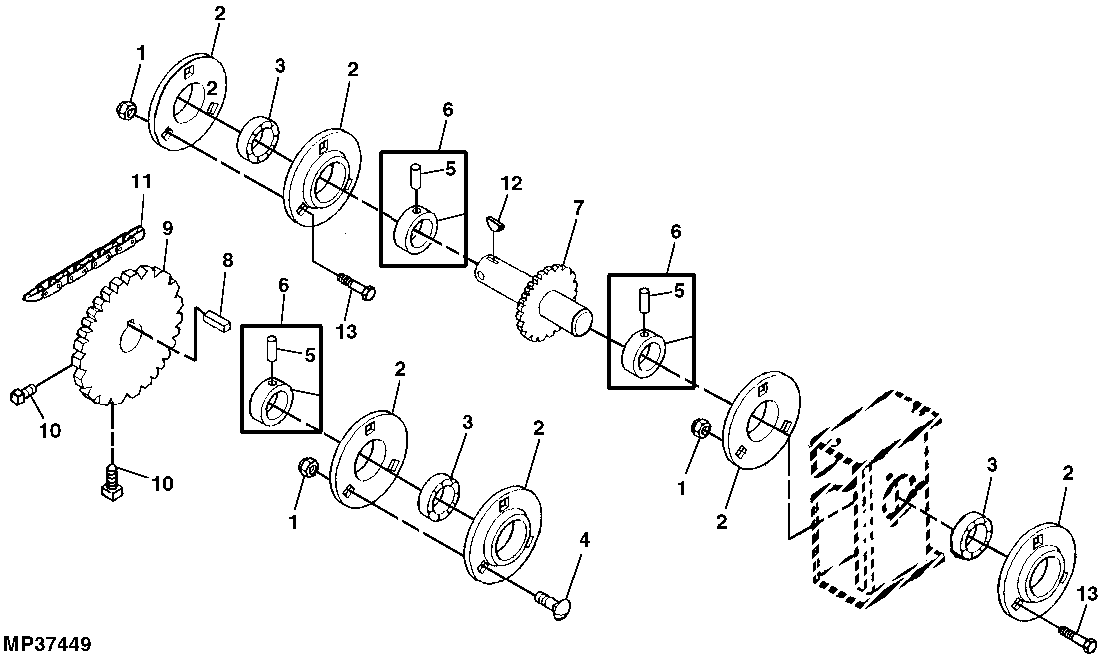

I tried to paste the picture, doesn't work. KENNY HELLLLLP
John Deere - Parts Catalog
Printer Friendly Page
Close Window
Catalog: 1926 | Grid: 2D7 | Section: 62 | Page: 4
Catalog Name: 47-Inch 2-Stage Snow Blower
Page Name: FRONT DRIVE
Direction of Travel:
You can't copy&paste...I right click the image, then save it to my desktop (so I can find it easliy), then attach the save image to the post;)

Few pictures.
From what I see, the key way slot in that sprocket is mangled and it needs replacing.
Shame as the teeth look OK.
Again you should be able to get a replacement sprocket from an industrial shop such as General Bearing in Canada (GBS).
Also Princess Auto carries replacements in their catalogue.
There should be an allen screw that locks the key in place and that screw was probably never correctly tightened. (use loctite or double screw)

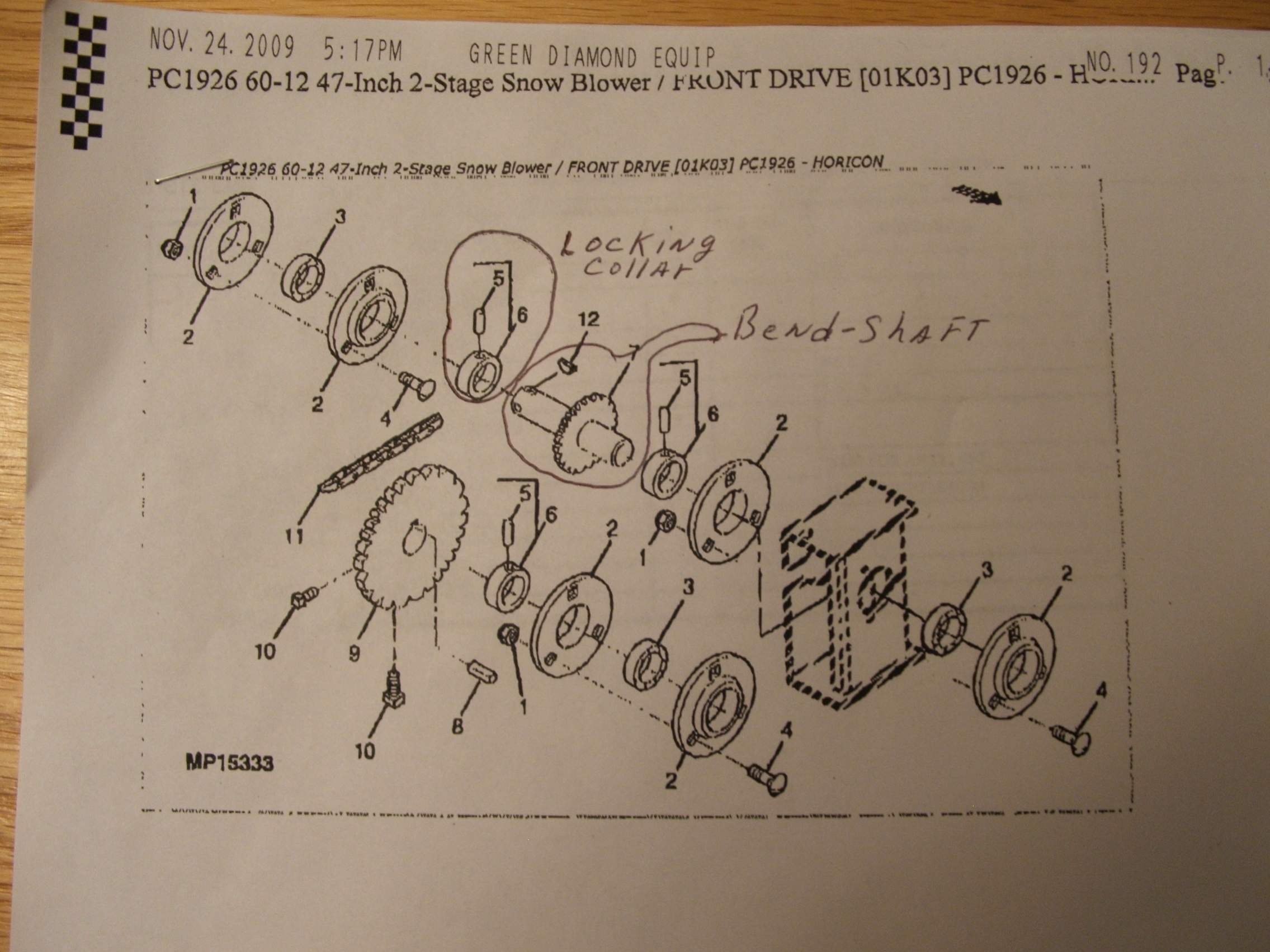

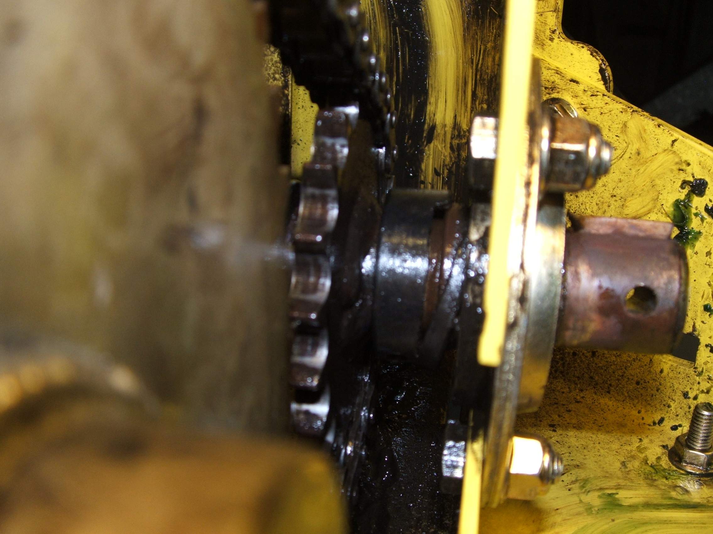

Sorry bellygunner, have the feeling that I stole your tread.:eek: There is some confusion probably cause by me, so I will try to clarified it with a french accent.;)
PILOON
PILOON, I have place these picture to help identified the parts and location for Beenthere and maybe help bellygunner at the same time. The pic. you see were taken last year. If you look closely in the second picture, you can see a broken lock collar. I had it fix last year on the warranty. They said it was cause by a bend sprocket shaft. They replace the shaft but now I notice that the larger sprocket is wobbling, so they want to have a look at it and determent if it was not damage last year by the old sprocket shaft.
