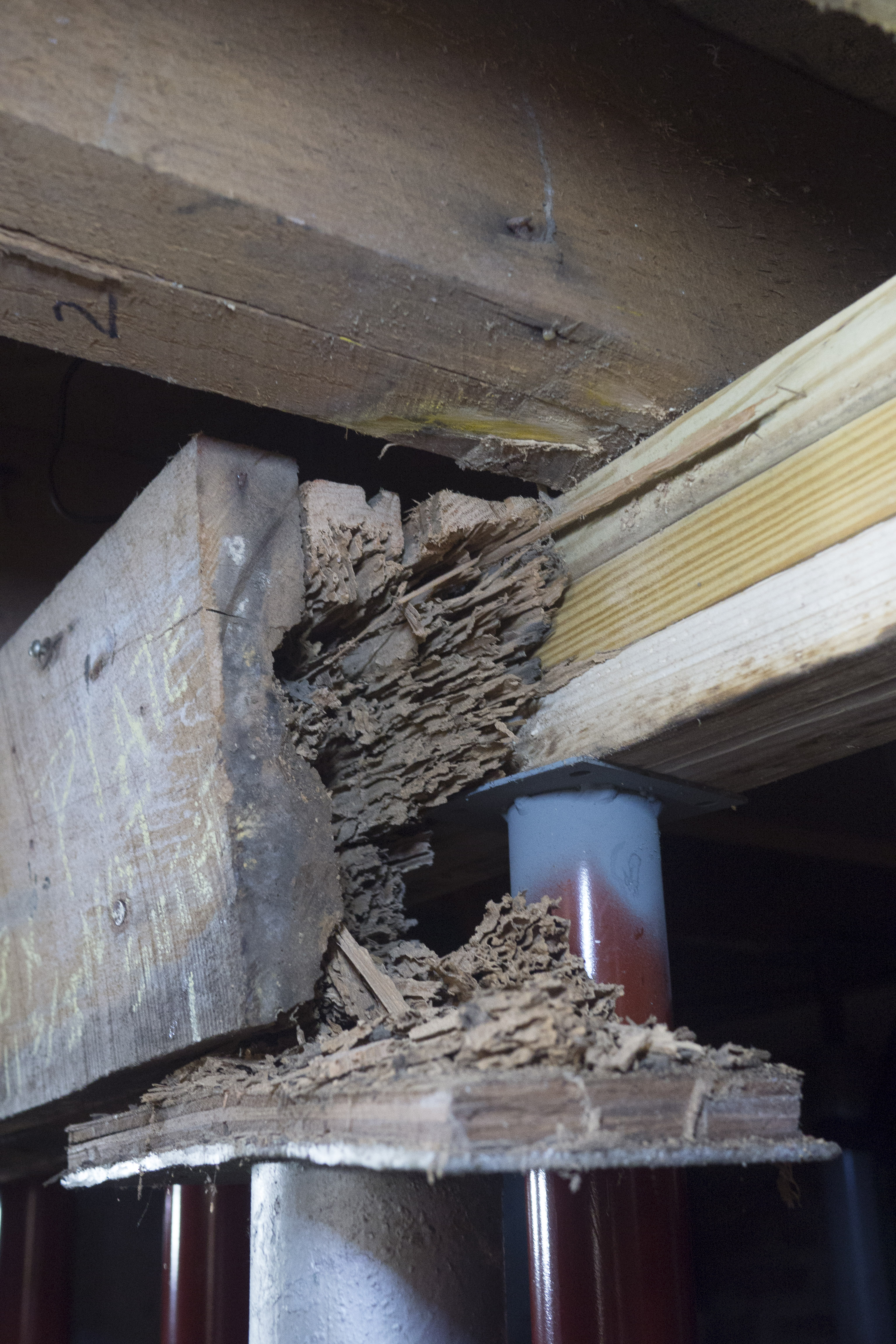

I'd like to reuse the existing columns. The present beam is dead center in the house with a stud wall above it. I'm sure the ceiling joists are overlapped in the ceiling on the stud wall.
The only way I see getting a 30' beam in there would be to support the existing floor joists, tear out the beam, make a hole in the exterior foundation and slide in a new beam. In theory, I could support the front of the beam with my FEL and the rear of the beam with my 3 point hitch, but in reality, I'm concerned that I'd knock the house down in the process.
It may just be that I will have to replace the existing beam section by section.
Although I started off thinking I would just build a stud wall, I'm not so sure but what I should use jacks instead because it would be so much easier to lower the house back onto the new beam. These would be really nice to have: Screw Jacks Lifting Support Jack House Floor Leveling Floor Support Sagging Floors Basement

If I understand correctly, the overall length of the beam is 30' with posts every 10'? And the existing beam is three 2x10's (1.5x9.25?) I'd just replace it with three 2x10's. The existing beam didn't fail because it was undersized, it was eaten away. I might go pressure-treated to avoid a repeat. Can you get a 20' piece in there? If so I'd just splice it over the posts, three 20-footers and three 10' footers, nail the whole thing together with 16d nails. If not I'd go with nine 10-footers, still splice over the posts, but put a 4' or so tie piece along the side of each splice.
You can't get 20-foot 2x10's at a big box store, but a real lumberyard should stock them. My Lowe's has them as a special order.
Since the joists overlap I would run a temporary beam parallel to the main beam and a few inches off, so you have room to work, and lift with jacks there. If we knew how long the joists were we could estimate the load on the beam, but my guess is you'd want to use 8' sections of 4x4 and put two jacks under each section. You'd need four sections, overlapped slightly, and eight jacks. I've used the Tiger jacks from Home Depot, they work fine for this. They're about $50 each so you'd be in for $400 for the job, and you could sell them on Craigslist when you're done.

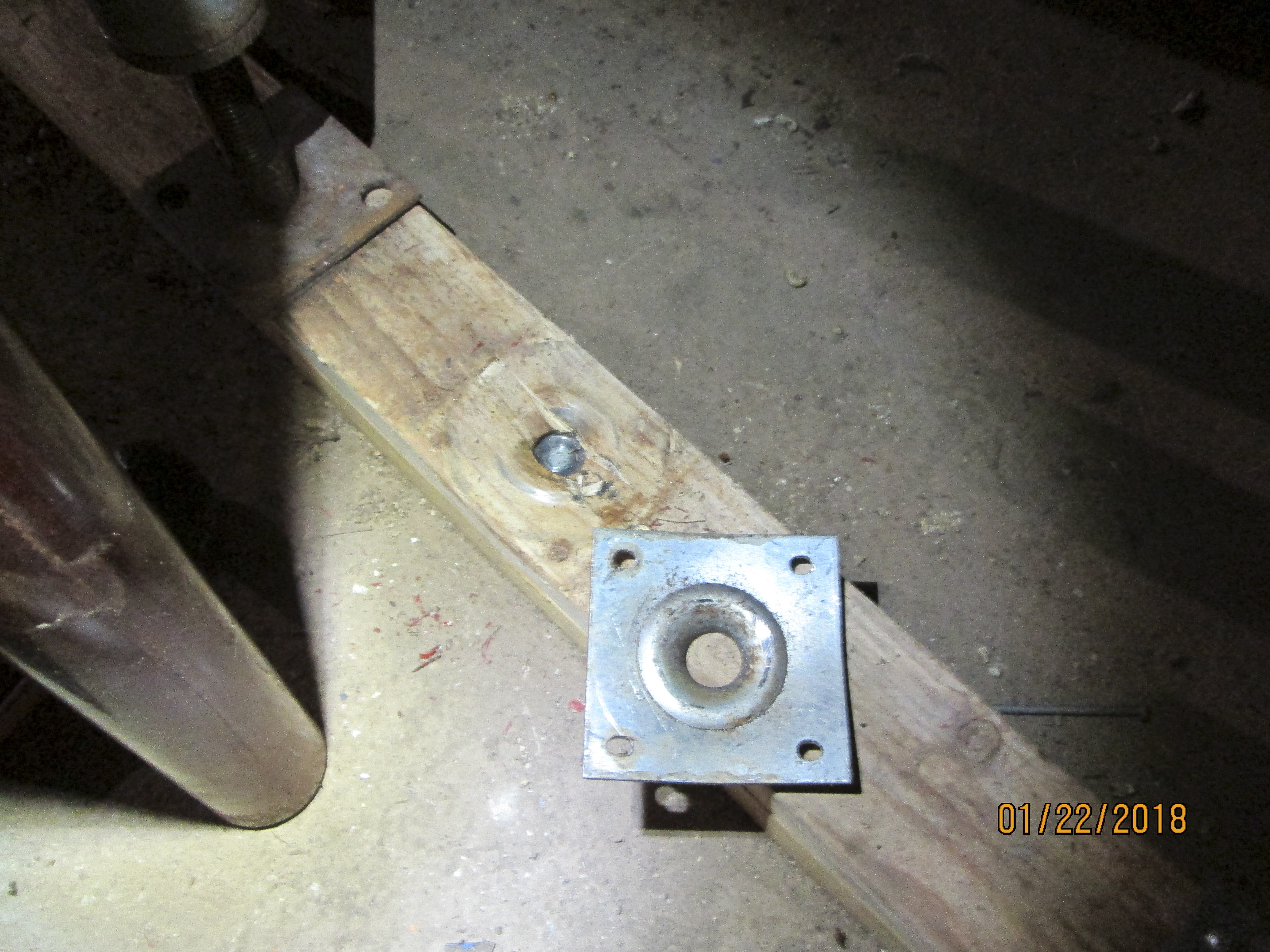

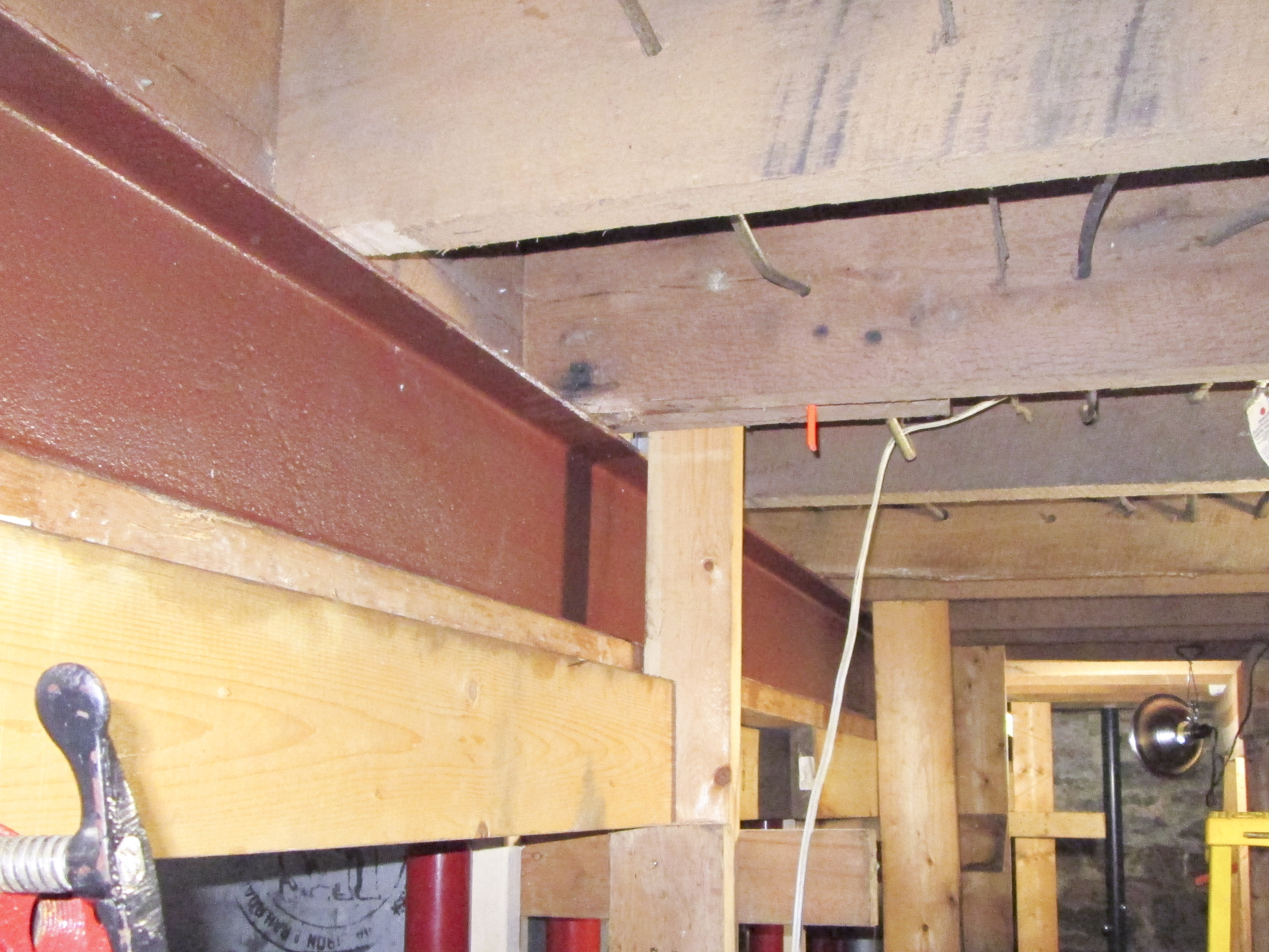

Here is a followup to my experience with this project.

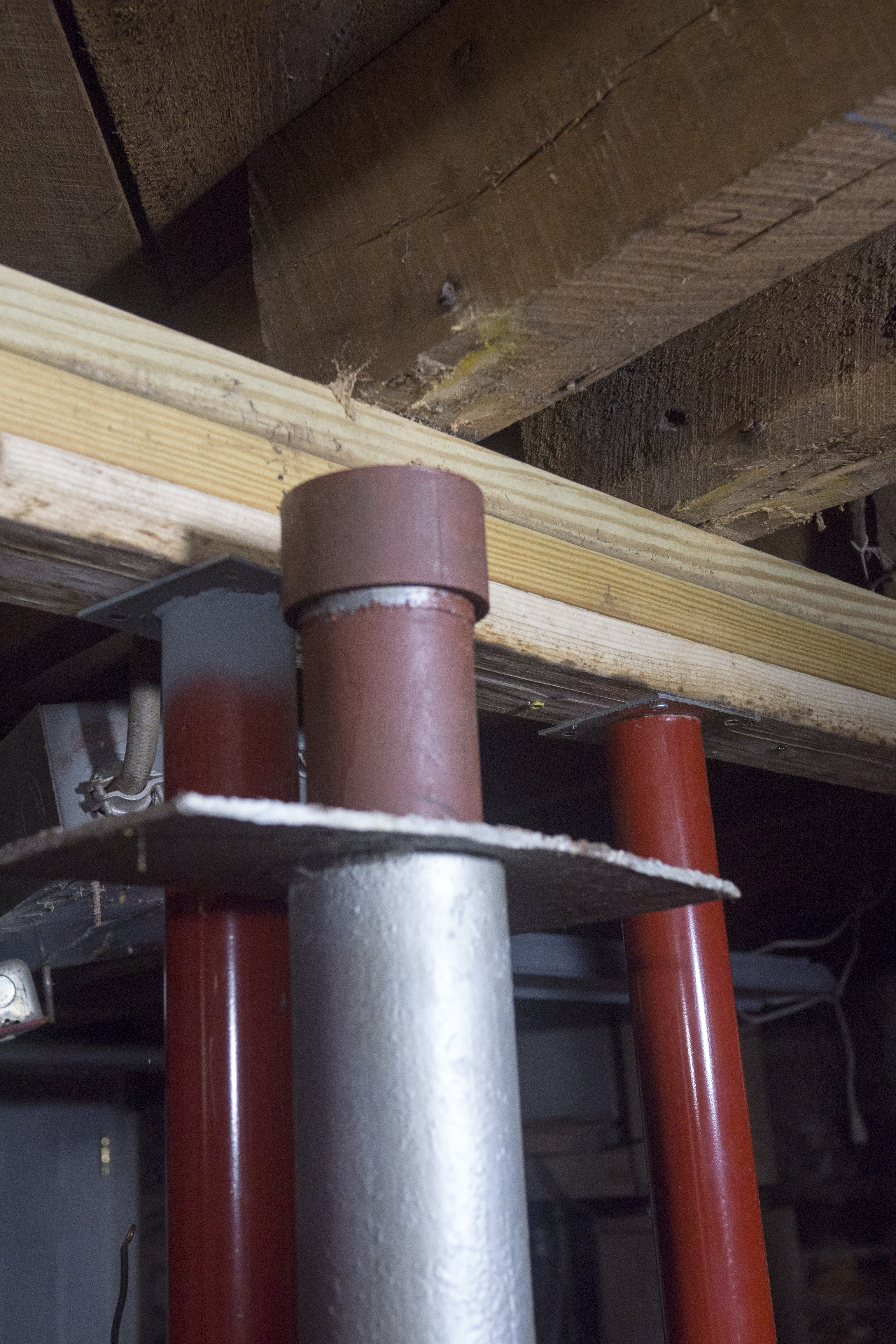

I decided to build a triple layer top plate under the joist tails and a double layer bottom plate with jack posts between them. Working alone, it was easier to manage 2x4s than larger dimension lumber. The jack posts were necessary to raise the house back up to level. I bought a Bosch laser level and then discovered that I had severely underestimated the amount of sag and had to extend the length of the jack posts in a couple of places. Because I was dealing with plaster walls that I did not want to crack, I raised the posts a little each week beginning in 2015, I think, until just recently.
I've seen a lot of internet posts asking how many jack posts are needed. I used 19 of them. Painful to buy, but I told myself that they were cheaper than the ER, hospital, funeral home and cemetery, not to mention having a caved in house.
During the process of raising one section, it just seemed that no matter how much I turned the jack, very little was happening. It turned out that the screw had punched a hole through the jack base. If I were to start this job anew, I'd probably buy some steel and fabricate my own top and bottom plates for these posts. I'd also use bolts instead of the rod that came with the jack posts, and I would grease the screws.
I am very, very grateful for the advice to weld the plate to the top and to weld the piece that holds the screw to the post. This was invaluable advice.

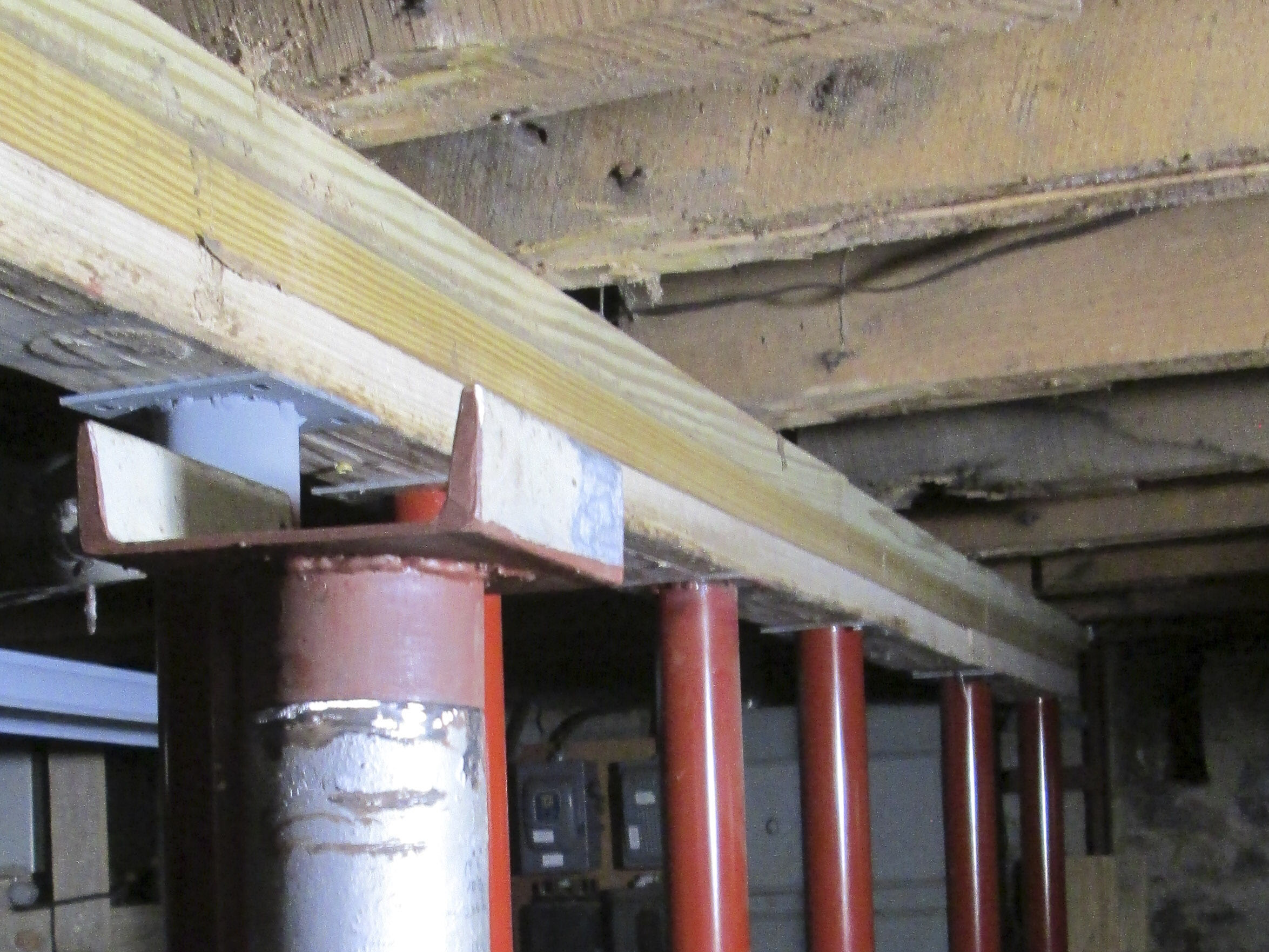

Although I bought pressure treated lumber to replace the beam, I was fortunate to find a used 8 inch I beam at the scrap yard. I was also fortunate that the grade of the yard was very close to the height were the beam needed to be installed in the house. So I built a support wall and slid the I beam in using a come along.
One problem was that the original support posts needed to be extended to make up for the 8 inch I beam going in place of the 9.25" lumber beam. The local tool and die shop cut a couple of extensions to which I welded an inner liner so the extension couldn't slide off the support post. I also added a section of C channel so the I beam couldn't slide off the extension.

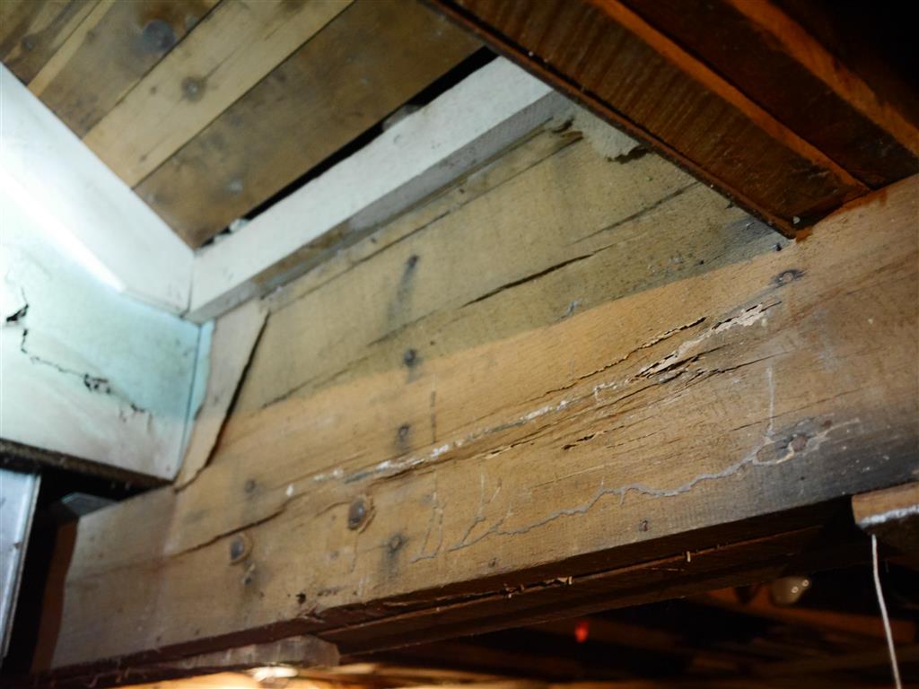

During the process of cutting out the old beam, it became apparent that the termite damage was worse than thought. The damage over one support column was so bad that only one of the pieces of lumber was supporting the house in that location. The lumber in the beam pockets was also shot.
At one point, I called a house mover to ask for a quote on this job and was quoted $5,000. It has been a time consuming and difficult project. I agree with Texasmark that one has to know their limits before trying something like this. For anyone considering something like this, I would say to not scrimp on jacks or support materials because your life is at stake.
