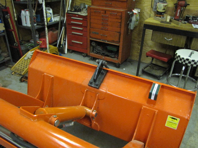

This is where and how I did mine. If you look real good you can see that it goes back to get into heavier metal and has a spacer welder to fill in. It also is shaped to fit the lip. I used plumbers putty to get the shape of the lip.

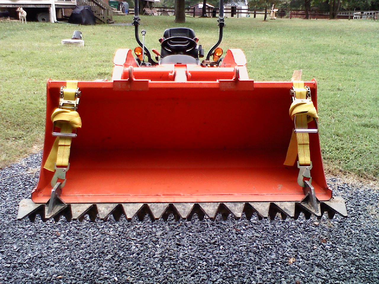

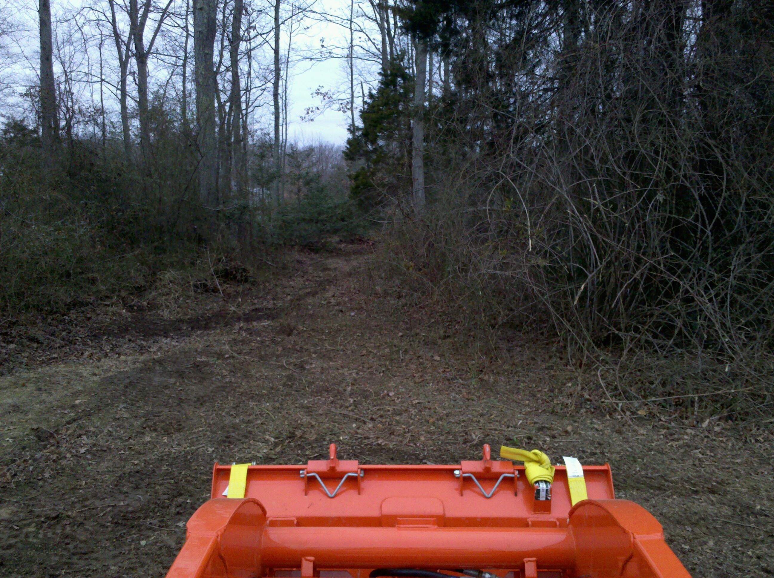

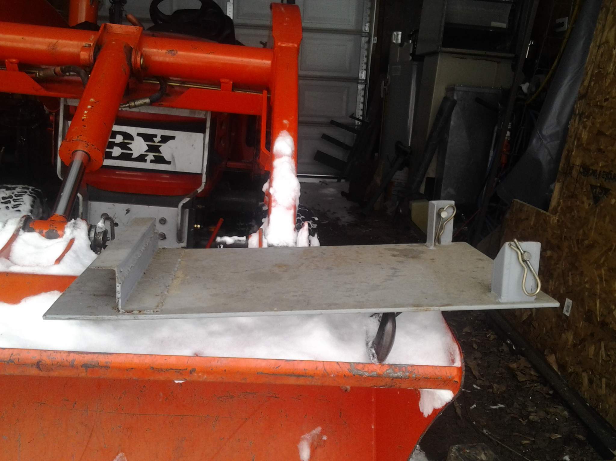

DRZDUDE - In my picture is another option for bucket hooks if you are interested. BXpanded sells them for our BX tractors and can be purchased at BXpanded. Best part about them is that they can be moved around or removed at any time.

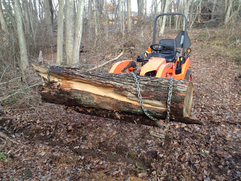

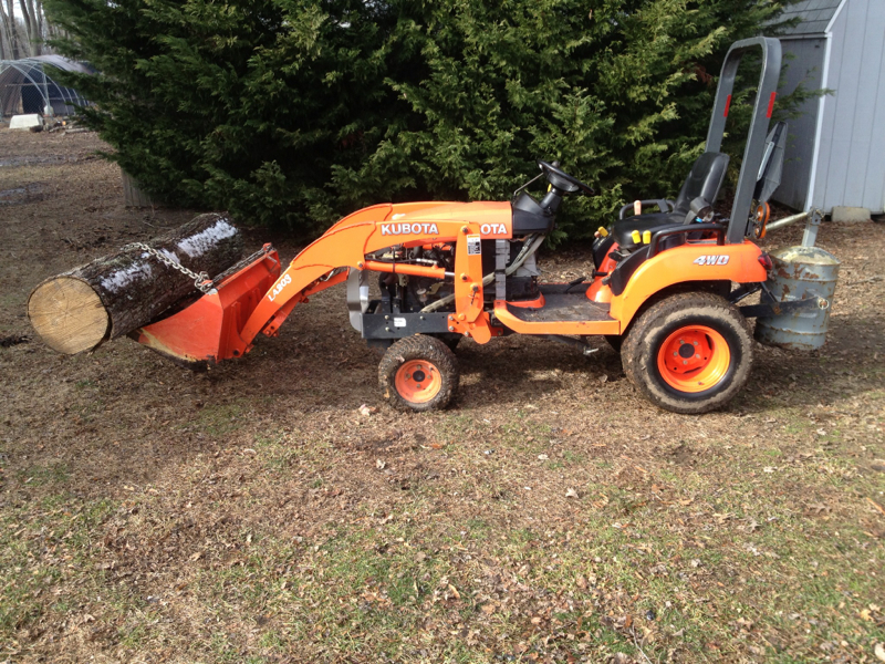

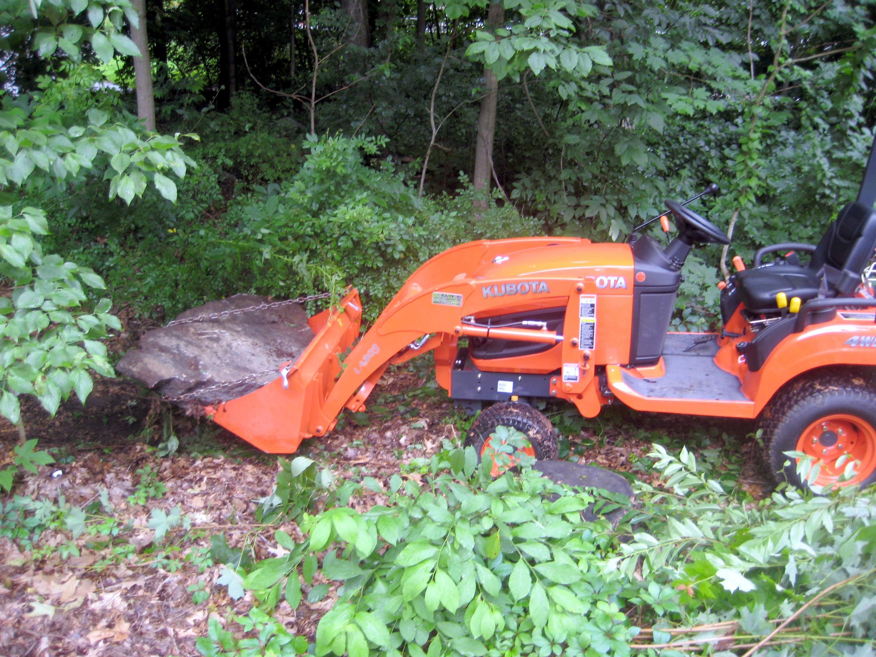

My first BX was an 1850 traded back to the dealer for an 1860. When I purchased it, I requested welded on chain hooks and the dealer recommended placing them at each outside top corner as the best place for that bucket. Since the the top edge of the bucket is not reinforced like heavier buckets and there's a single curl cylinder in the middle, the outside corners really are the strongest locations. Used mine extensively to pick up heavy objects and have never had a problem. Did the same with the LA240 bucket on my BX25. Here's a pick of the BX1860 (I think, could be the 1850) moving a large, flat rock.

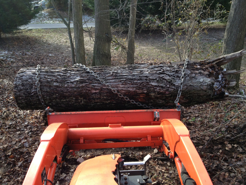

Well I welded on two hooks today. They work well. Unfortunately I ran over a small branch and it broke my cooling fan in the rear. Have you guys made any skid plates?

yes I have made my own. went to a metal store and picked out a 1/4 thick scrap cutoffs sheet and welded up a IMG_20121230_140835.jpgskid plate.
