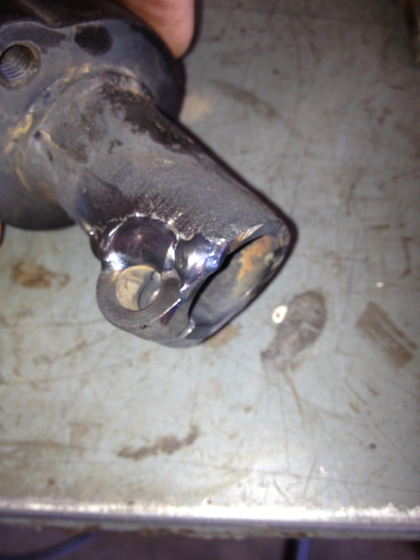

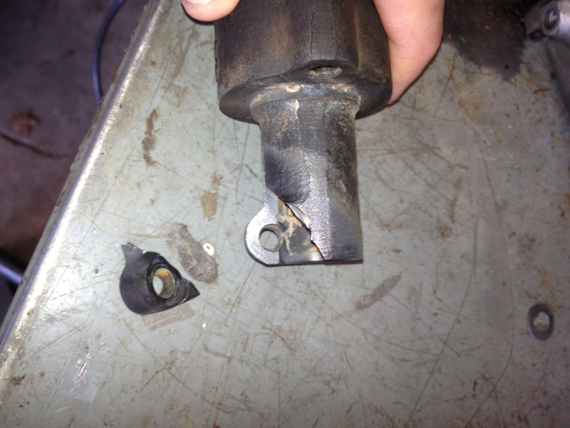

So I finally got around to replacing my hst fan. It was a bit harder than I thought it would be. I did cheat a little and drilled a whole in the deck above the fan. That saved some work of taking it off to remove the bolt thru the shaft coupling. I found that the coupling had broken in the past and I never knew it. I did have to pull the engine up and forward to make room.
