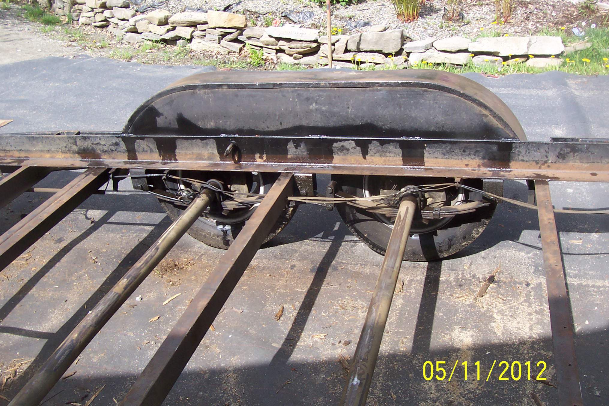

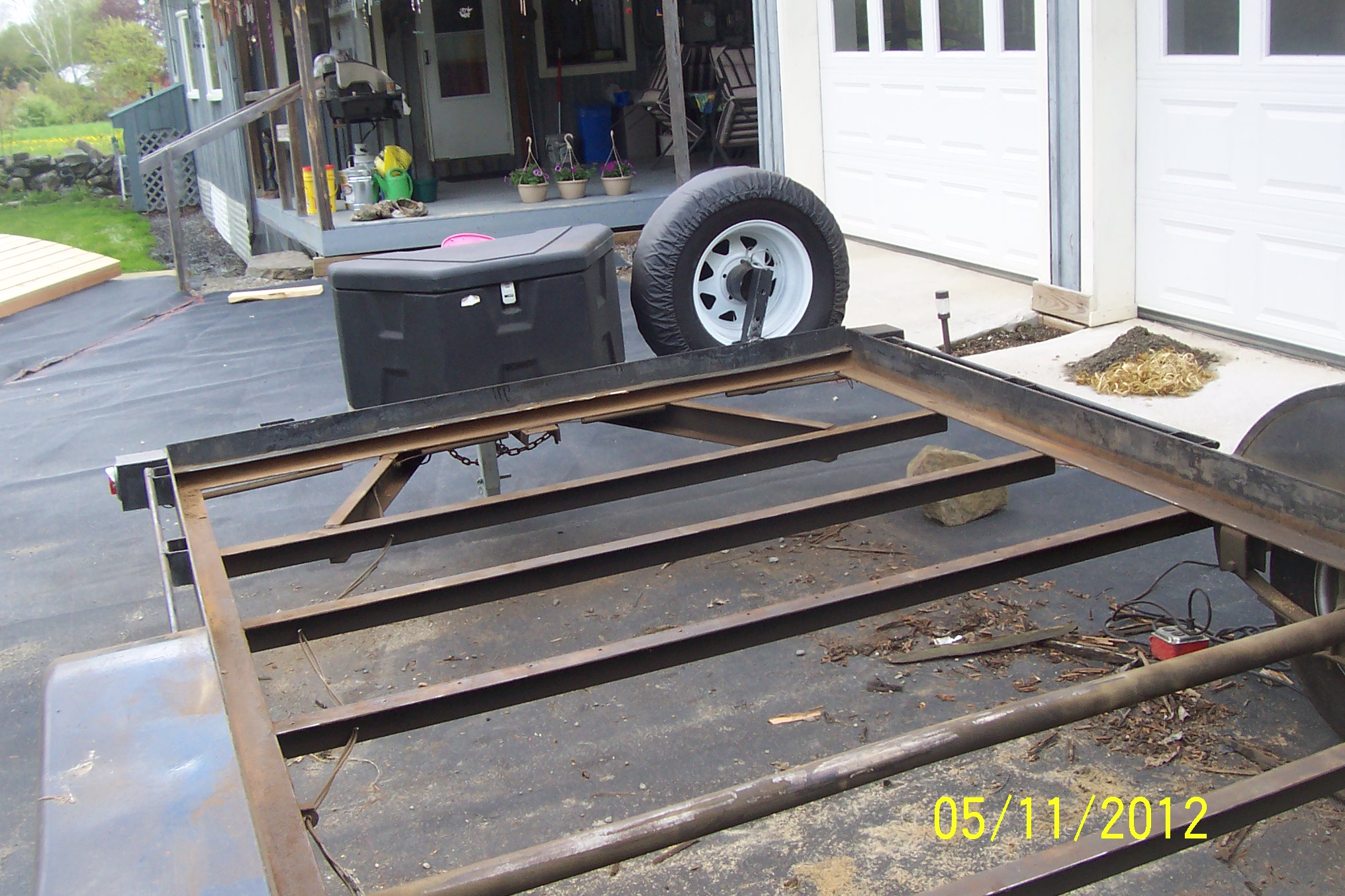

HI GUYS ,FINALLY HAD TIME TO GET BACK ON :ashamed:
first pics trailer stripped

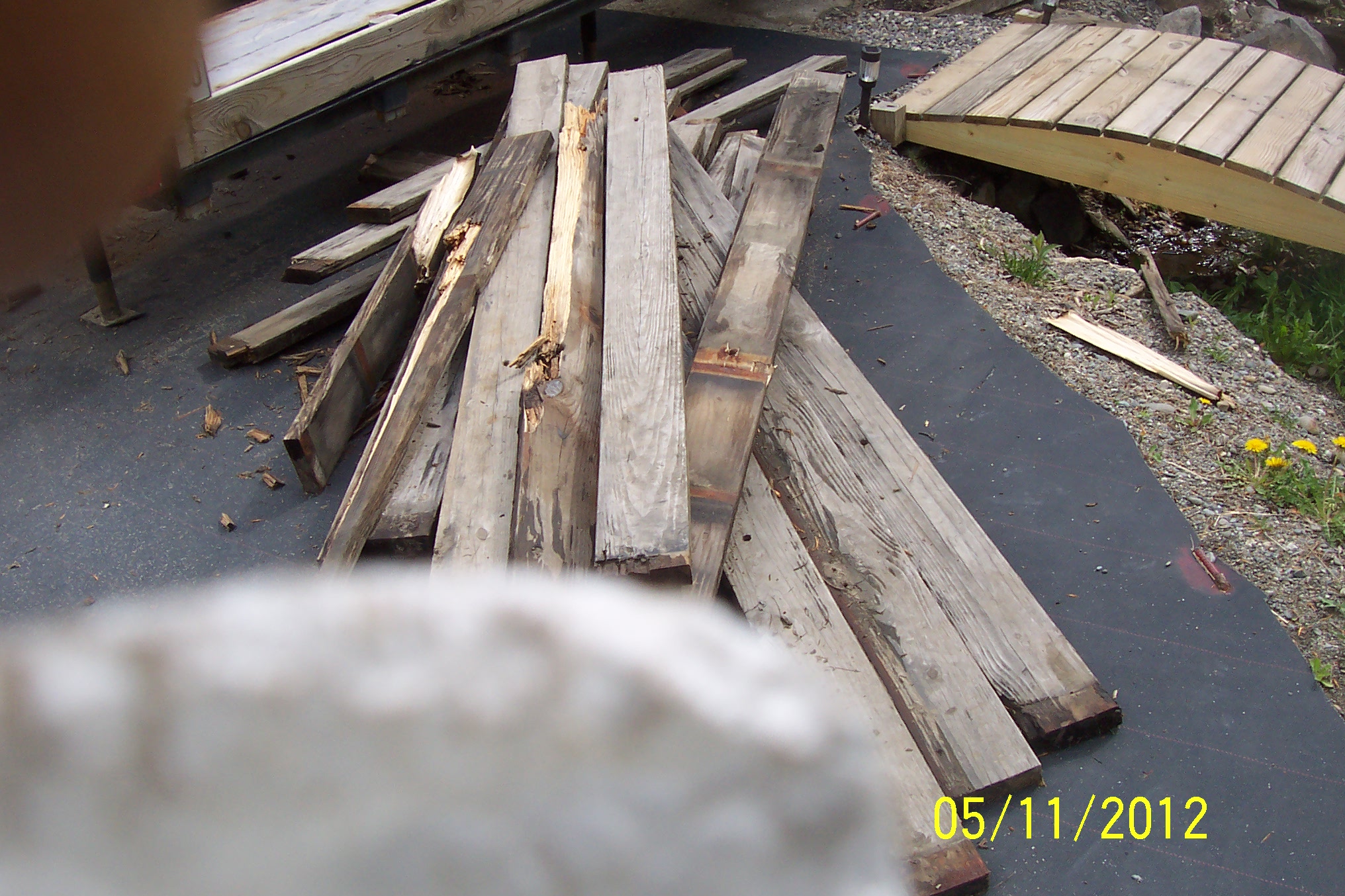

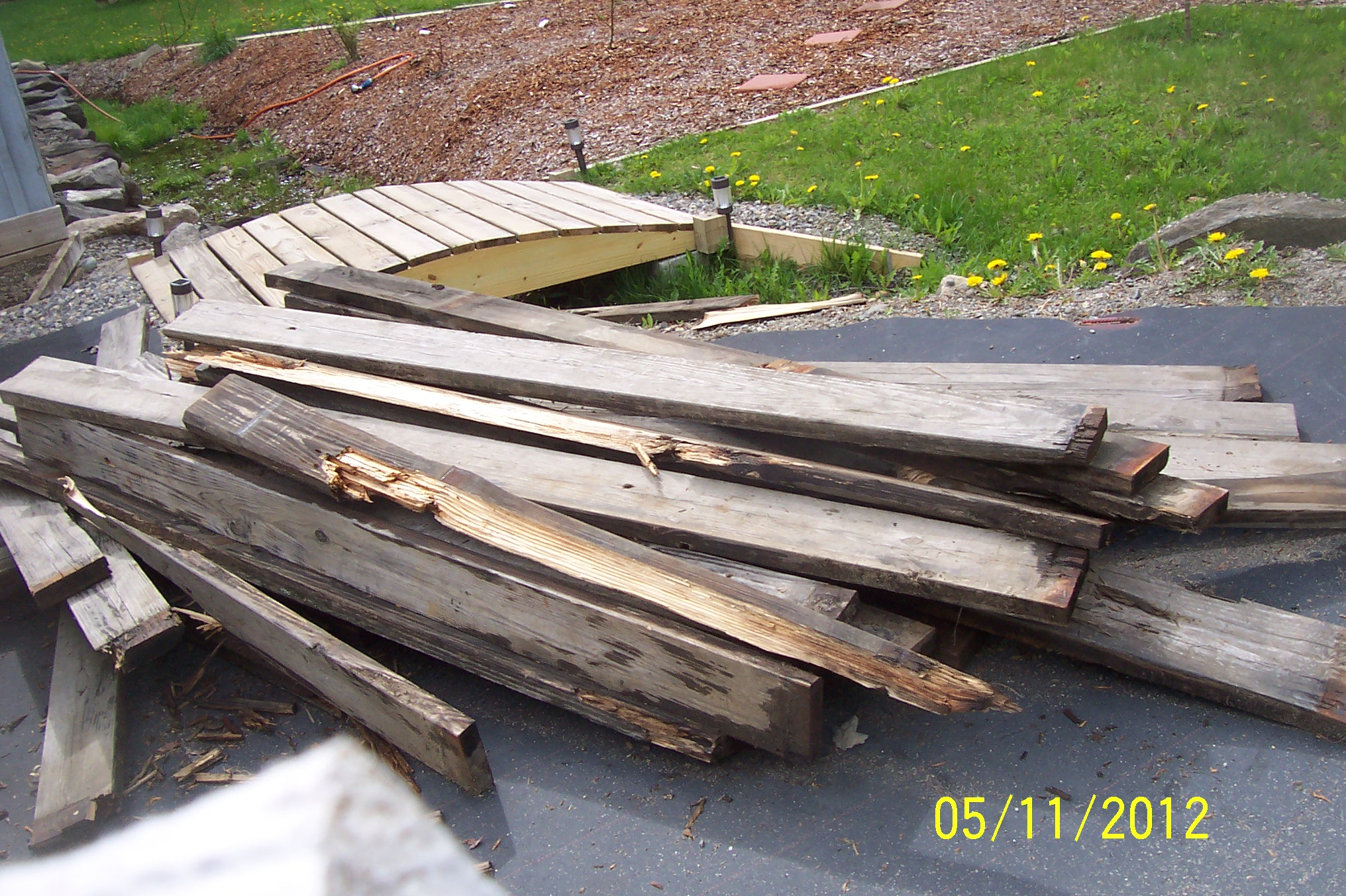

#47
Heres a couple of whats left of the 7 year old wood.Ihad put linseed on it every year too:confused:

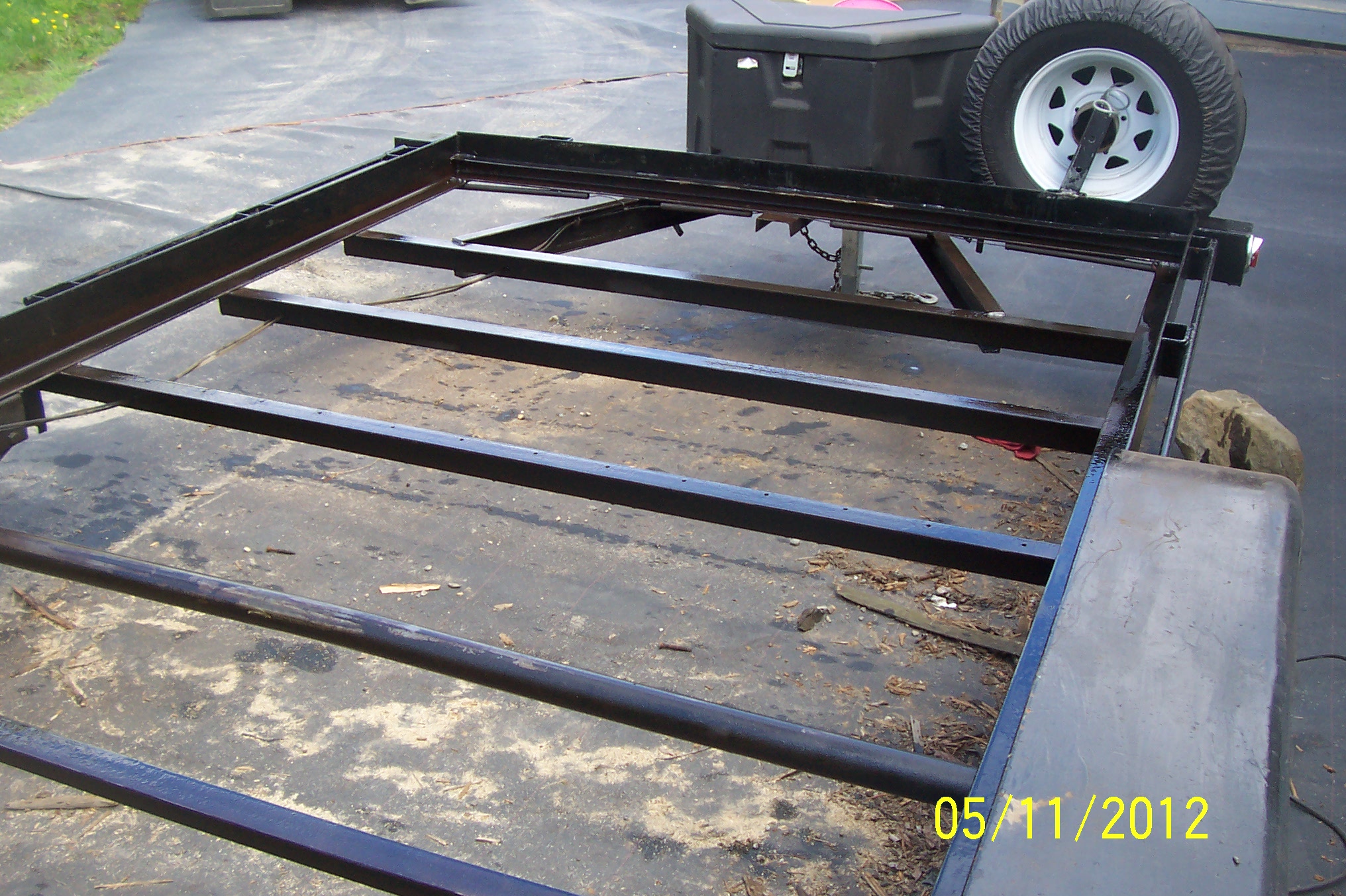

#48
after applying liquod gold:)Did you notice how nice the frame looked ,ive done it several times in recent years.Undercoated first couple,but it would peel off.This works well

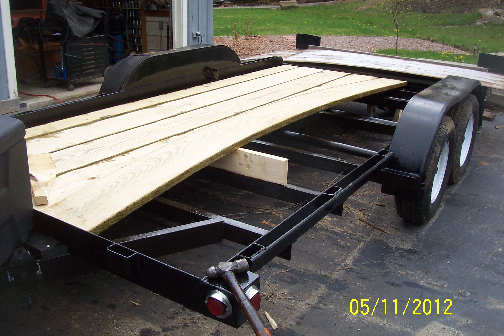

#49
I decided to leave the side frame exposed and start the planking at edge of it.This allows me to keep it protected ,without a plank on top of it.If your sideframe rots out,your done for.note i applyed my treatment to sides ,ends and bottoms of planks

#50
i spaced them about an inch apart.Thanks to my friends here on TBN,i learned how to install them
