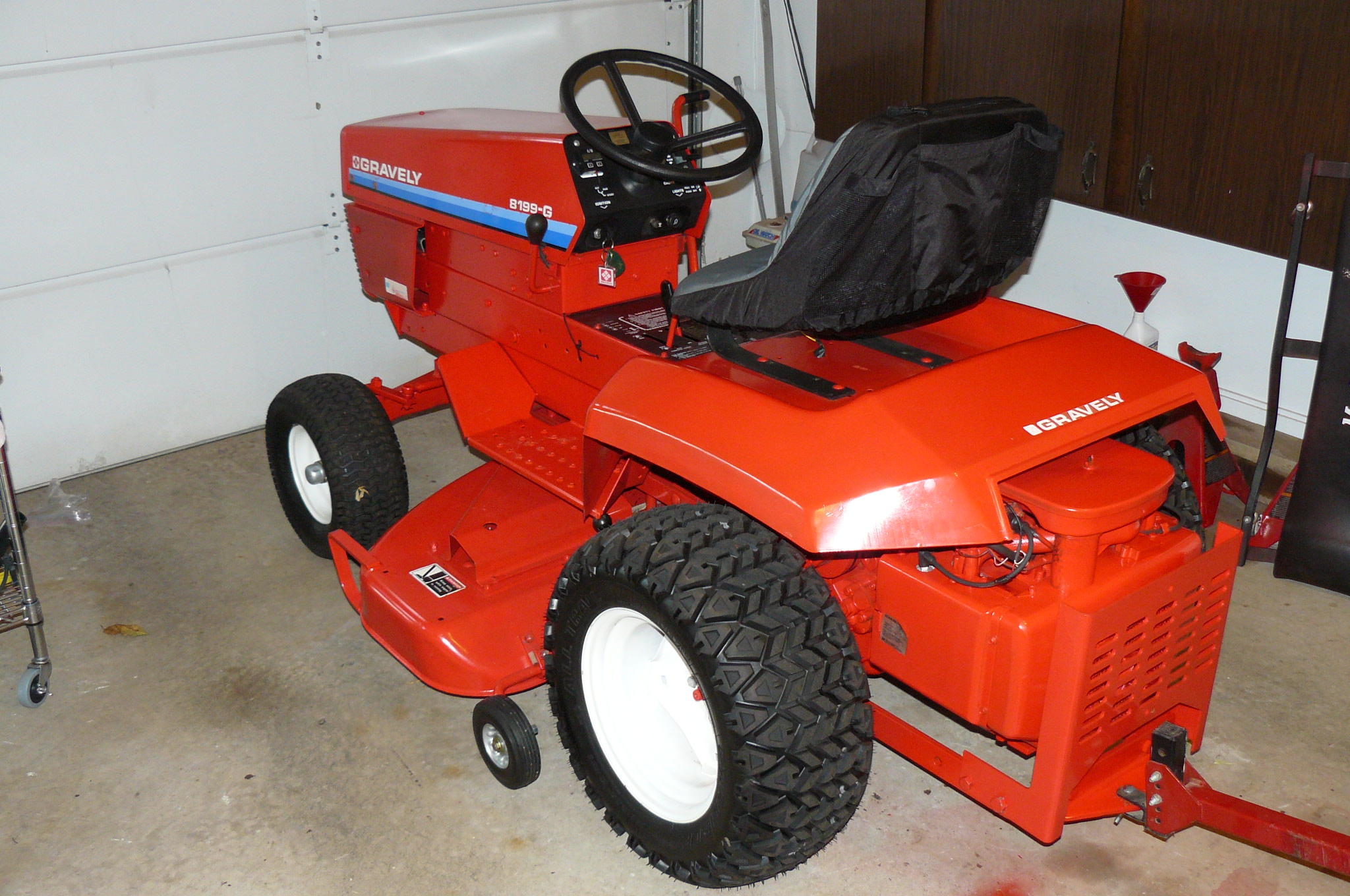

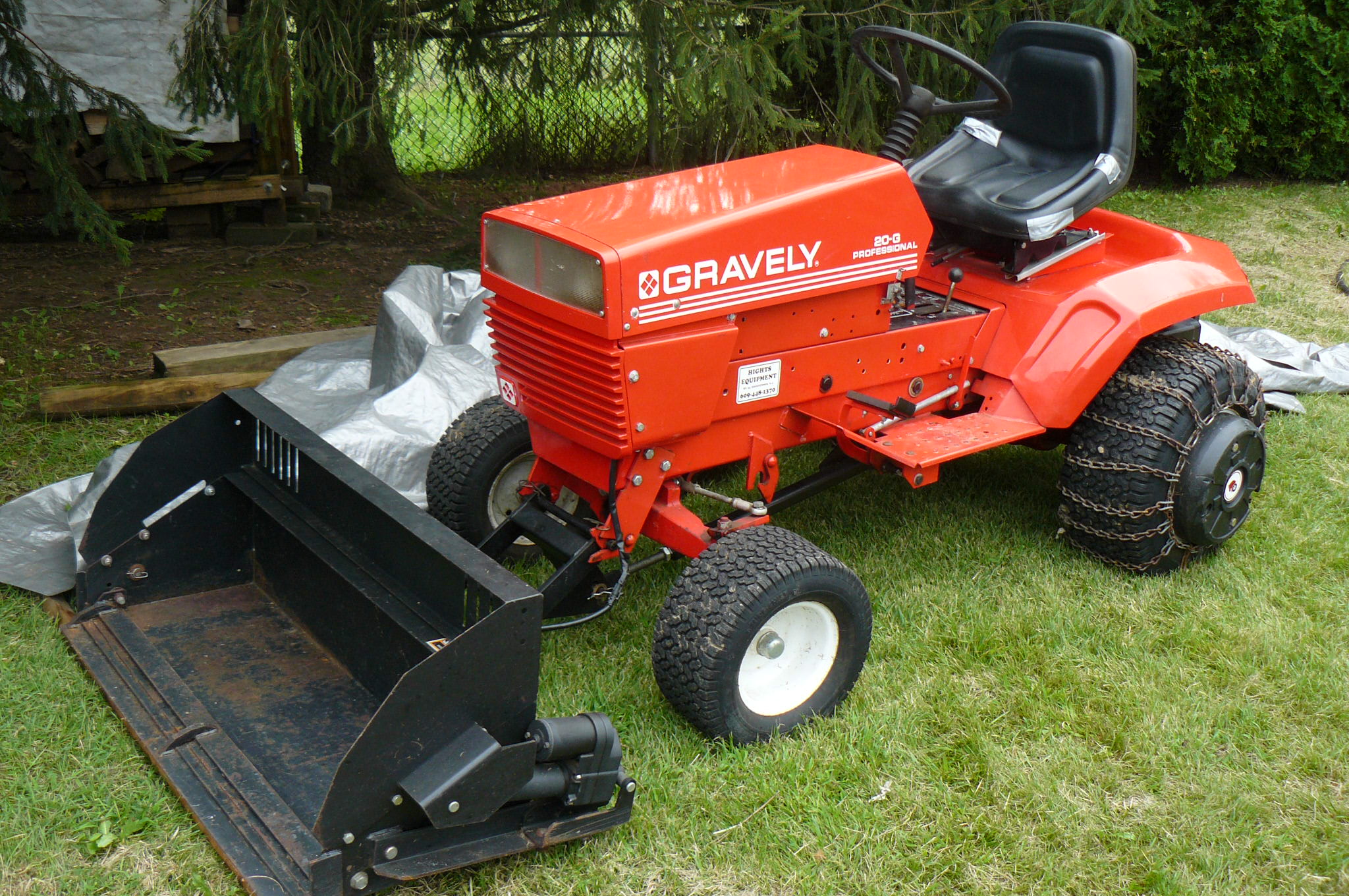

my 1986 Gravely is in good shape having been taken down to the frame by yours truly, but I have not touched the
750 original hour engine. It runs, makes decent power, but the dirty exhaust and chronically sticking points
are a pain. Does anyone here have experience with repowering with the 23hp Vanguard? They used to make a Honda repower
but that seems to have disappeared. I intend to keep this tractor forever, so I don't mind investing in it. It's used constantly for
field slope mowing, cart pulling, moving machinery with its ball hitch and blowing snow.
I have an ignition conversion kit I intend to install this winter when I have time, but that's only a patch.
pic of unit with my homemade rear weight box:
TractorData.com Gravely 8199-G tractor photos information
thanks
Drew

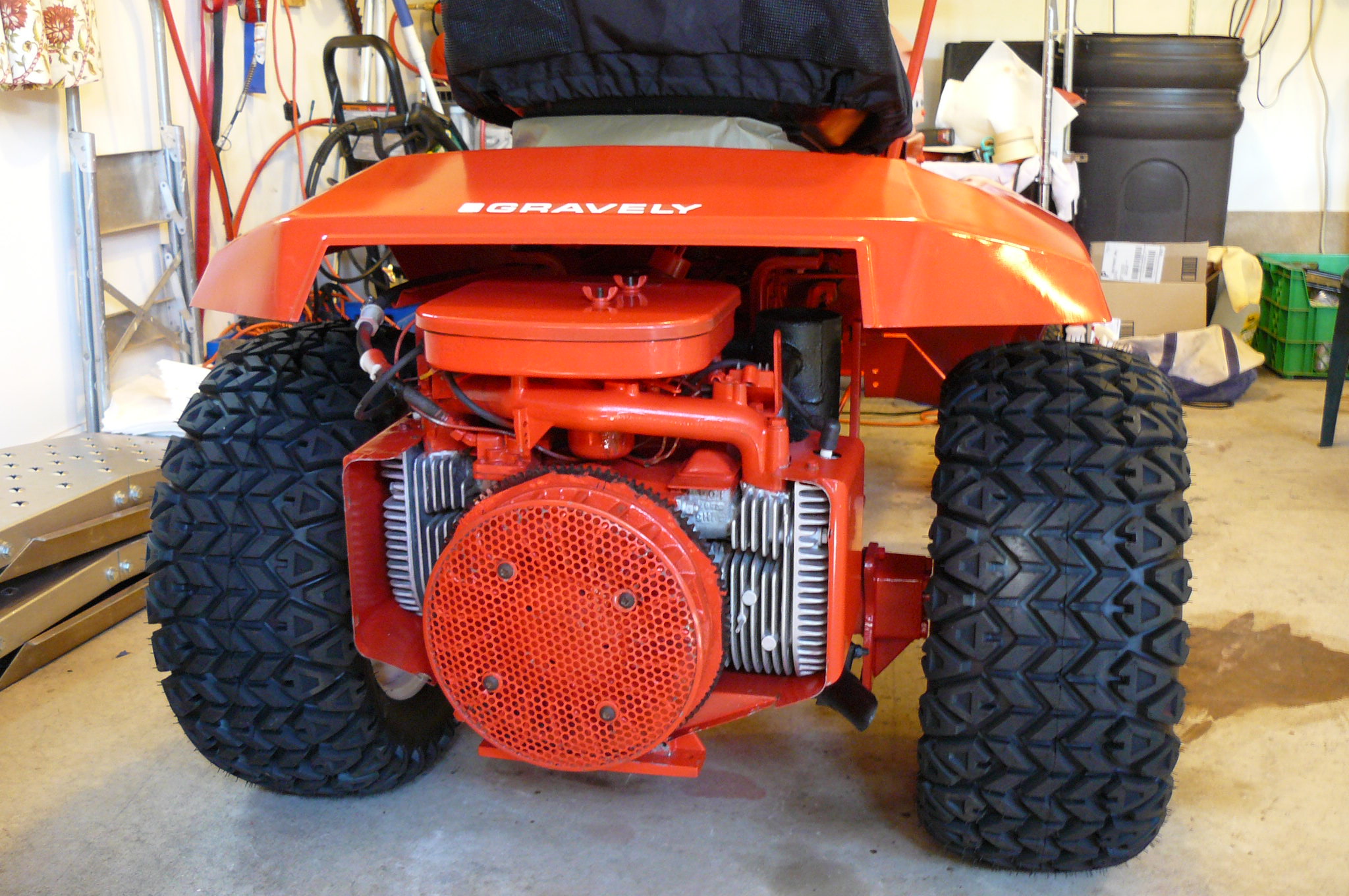

Here is a picture of my 8249.
Tail pipes are too long and the muffler clamps not chrome, but that has since been rectified.
I am a big fan of Onan engines. I tore down the 3000 hour P224 that is on my 24G because it was starting to smoke. I got out my micrometers and measured everything. Apart from the rings, nothing else was worn. It all met factory specs. I micro-honed the cylinders, put in a new set of rings and put it together. It is now good for another 3000 hours.

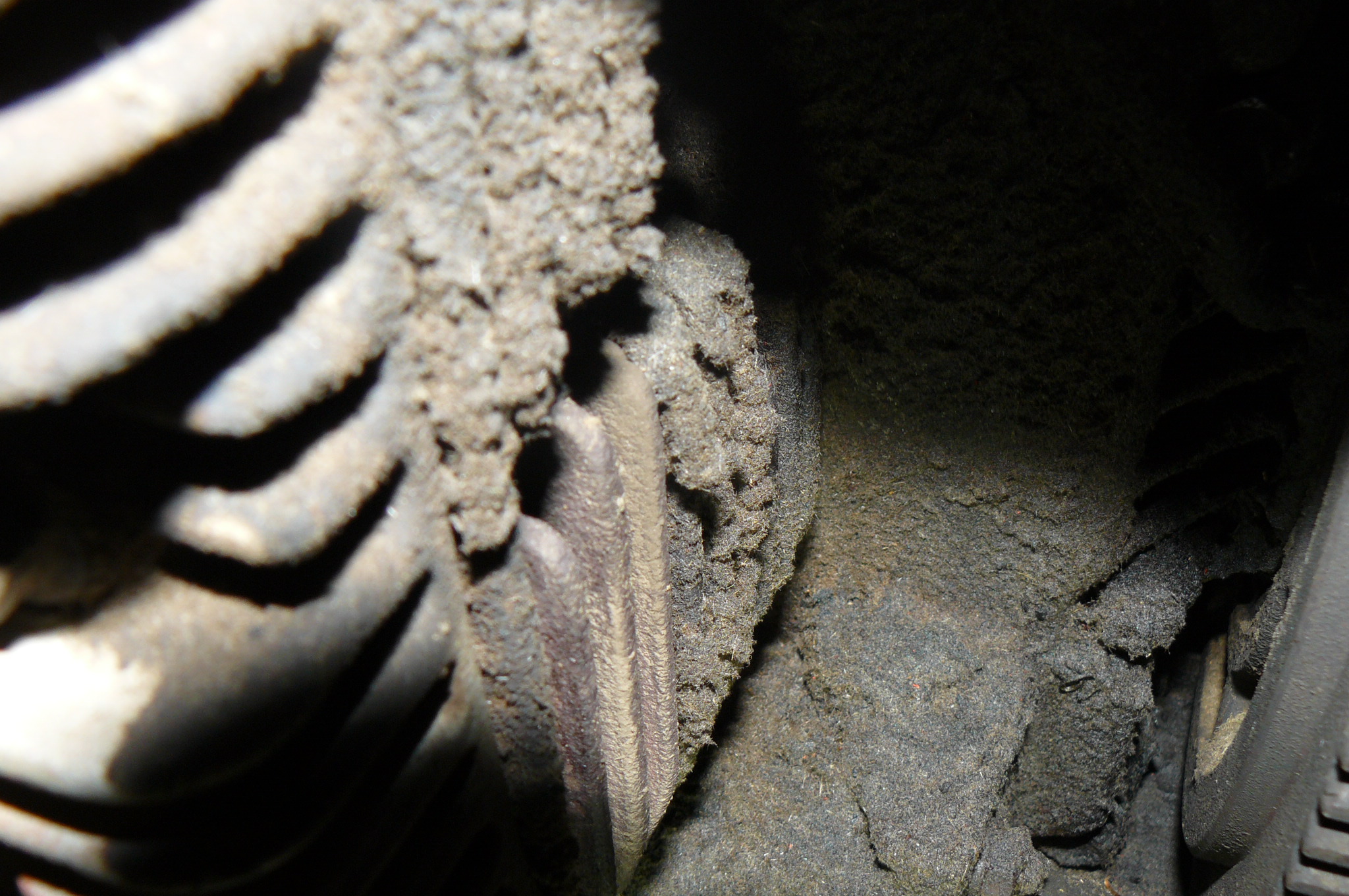

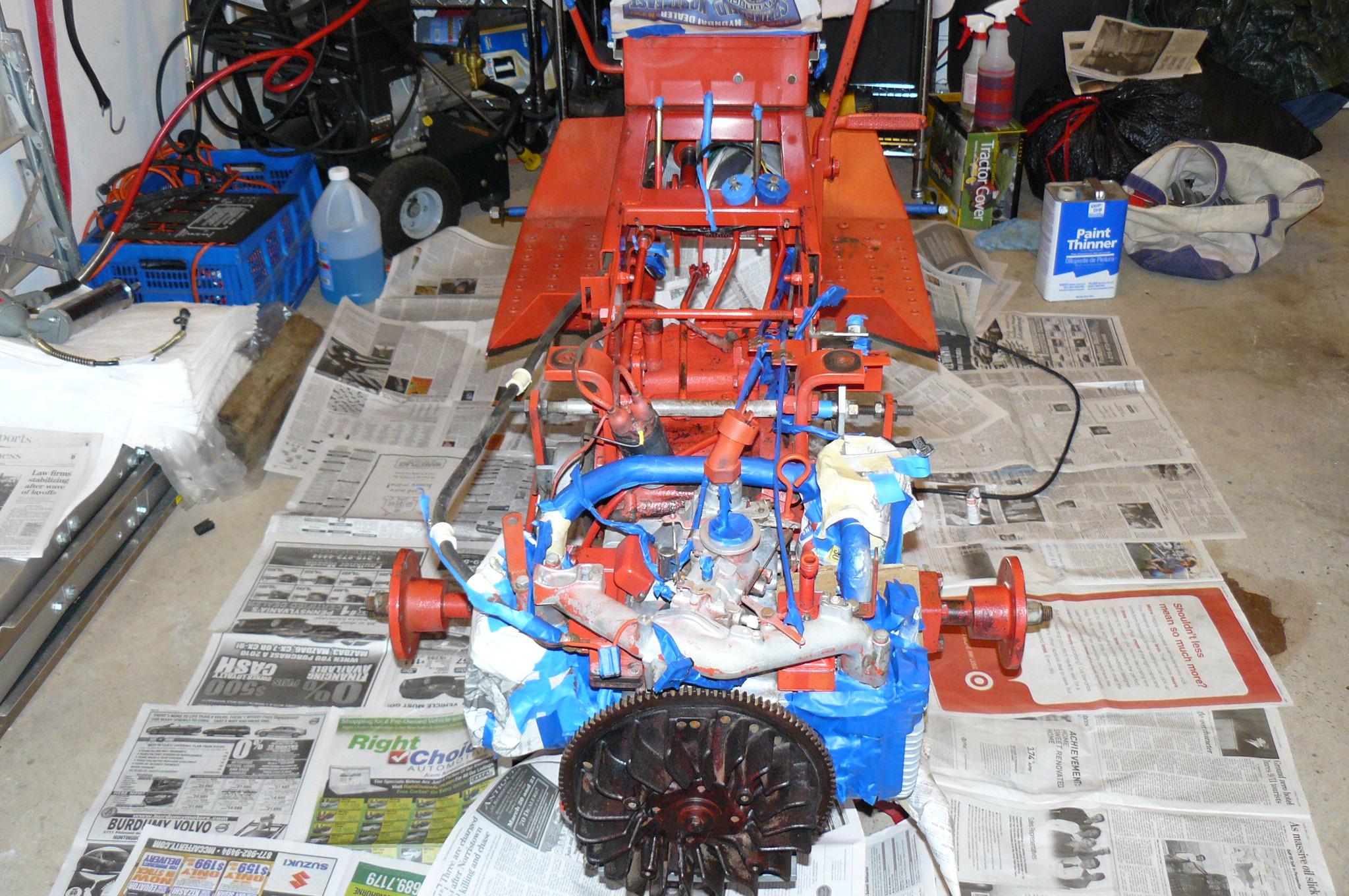

here is a favorite pic of mine during renovation, I call it "fins"
/ Repowering 8199G
#9

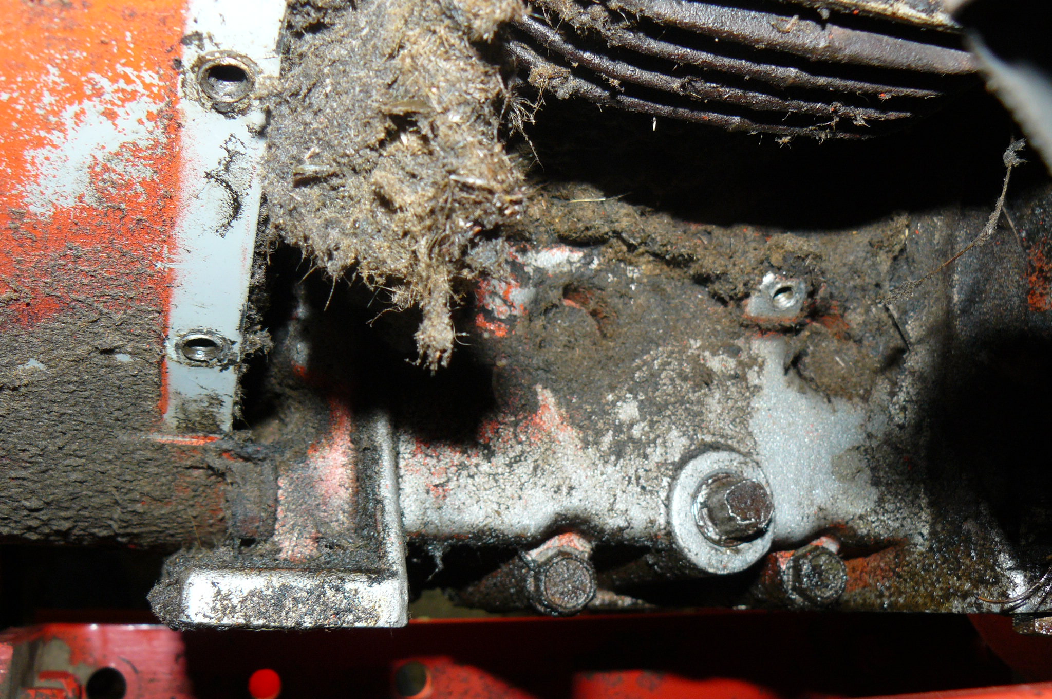

of course, this was during renovation. Without the shrouds on, I'd cook it, like you said. The fins were a mess, clogged with mud, almost like the prior owner went mudding with it, which I knew he didn't. Likely caused by oil and dirt, the oil from too much blowby caused by that tiny vent filter being clogged. So I cleaned them out carefully, and repainted sparingly. Love this machine, one of my favorites. I've put the newer model muffler on, which quieted it down a tiny bit, and a nice chrome extension completed the job. I think it sounds better, but likely all in my head. If they had put the points on this machine in a more accessible place, like on the single Kohlers, I would probably live with it. This winter I'm going to install Kirk's electronic conversion and see if that helps. Hate to get rid of an engine that works, but when it won't start with stuck points from sitting for a few weeks, it just drives me nuts.
btw, your Onan looks super. The 24G was always the one I drooled over, didn't they put a Subaru engine in that too? A guy locally, who I bought the snowblower for it from, has a 24G with a Johnny Bucket on front, a very nice setup.

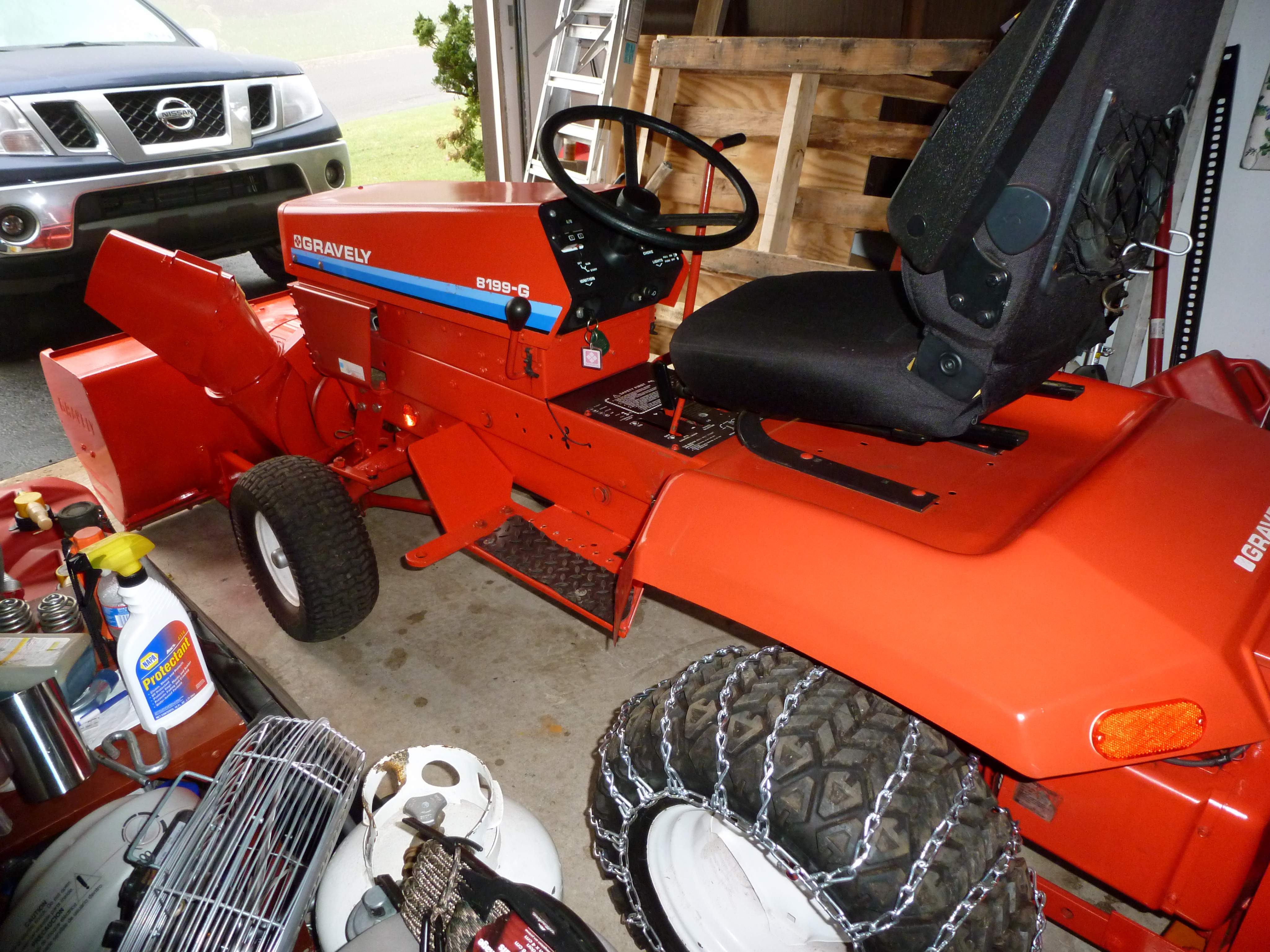

Richard, I've had to take a wooden dowel and gently tap with a rubber hammer on the points case, and that usually worked. Come to think of it, last time it was serviced they replaced the pushrod along with the points, and I've not had the problem since. Hmmmm.
And....my bad, it was not a 24G I saw with a Subaru V twin, but rather a 20G. Found the picture, too bad I didn't get one from the rear. Sure liked his Johnny Bucket. I bought this guy's snowblower for my 8199G.
btw, I took one ride with the chains on, scratched the heck out of my driveway, took them off, built a weight box with 300 pounds in it, and it ran marvelously.
