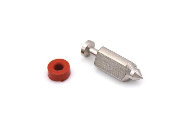

Big nemesis of B&S motors is they may have neoprene donut (O ring) for float valve seat... E85 swell them up.... Makes engine fuel starved ...
