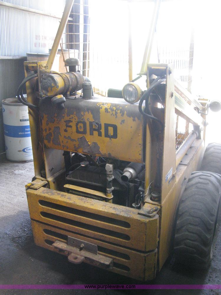

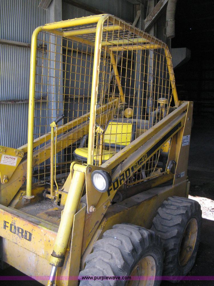

Yeah, the wisconsin is the big down side to these machines. The CL40 (ford branded) is basically the same frame/hydraulics as my 30 and it uses a 4 cyl water cooled ford engine (picture attached). What is interesting is that the CL40 doesn't use a foot throttle, which makes me wonder if the valves are a little different or if I'm just used to moving the sticks and then adding power.
