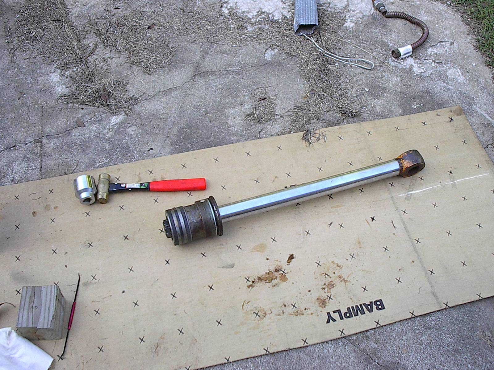

I rebuilt 2 rams on the 580 over the last couple days and took a couple photos of the pieces and parts to give an idea of what's inside.
This first one is what the inside looks like when the end is unscrewed and pulled out. This pic is actually after I got it back together. I forgot to get a before photo. Oops..

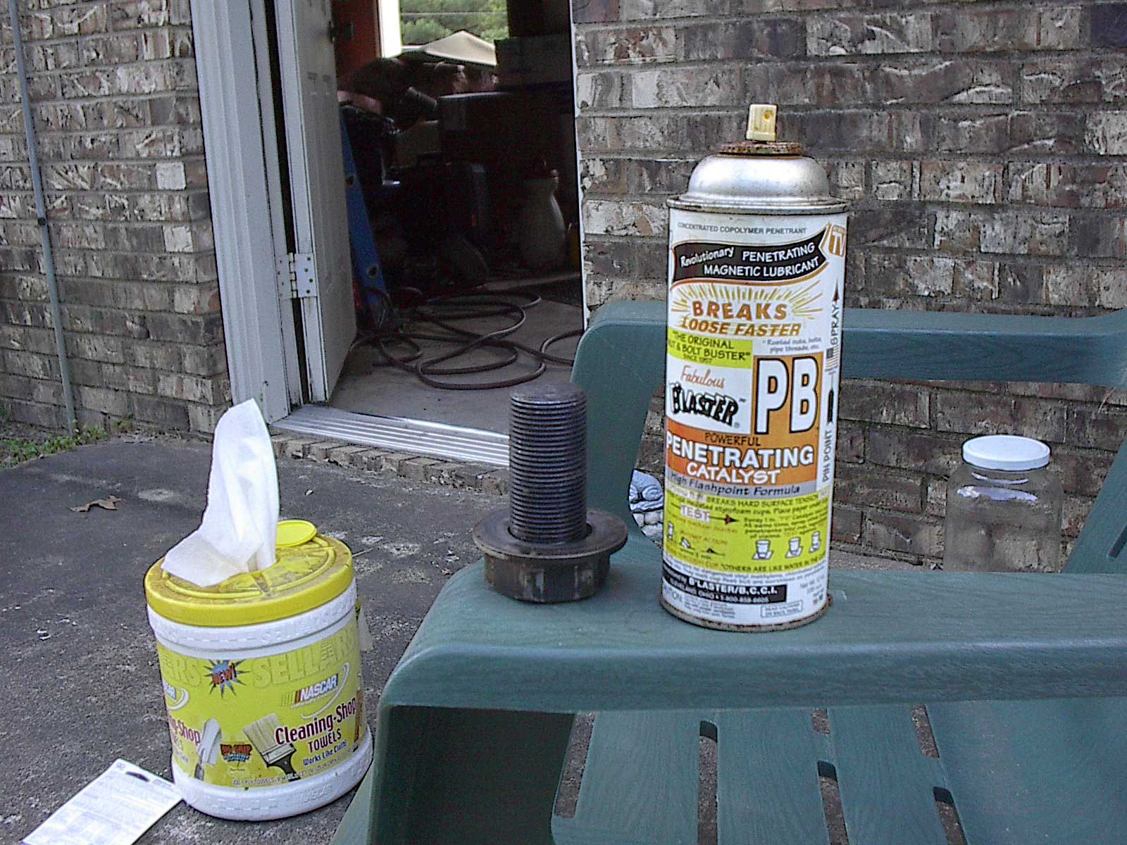

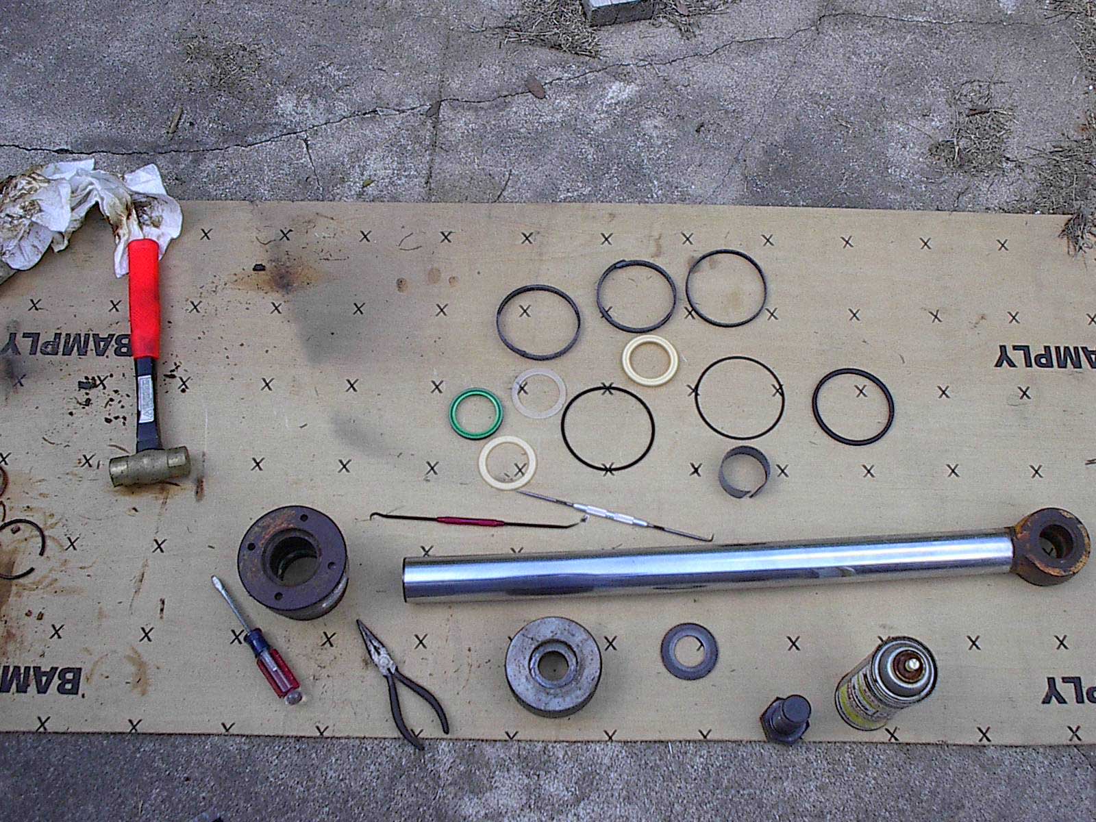

Now, after you get the big honker of a bolt out of the end, the piston end comes off, the gland slides off and you can break the whole mess down.
It's good to have a place to lay out all the pieces. I chose some leftover plywood so as not to harm the metal bits.
The first pic is the big bolt in the end of the piston that join the piston to the rod. Oil can for scale.
Second pic is all the parts laid out. On the left is the gland nut, aka the end of the cylinder. You can see the blind holes to put the gland nut wrench.
Bottom center is the piston and center is the piston rod.
At the top you can see the seal kit. The big rings on top are wear rings for the piston.
The green one is the dirt wiper for the end of the gland nut.
The thick creme one is the Ucup seal or oil seal.
The clear one goes under the Useal in the gland. The thick nylon ring is the gland wear ring.
The large oring and backer ring in the center go on the outside of the gland nut.
The thin creme one is called a buffer seal in the directions but that I didn't need it for my model cylinder.

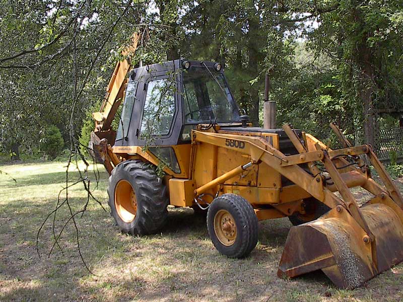

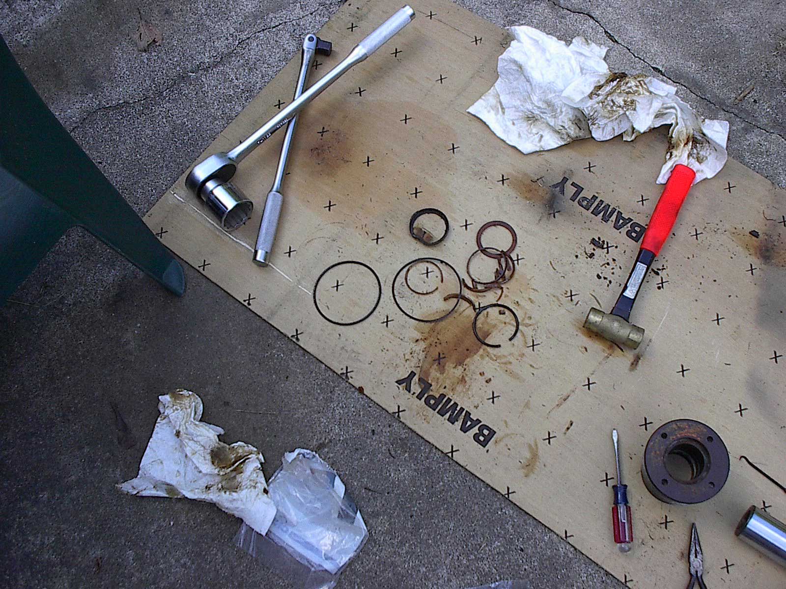

The third pic is the old brittle, crusty stuff that came out. No wonder it leaked... Last pic is the new to me toy that the parts go on. :)
I hope these shots shed some light on whats actually in a hydraulic cylinder. No magic voodoo, just some rubber and plastic in the correct order.

Heated the bolt really warm and melted the factory loctite and it let go finally.

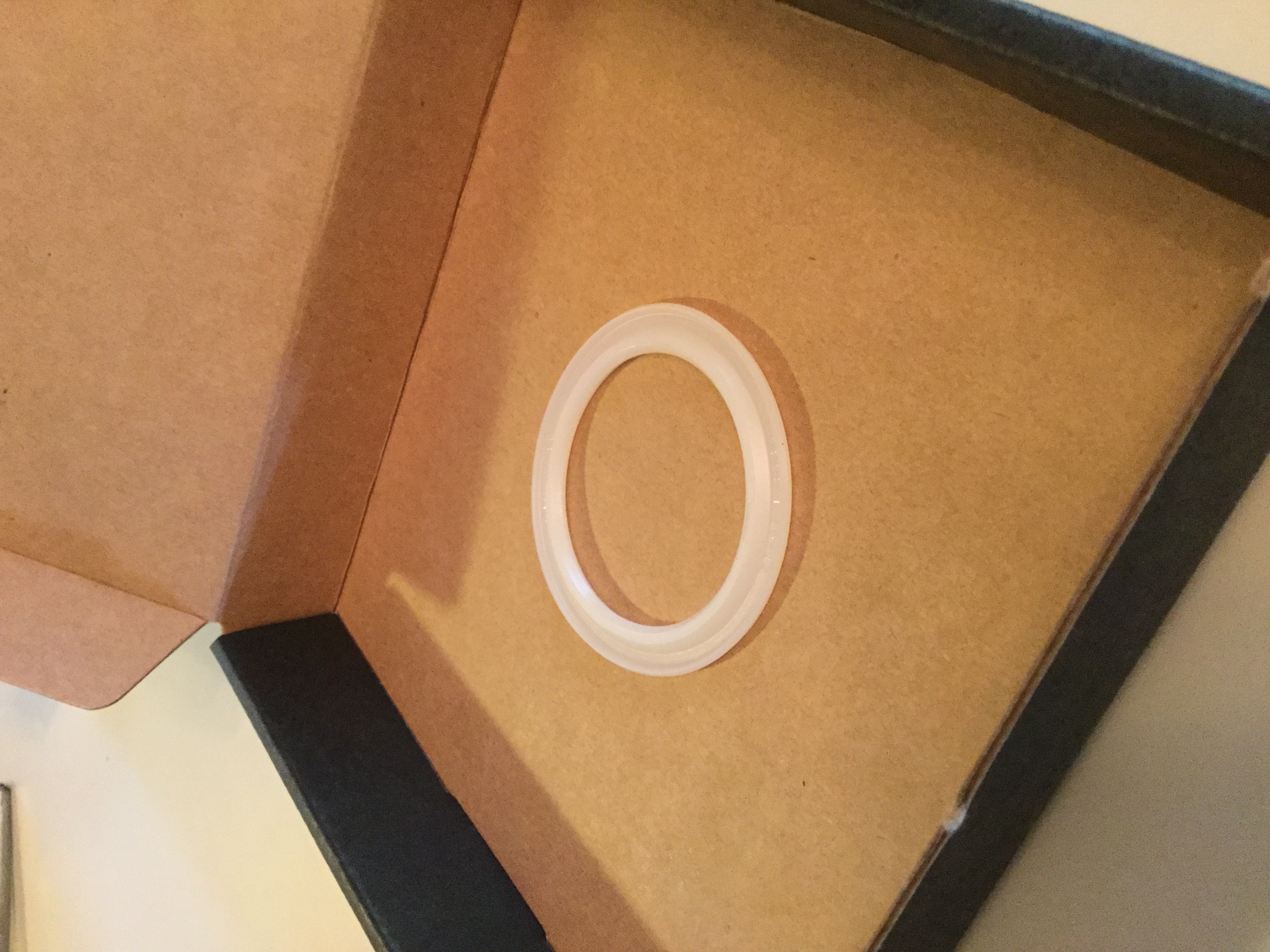

Hello not sure if anyone is stilli following this forum? I recently purchased a case 580E backhoe and I am in the process of rebuilding the hydraulic cylinders, there is just one seal I can't figure out the placement on. Any help would be appreciated.IMG_0342.JPG
It appears to be the same seal as in the bottom left of your seal kit.
