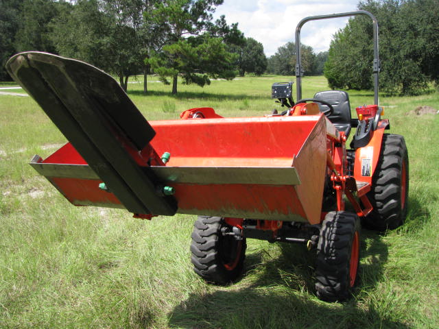

"Probable purchase will be a Kubota L3200 with Fel, Backhoe and rotary tiller."

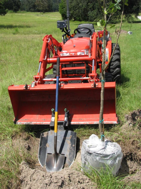

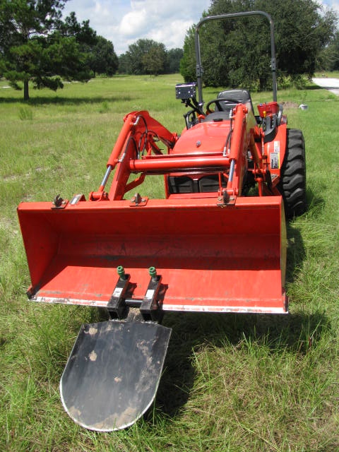

Do you REALLY need a backhoe? Heavy, expensive and ties up the three-point hitch. Trust me, you will not want to remove/replace that backhoe, so the rotary tiller will sit.
FEL, on the other hand, is always useful. Four wheel drive is essential with FEL.
Rather than a backhoe maybe a <$400 bucket spade on your FEL will suffice. L3200 is excellent size and weight to optimize bucket spade.

Jeff, this is a great tool and would be a perfect interum fix until I could afford the backhoe. I have very rocky soil. Any thoughts on how it works in rocky soil?
   / Researching my first tractor #20

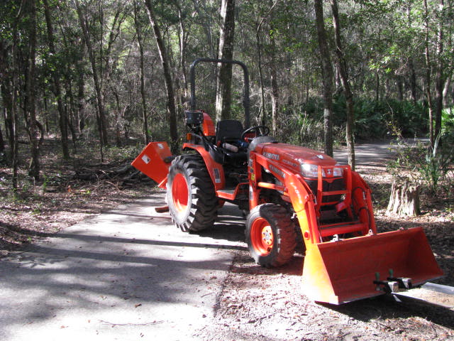

BIG rocks or gravel? Bucket on my B3300SU weighs 216 pounds + 110 pounds for bucket spade + FEL down hydraulic pressure [ ? ] + limit of tire traction pushing FEL [ ? ] = Total Available Force To Push Bucket Spade into ground. A pretty large force pressing on a sharp edge.
L3200 has a heavier bucket, heavier frame and larger tires. Yes, I think the bucket spade would work in gravel soil. If the rocks are granite boulders the sharp edge may be battered dull and require regular if not frequent sharpening. Learning to finesse the FEL joystick is important.
My soil here in north/central Florida is sandy-loam with some limerock, up to cantaloupe size. The bucket spade cuts right through limerock.
RE Backhoe: The three point hitch is where most interesting implements mount. You want it readily available; not tied up.
What is your projected use for a backhoe?
