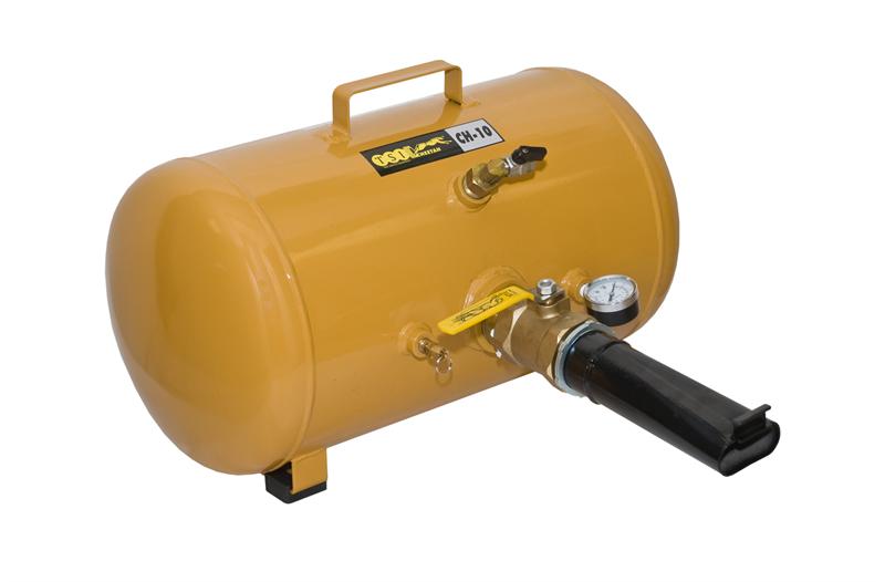

I took a piece of 3/4" copper tubing and flattened one end and soldered a fitting on the other with a ball valve and hooked to an airline. So far works everytime. Sort of a scaled down version of one of these:

Usually you need more hands to do everything.
1) use air hose with air chuck that will stay connected to valve stem (have to press lever to release)
2) use ball valve in airline so you can have valve from valve stem removed and control air with ball valve
3) secure rim to something so you can use your hands to wiggle/position tire
4) try and get one side started before you apply air so you are only working the remaining side, it is hard to try and seal both sides at once.
The secret is the volume of air to get it started. Once started, not as much is needed.
