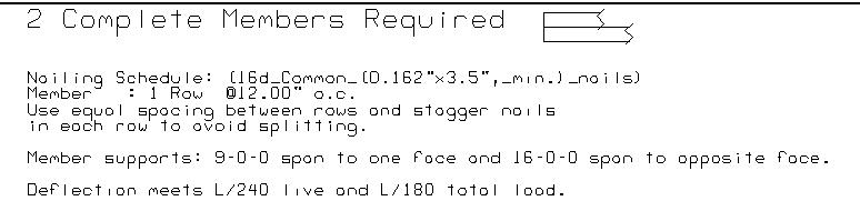

Check out the Weyerhauser/Trusjoist site and start going thru the literature. If you look thru the specs in the LVL and beam sheets there are span tables in there that might answer your question.
Trusjoist Site
   / Residential beam sizing question #3
If you're buying the LVL beam from a lumber yard, they will size it for you. Bring the dimensions of the room with you, ie; length of supporting wall being removed as well as the length of the ceiling joists being supported. On one occasion, I found the chart to be incorrect but, the software was updated and provided the correct sizing. I verified it by cross-checking with another vendor's software.

ejb; Yes, that helps me to help you. I put in a beam as you are describing a couple years ago to cure a sagging cieling in a post war econohouse. Rebuilt everything except a gable end wall and the roof in that one.
What we did is rest a doubledup 1 3/4"X 11 1/4" LVL on the top plate of the new gable wall and the other on the new bearing wall at the centerline of the house. I used top strap joist hangers, I think they were something on the order of 18" depth. This pulled the sagging joists up to where the cieling would be flat. My building inspector commented that he'd never seen that before, but saw no reason it wouldn't work fine. I think in your case though, you might be better off to support your joists the conventional way with a header, supporting the joists from below. With the loads your talking, a doubled up 1 3/4"X11 1/4" LVL's would probably be enough, supported by 4 studs at each end, supported by the carrier beam under the house. Well, I'll bet that's clear as mud, but with that said, maybe you can speak with your inspector on a little more even keel. Like you, I can't stand to not be able to speak intelligently about a subject. That's why I try to limit myself to just a few subjects. /forums/images/graemlins/smirk.gif
Please let us know how you make out, never too old to learn something, ya know? /forums/images/graemlins/grin.gif
Do a search on the internet for Simpson Strongtie. They have an online catalog, but the one you can request is much easier to use, and it's free. /forums/images/graemlins/cool.gifOther manufacturer I use is Kantsag and USP. Goodluck.
