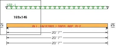

ok if I understood right your beam will need to hold
122.1 PLF

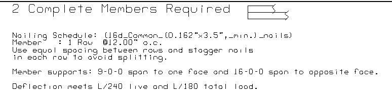

1 (2 ply) 1.75 x 9.5 Versa-lam (that is all i have in my software at this time) will work.
(have the beam company duble check this before using)

Seems to me the guy at GP thought it had the whole roof load and not just the ceiling.
Seems the lumber yard came up with almost the exact beam I did
It is holding the cieling only right?
