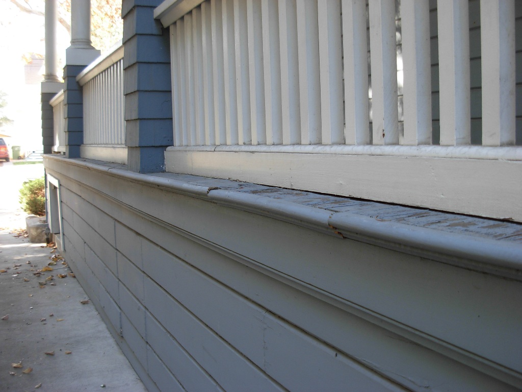

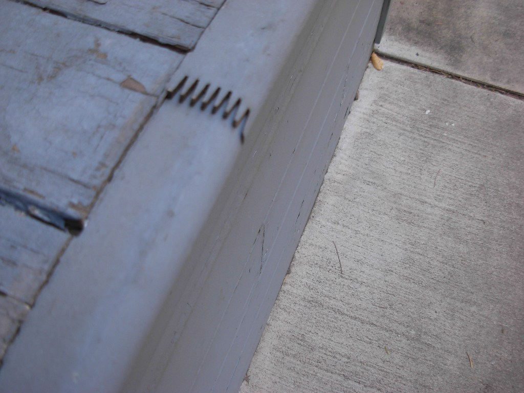

I don't know about finger jointed studs, but I have experience with finger jointed trim and I will avoid buying it again in the future. I installed it many years ago (can't remember how long) and it has come apart at the joints.
I went to buy more trim to replace the bad stuff so I went back where I bought the first batch (only place that I can get that design trim) and was trying to find it without finger joints. The guy that works in the trim section was helping me asked why I didn't want the finger jointed trim and I told him about how all the joints came apart and that maybe I didn't paint it properly. He told me it had exterior glue and for it to come apart like I described just shouldn't happen. OK it isn't supposed to but it did.

Sorry to say, but using the fingerjointed trim in a place like the porch shown in the pics, is not a good place for softwood, regardless if it is fingerjointed or not. Moisture soaking into the wood is the problem. Something like cedar or redwood is the woods to use for this application. Such softwood trim is really not meant for outdoor use, and the rest of the porch railing and parts show that problem.
