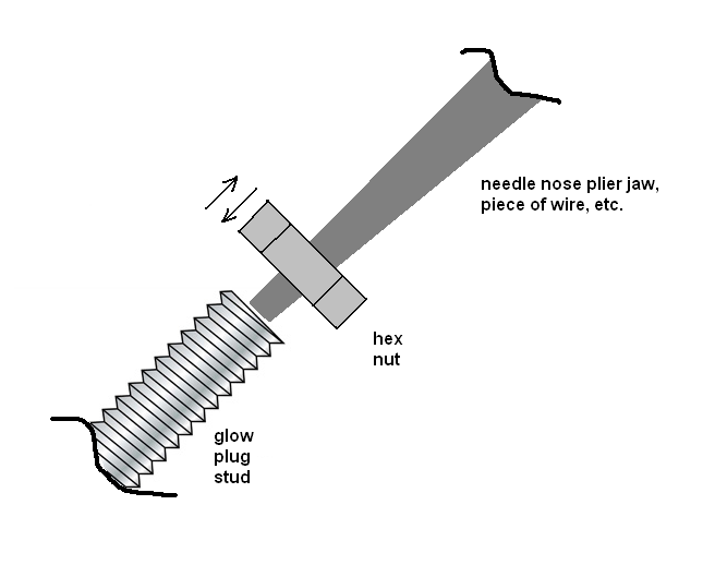

FYI - the little hex nuts that hold the wiring on are M4 x 0.7 (in case you happen to drop one and then can't find it). I did come up with a technique to help avoid that:
Essentially something to hold the nut until it catches the threads when installing or to catch the nut when it comes off the end of the stud when removing.
