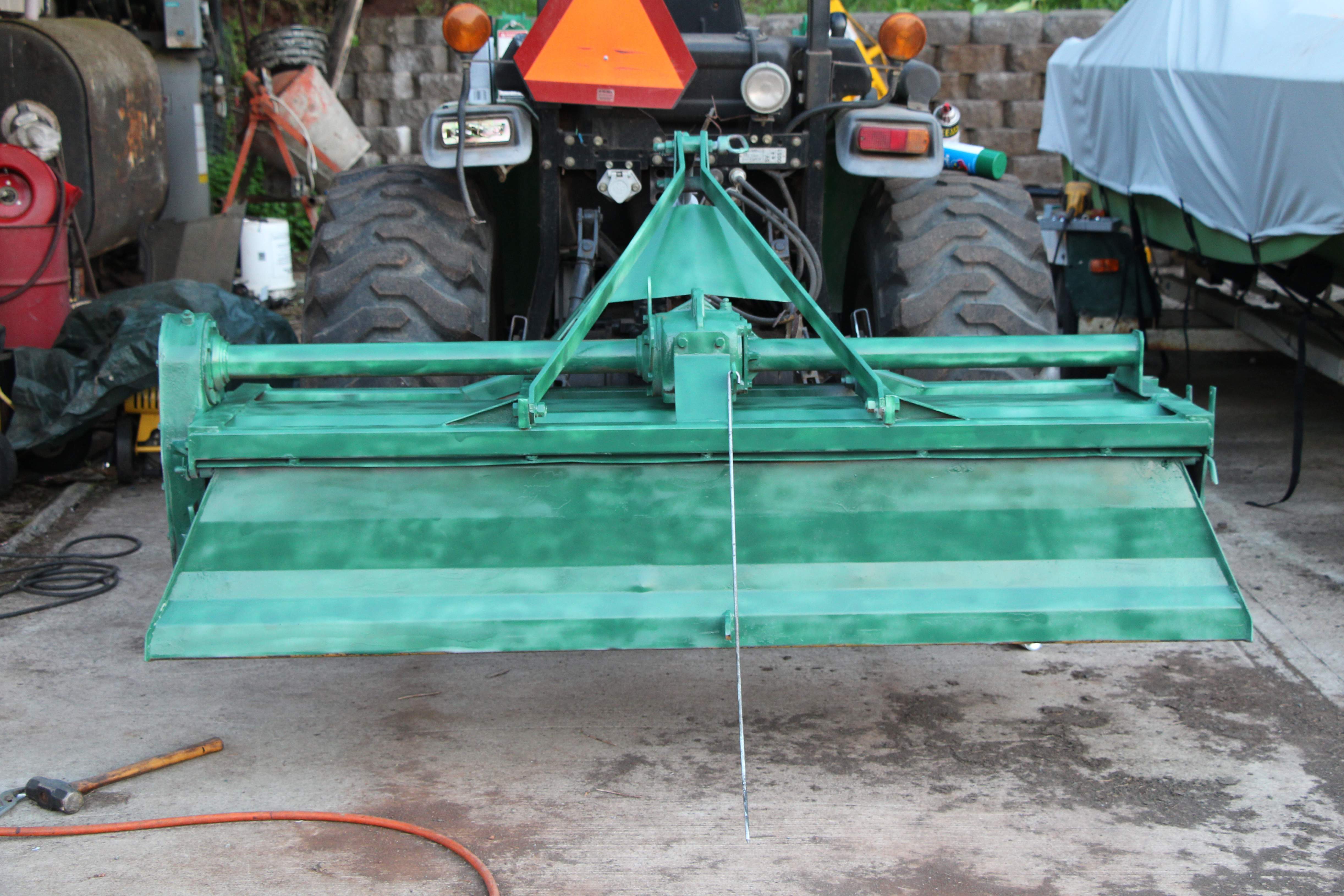

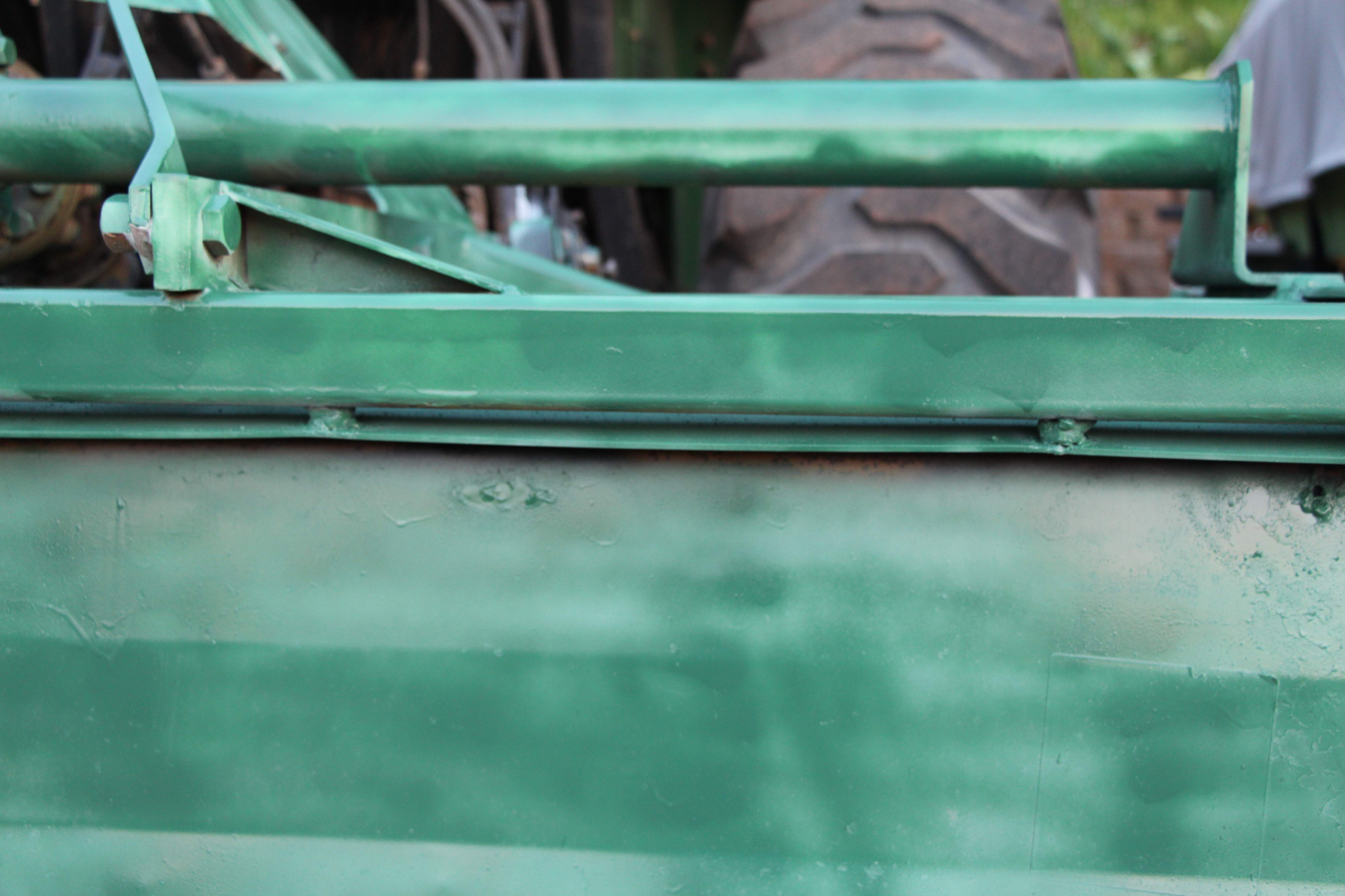

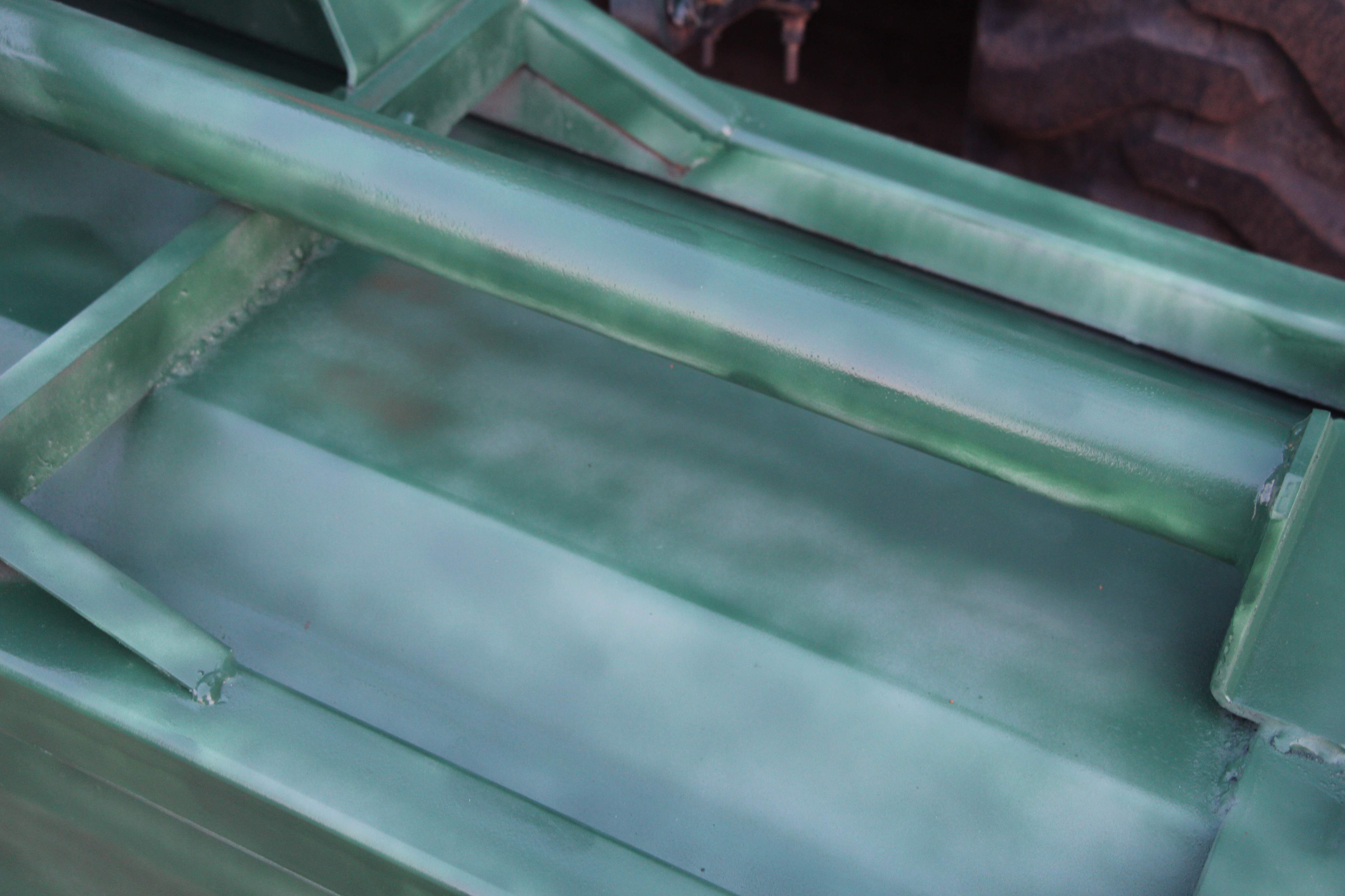

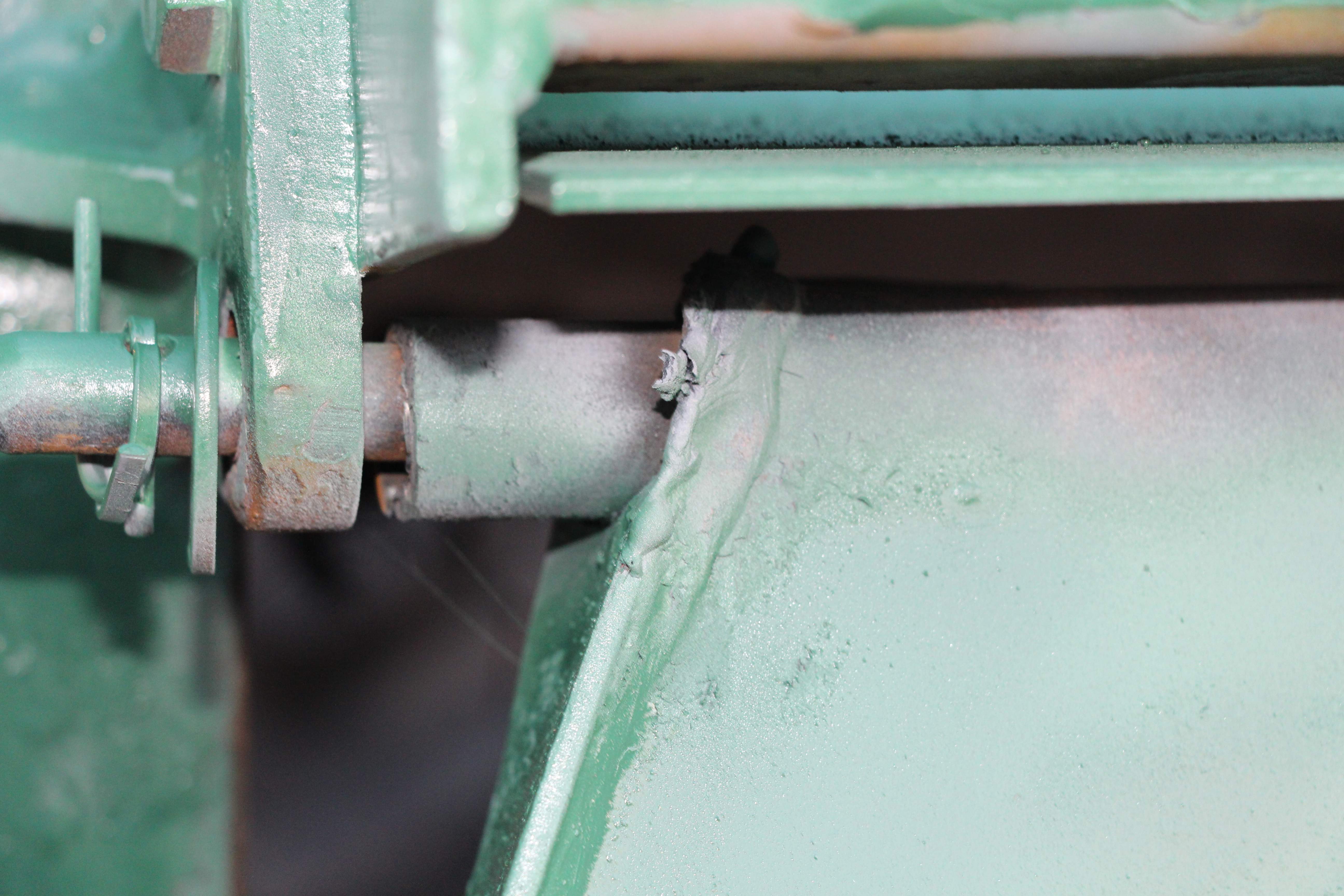

OK, skin in, welded, painted (mostly-- it was a poor quality paint, an going to get a few cans of the good stuff for a better finish) IMG_2880.jpg Here is a shot of the rear edge; put spacers in between the tin and the frame to allow dirt to vibrate out of the top area. Welding the front and rear edges will prevent movement of the tin and reduce the cracks. IMG_2881.jpg The Hinge on the KK used 3 pieces, now the ends broke, primarily from the weld around the pipe--it broke on the edge of the weld. I replaced it with a solid piece of 1/2 inch black pipe. I figure it will support better. IMG_2882.jpg And a overall view of the tiller, need the rear gate support rod fit and better paint, but a big improvement to the tractor as its not that "yellow" IMG_2879.jpg IMG_2883.jpg

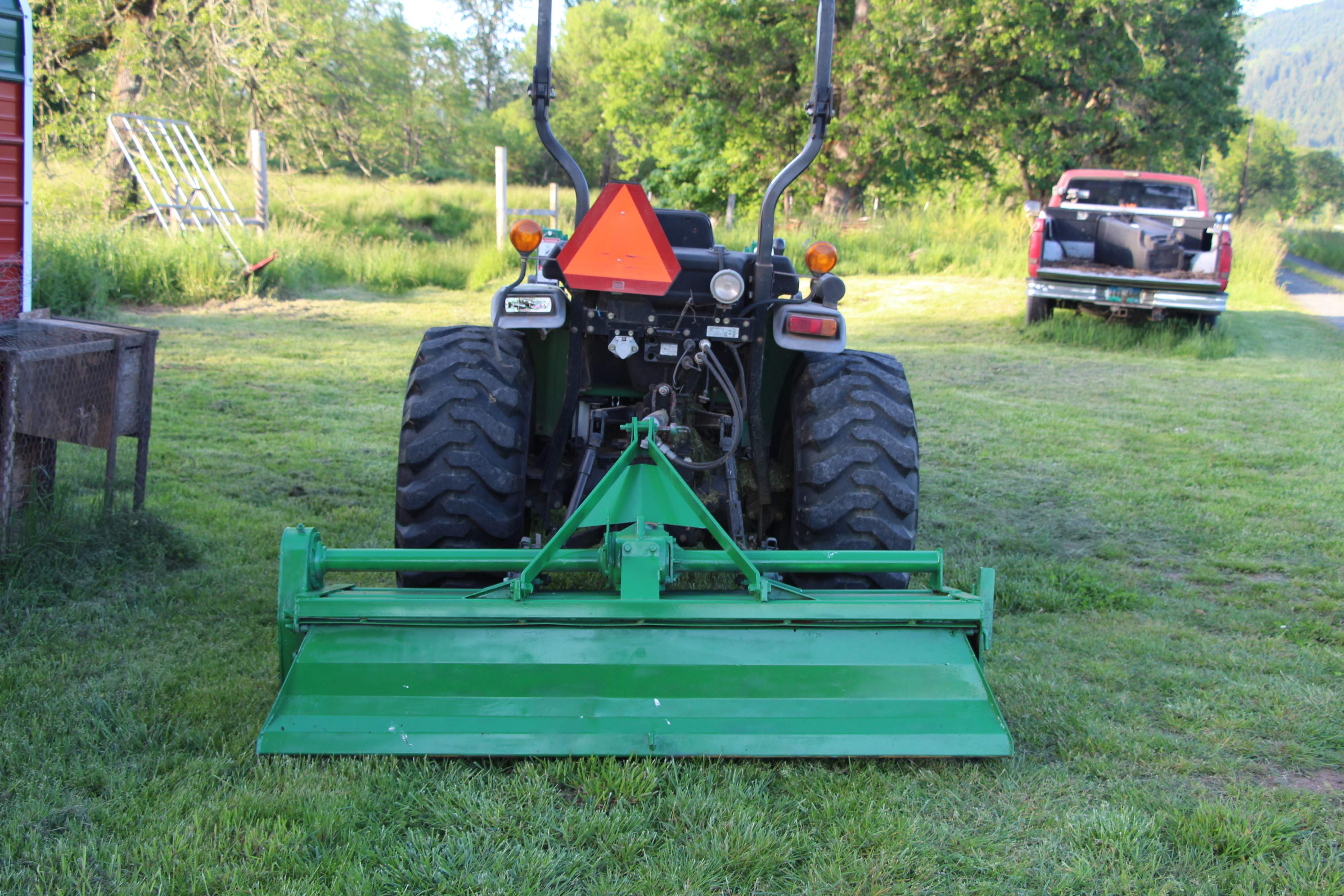

OK, finally a finished shot. IMG_2992.jpg ran it today; a lot quieter with out the cracks and the tin welded down on the ft and rear.
