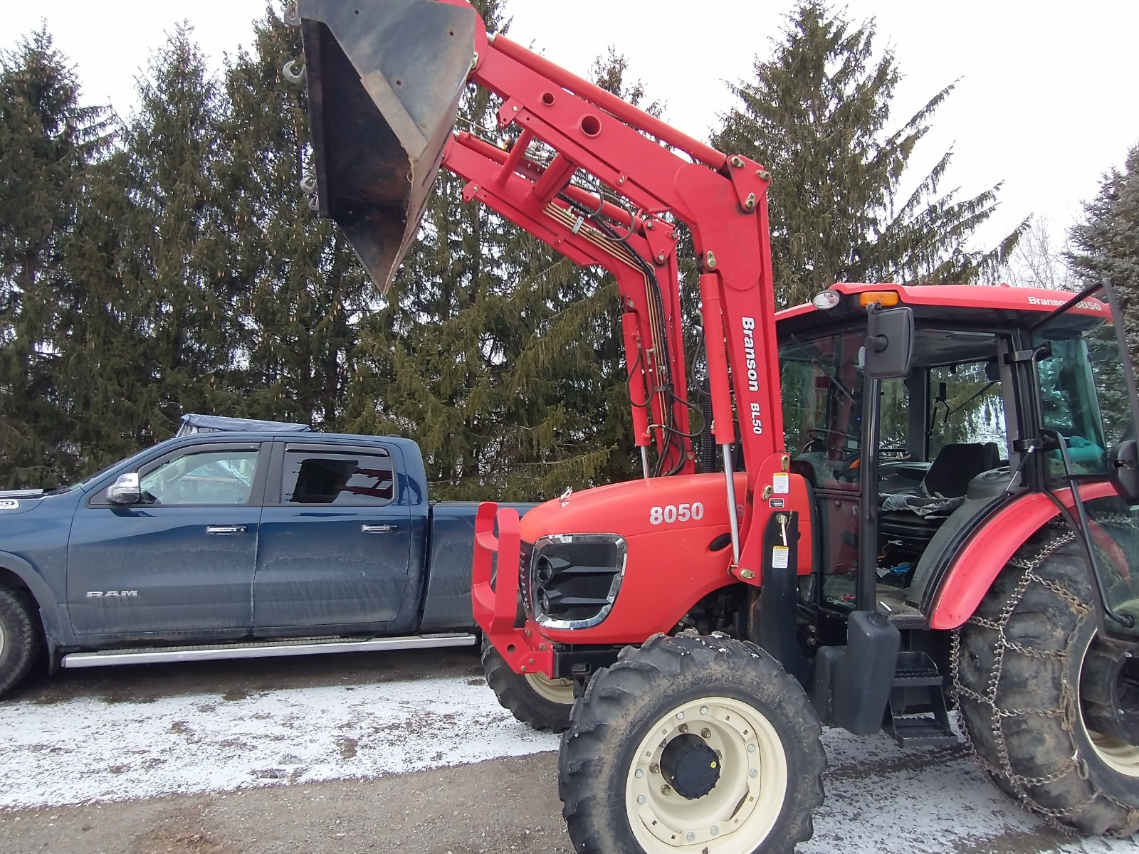

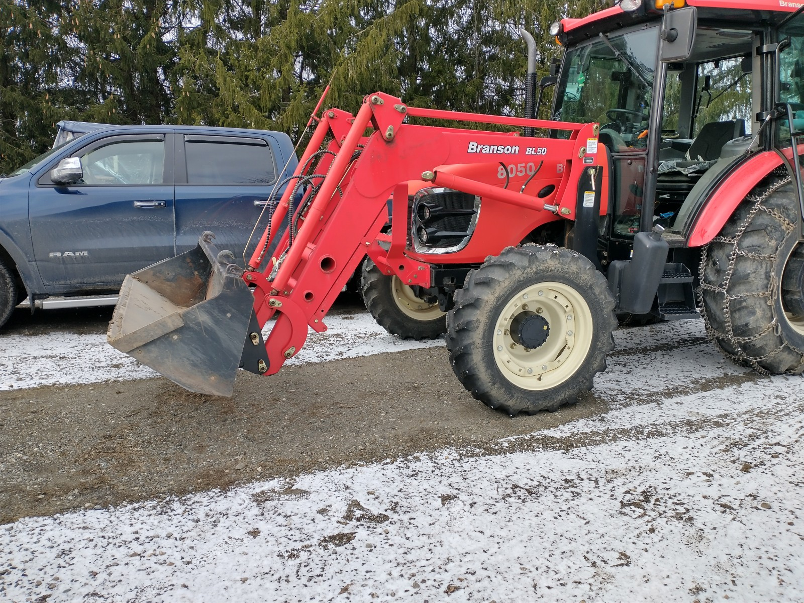

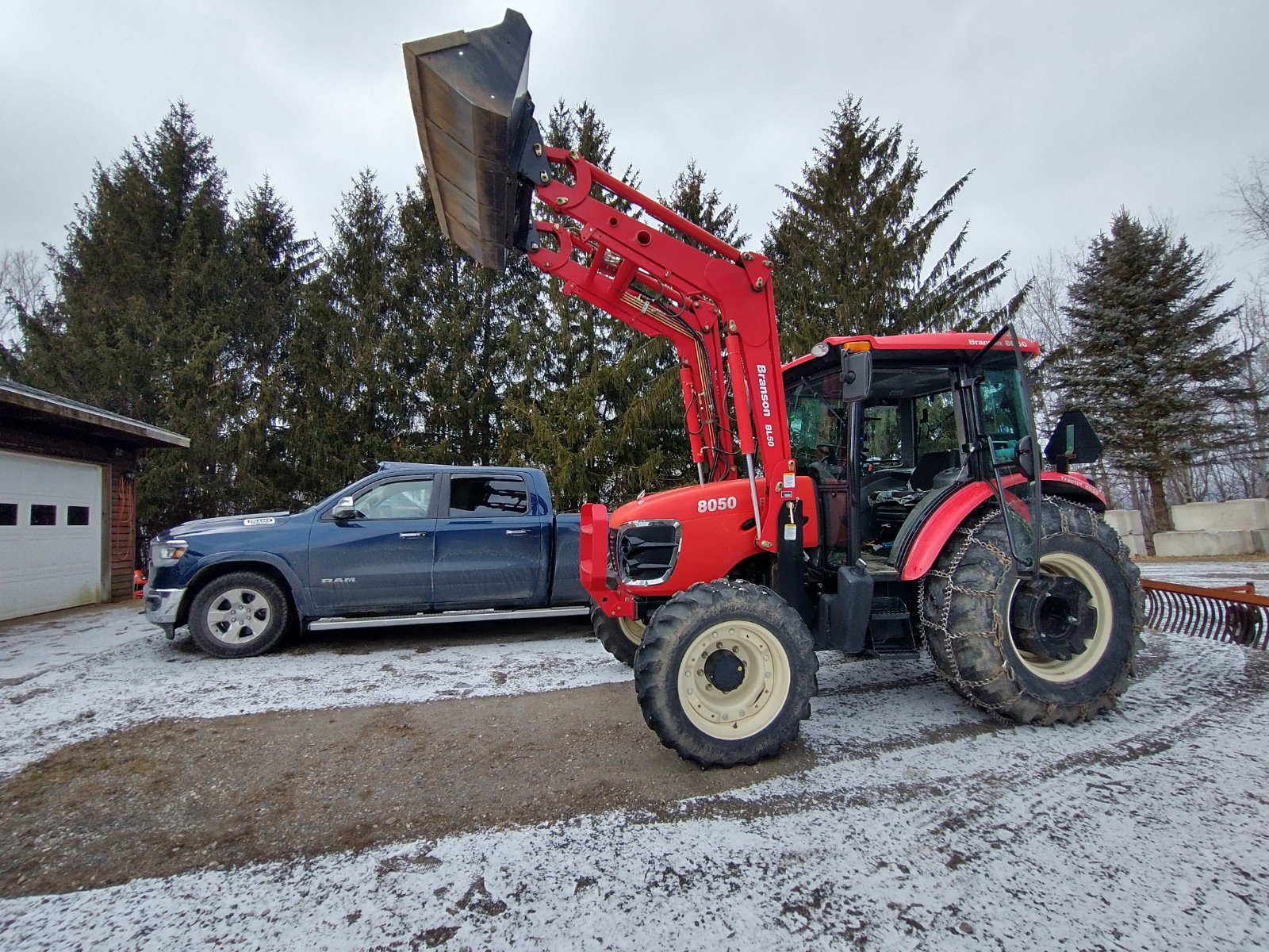

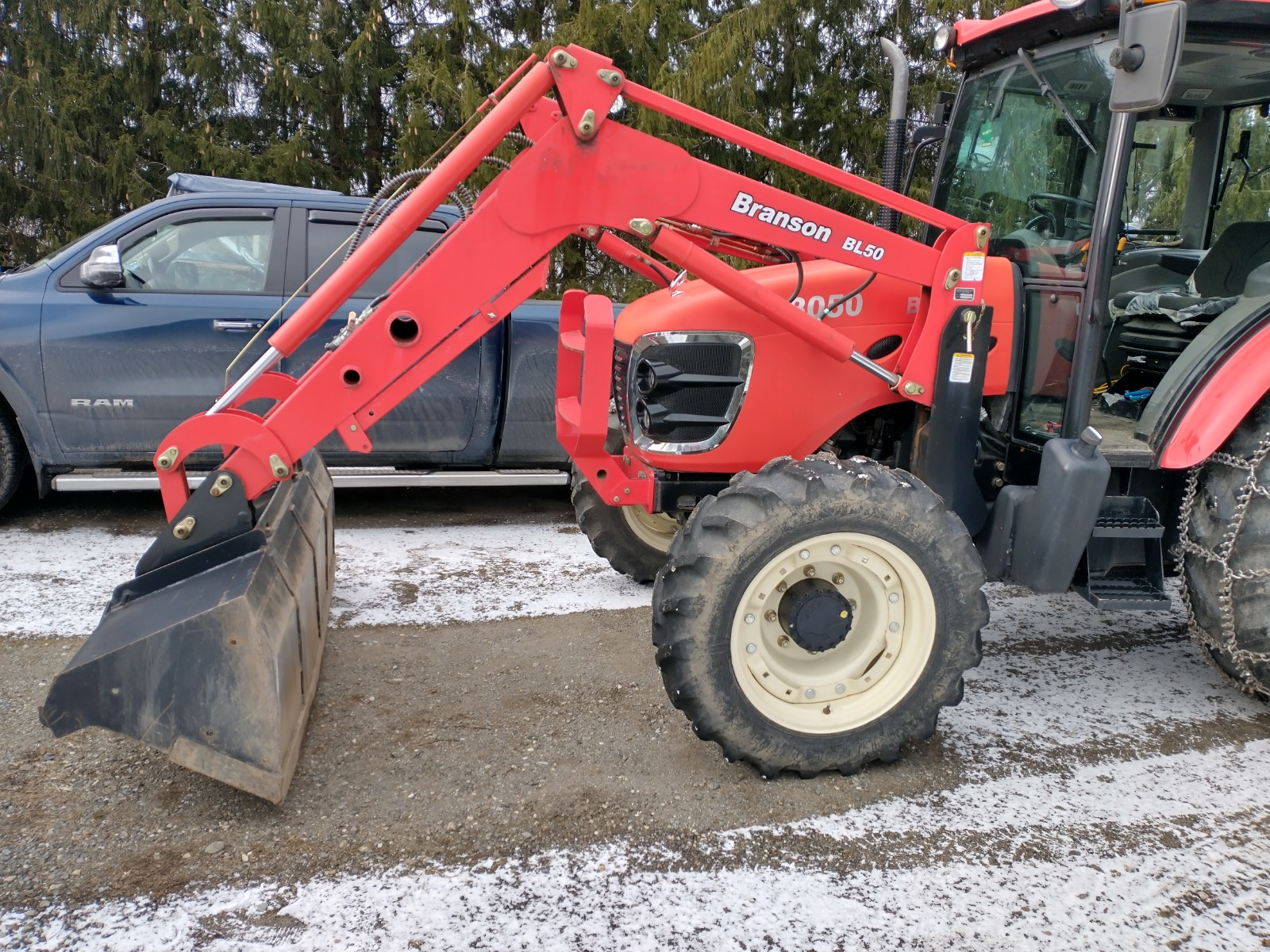

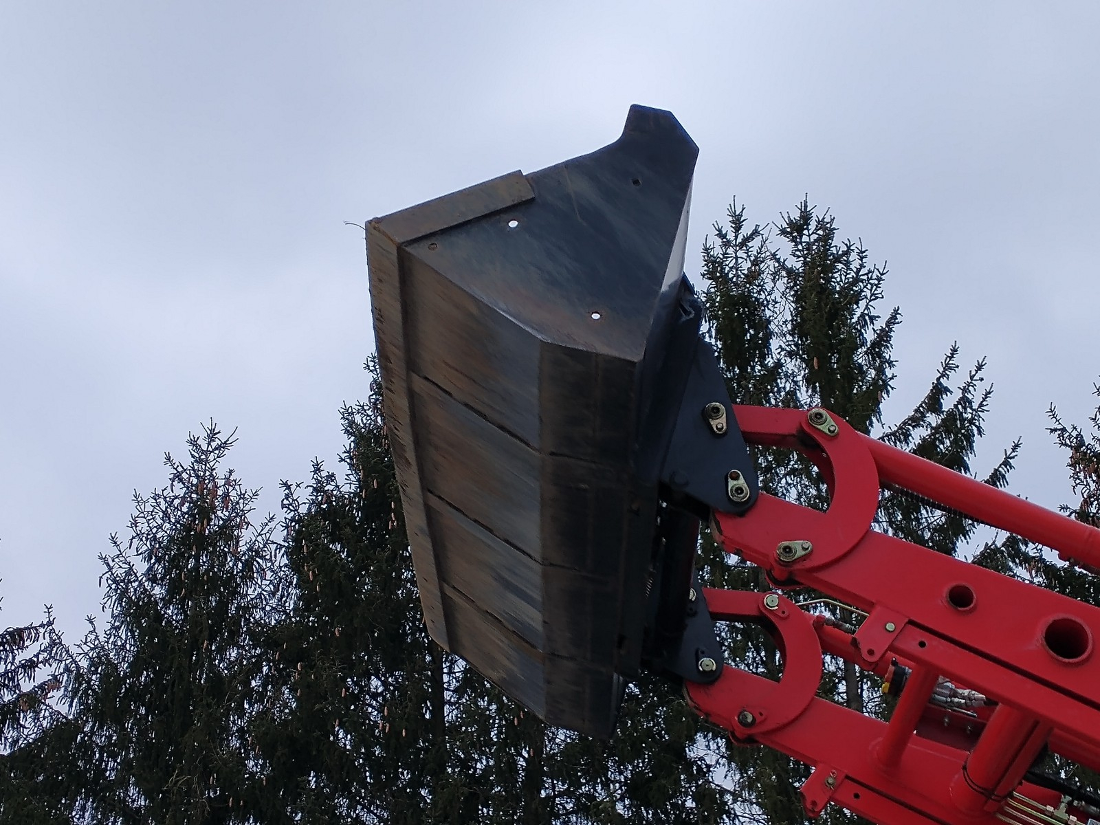

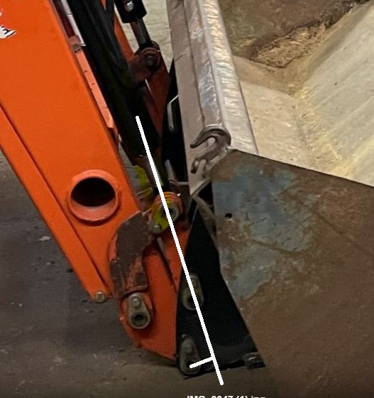

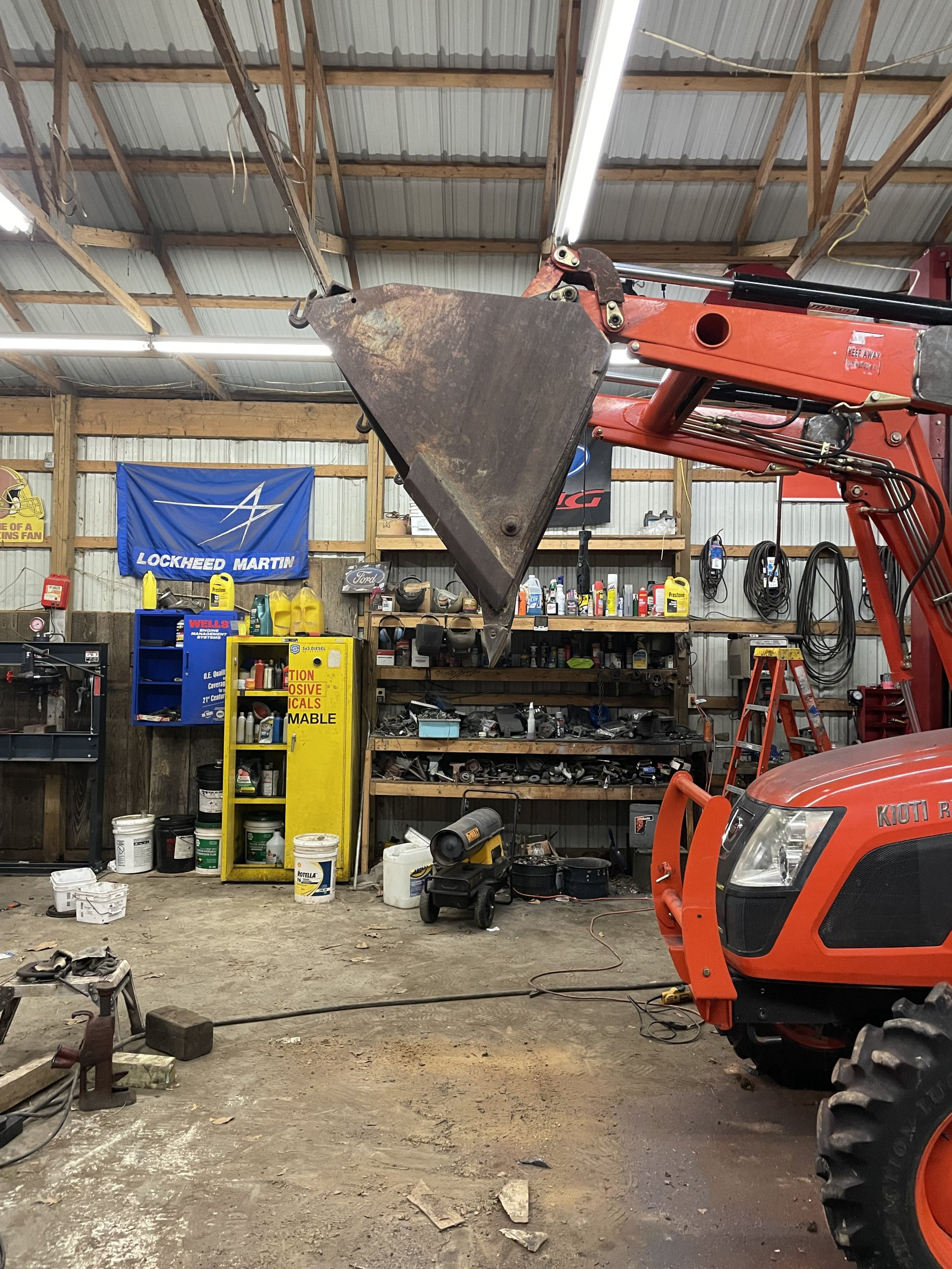

Update: Finished tweaking fabrication of cylinder mounting brackets, tack welded and performed an empty bucket dry run today and the results are what I was hoping to achieve. Pics attached of the before and after mods showing full curl and maximum rollback and the difference is like night and day. I am very pleased with the outcome and plan on welding everything up tomorrow.

/ Resolving self leveling dislike #108
Enjoy her
/ Resolving self leveling dislike #109
Why, that's perfect!
/ Resolving self leveling dislike #110
I notice that there is very little lever arm left as shown in the pic. (distance from the line of action to the bucket pivot point) Do you think that might be an issue?
A load at the end of the bale fork, for example, will put a much larger load on the cylinder when fully retracted as shown. My little Kubota B9200 with it's loader is like this and the bucket is fairly unstable in this scenario.
Just asking as now is the time to check this prior to "welding her up".

Good question npalen, I wouldn't expect it to be an issue with the beefier cylinders and the fact that now it actually sits against the factory stops.
/ Resolving self leveling dislike #112
Are there factory stops for the rollback?
Cant really see them in the pic. But it still looks like the cylinder has a few more inches to retract
#113
Yes, there are factory stops for rollback and it's against the stops.
/ Resolving self leveling dislike #114
As it nears complete rollback the speed will increase and power will decrease. But I think the operator will get accustomed to that.

Just to update:
Was able to get everything welded up and finished putting loader back on the tractor yesterday. This morning we needed to put clean sawdust in the stalls, generally this takes 2 full buckets due to the limited rollback with the self-leveler. I was able to get enough to do all the stalls with one bucket. I am very satisfied with the results but have one regret and that is, I wish I would have done this years ago when I first realized that the self-leveler had no real value ad for the type of work that I do. Thanks for all of the first-rate suggestions and insight that most of you provided to help me step back and think through the process.
