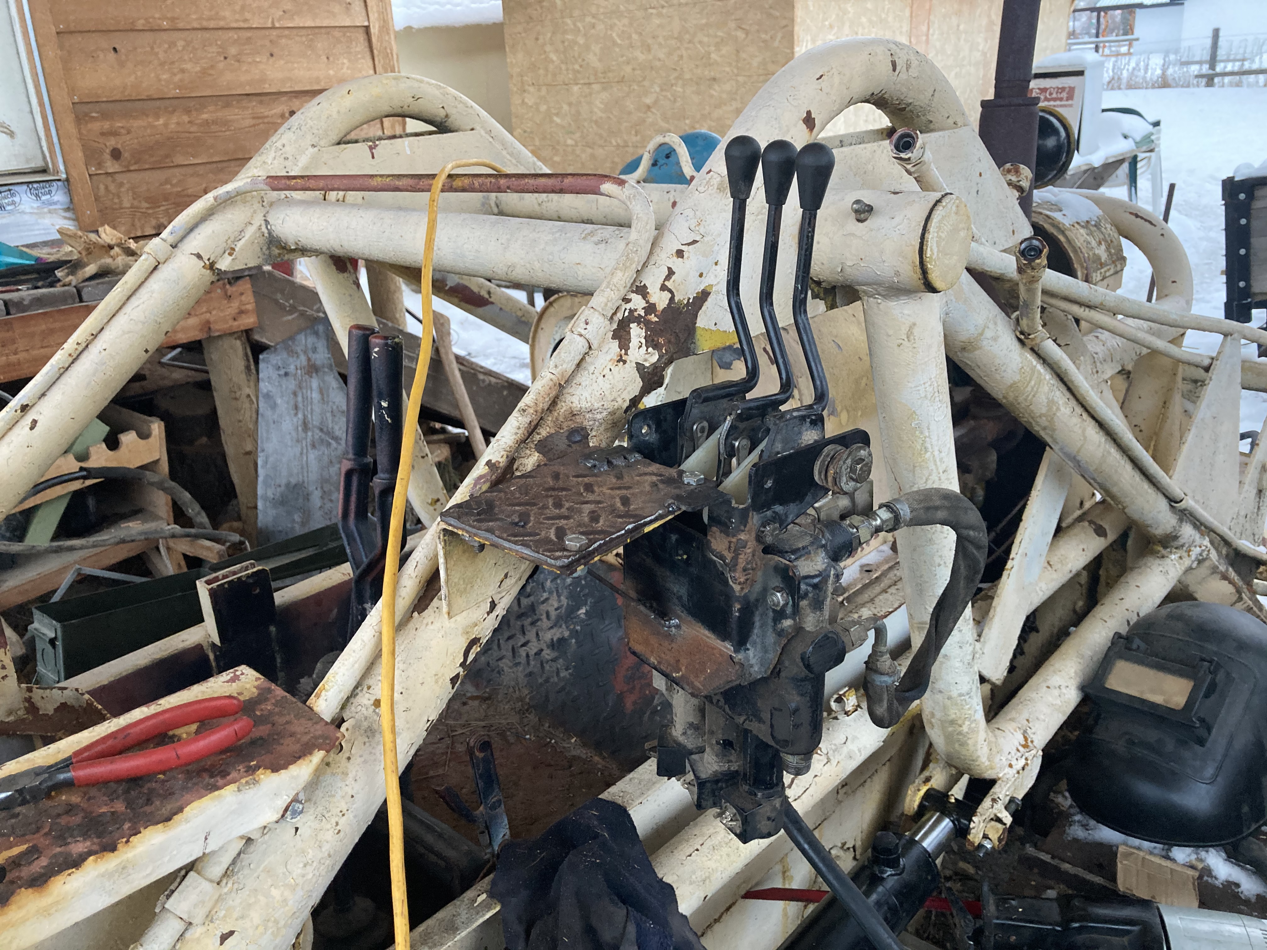

The final installment of this progress report is the installation of the valve and the lift cylinders. Once again, many of the components for this hydraulic re-build are coming from an old Jacobsen reel mower. The valve is no exception. It took a little imagination and a lot of clamps, etc., but I got the valve welded to a plate in such a way that It mounts cleanly on the loader frame. It bolts on, so I can remove it if needed. I'm only using two of the three cylinders for now, but if I succeed in acquiring or fabricating a 6-way blade for this crawler, I'll need the third spool.
I bought the double acting lift cylinders from a company I discovered on ebay. The front of the cylinder mounted up nicely, but the back was wider than the existing mounts. I passed the point of no return on this project when I cut the old mounting brackets and welded new pieces on to make the new cylinder fit. There's no going back now.

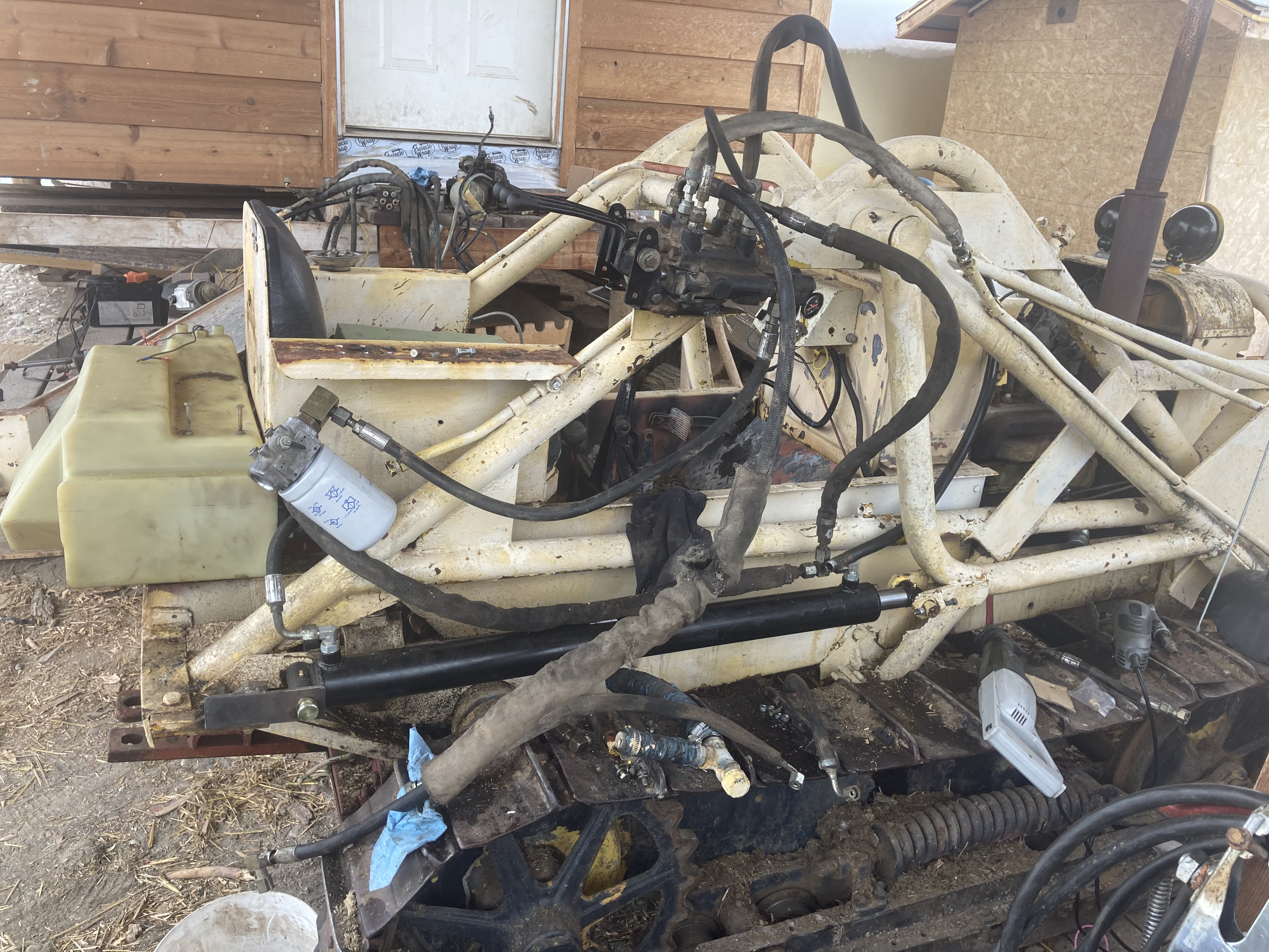

Here's a bit of an update on this project. I went a little less intense with cleaning the lines, and I just use compressed air and a rag to get the bulk of the debris. I am hoping that anything I missed gets caught by the filter and the screen in the tank.
I have used about $100 worth of adapters so far, and I think have all that I need. All of my fittings are ORB and all of my hoses are O-ring face seal. There are three fittings that I can't get locally, and I have ordered them from fittingsandadapters.com. I have never used them before, but they looked legitimate. I was satisfied with their system of organizing things in a way that was easy for me to find what I needed.
Call it luck or call it providence, but I used up every 1/2" hose that I could pull off the old mower, and I had exactly what I needed. It was a bit like playing "Go Fish" to arrange hoses where everything would work, but in the end I'm happy with how stuff is layed out. I'm still waiting on those last few adapters before I can start the machine and see if anything I have done actually works.
One problem I did identify without running the machine is that the old valve placement would have been uncomfortably close to the lift cylinders at full height. I decided to play it safe and just re-oriented the valve horizontally rather than vertically. I'll likely heat and bend the valve handles at a later date to get them pointing up. I don't know if there's any advantage to the handles pointing up, but it's what I'm used to on my other tractor.
I've attached a few pictures to show the current progress. Unfortunately it seems like there is never a good way to route hydraulic hoses without thinks looking like chaos.

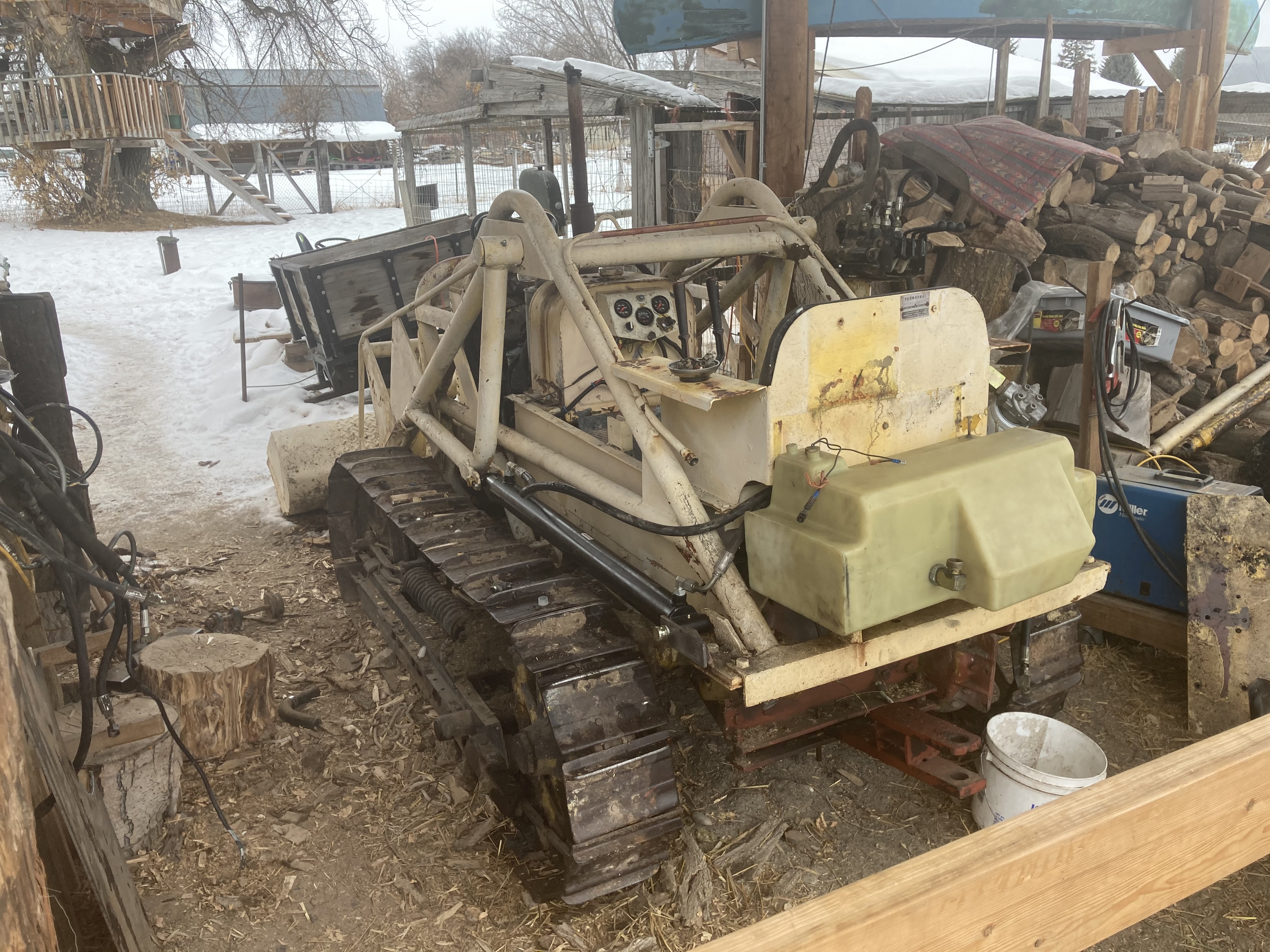

While I'm in here ranting about the fittings supplier, I should probably post an update on the project...
The valve that I scavenged off of the mower has some interesting float functions that don't work for a loader. The lift spool floats up (i.e. the valve will produce down pressure, but won't hold it), and the curl cylinder floats down. I also was only getting about 3 gpm, and the lift cylinders were VERY shaky on the down stroke.
I upgraded my suction line from 1/2" to 3/4", and this increased my flow significantly. I also purchased a cheap eBay valve to go with my cheap eBay cylinders. I'm getting 6 gpm now, and the loader functions like it should. The new valve eliminated the shaky down stroke of the lift cylinders.
At some point in the future I will probably upgrade my curl hoses to 1/2" to match the rest of the system. I have smaller lines there right now. The speed of the cylinder is fine, but I can hear the engine bog down when I run that spool, telling me that the restriction from the smaller lines is too much.
I still have little incidental stuff to do, like strap my tank down and zip tie the hoses to each other and to frame pieces where I can. But, in general, I'm considering this project successfully completed.
