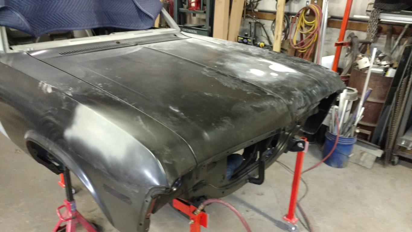

Back on the original topic, I finally got both new front fenders hung on the Nova. These are from AMD (Auto Metal Direct) in GA, and they fit WAY better that the Dynacorn junk I had before. The left fender fits really well with no modifications needed, the right one needed a little surgery on the lower area just ahead of the door and rocker panel. When flush with the door down to the lower body line, it fit pretty well, but below that it was kicked out about 3/8", with no way to adjust it to get a better fit. So, I took it off and made a cut through the reinforcement on the back side with a cut-off wheel, bent it in the proper amount, hung it again to check the fit. Looked good to I loaded some .024" wire in the Miller 211 and stitched it back together. A little smoothing up with a die grinder and a flappy disk and some black paint and you can hardly tell it was molested. Now it fits really well, at least to my eyes. Next I'll get the hood on and see how it fits up to the new fenders.
Going to be a few days though, as I have my niece's JD LA125 mower to work on, and it's damn near a basket case, used, abused and left out on the weather year round. Looks like the mower deck had had a pulley failure of some sort, haven't gotten to that yet, just got finished servicing the engine, including replacing the fuel pump and fixing an oil leak. What a friggin' mess! All four tires are the originals, and leak like seives, so those are getting changed too.
I'll get pictures of the fenders on the car tomorrow and post them.
   / Restarting My '70 Nova Project
#170
After getting the fenders and hood aligned and fitting well, my friend came over and we worked on fixing a few dents in the right fender and hood made during shipping. When he gets more time, we're going to start priming and block sanding them. The quarter panels, trunk and doors have been blocked out already.
