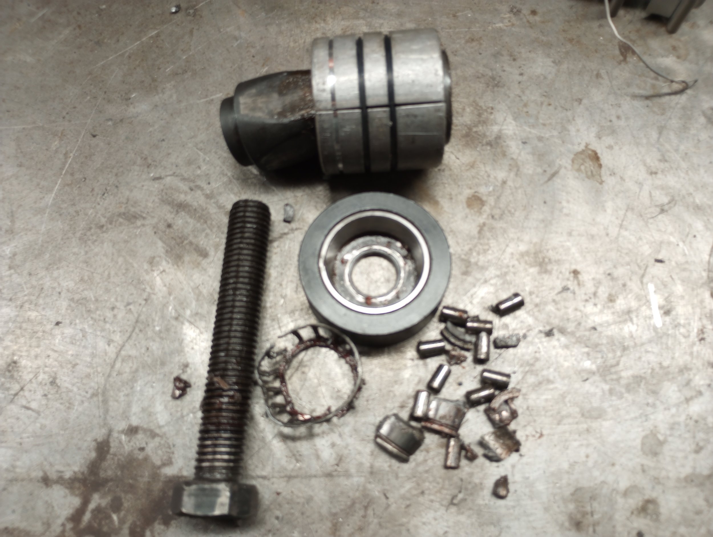

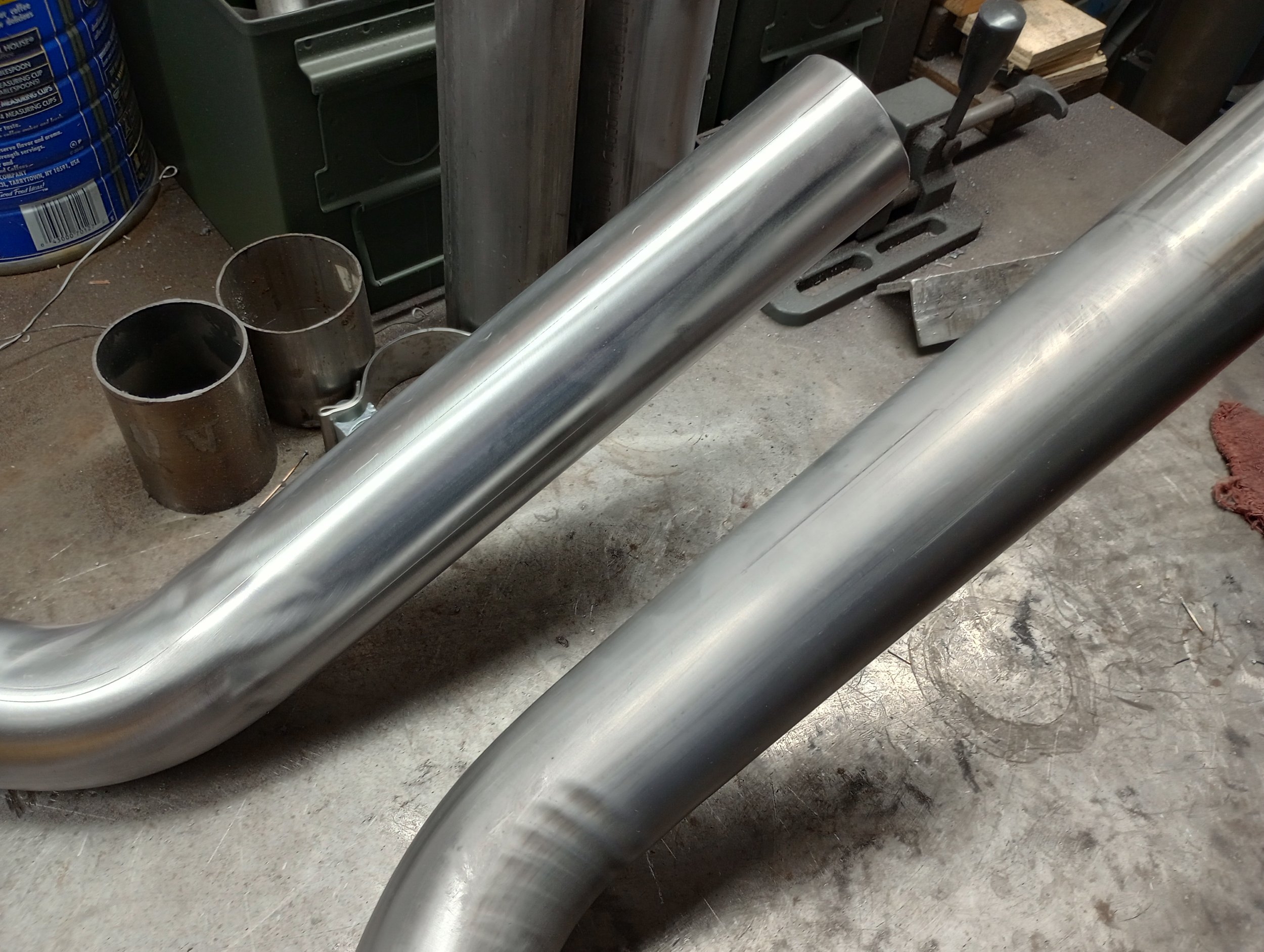

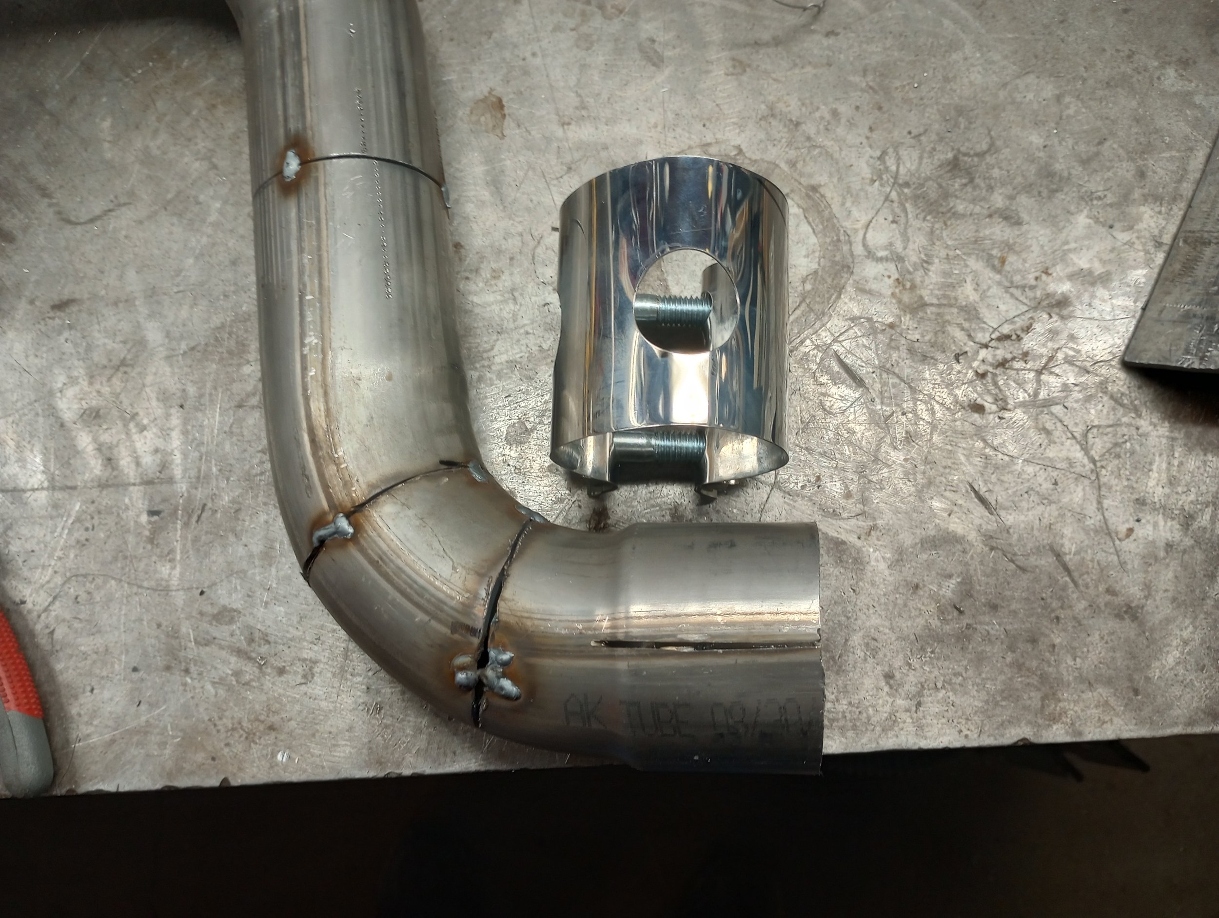

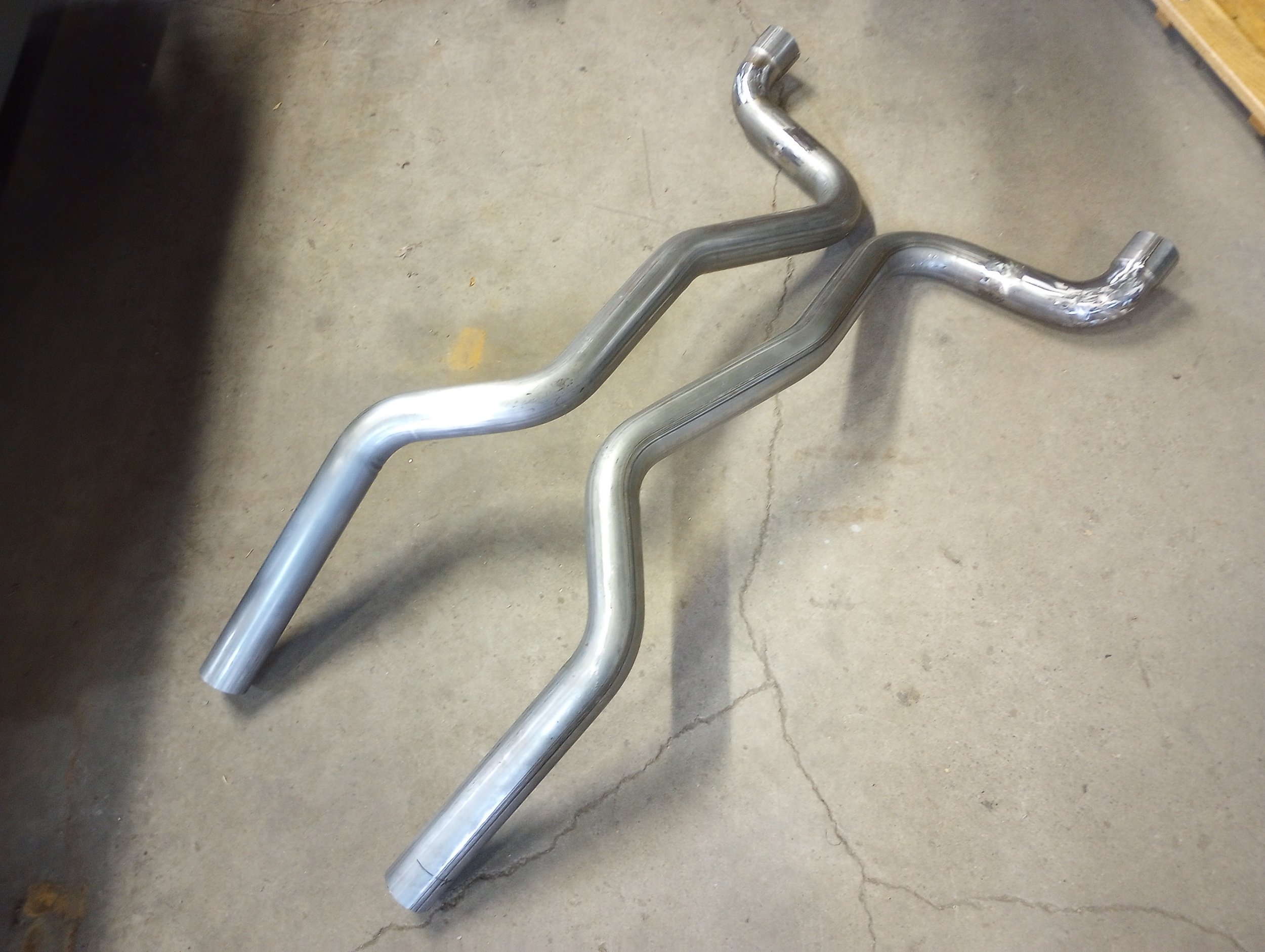

Well, I finally got the exhaust finished up. The new tailpipes sort of fit, well, not really. The end that attaches to the outlet of the muffler, extended too far forward, so I had to cut ~3 inchesoff and reswage the pipes. I had bought a tail pipe expander a while back and I used it to swage the right side pipe, and went a little too far, so I had to put some slits in it and use a heavy band clamp to squeeze it back down. Then the bend that takes it up over the rear axle wasn't sharp enough, so I made a couple of slice cuts to get that corrected. Then the pipe was pointing out away from the car so it wouldn't fit under the body, between the rear fender and the spring, so I cut the pipe, modified a band clamp and used it to hold the pipe pieces in the correct orientation so I could weld it up. That finally got the tailpipe exiting in the right place under the bumper. The welds were not pretty to I smoothed them up and used some Scotchbrite type pads for an angle grinder to polish up the dull finish on the pipe.
Then repeat the process on the driver's side pipe. Them, when I was swaging the second pipe, the bearing on the pipe expander went to hell. They used a tapered rolled bearing about the size of the outside bearing on the front wheels of the Nova, which was completely wrong for that application. It didn't have anywhere near the thrust capacity required and disintegrated when I was about a 1/16" from the pipe being swaged large enough. I was able to jury rig it and get the job done, but it's a piss poor design. Yesterday I got a regular thrust type roller bearing and modified the tool to use it. I haven't tried it yet, but it has to work better than the original bearing as it has about 10 times the thrust load capacity.

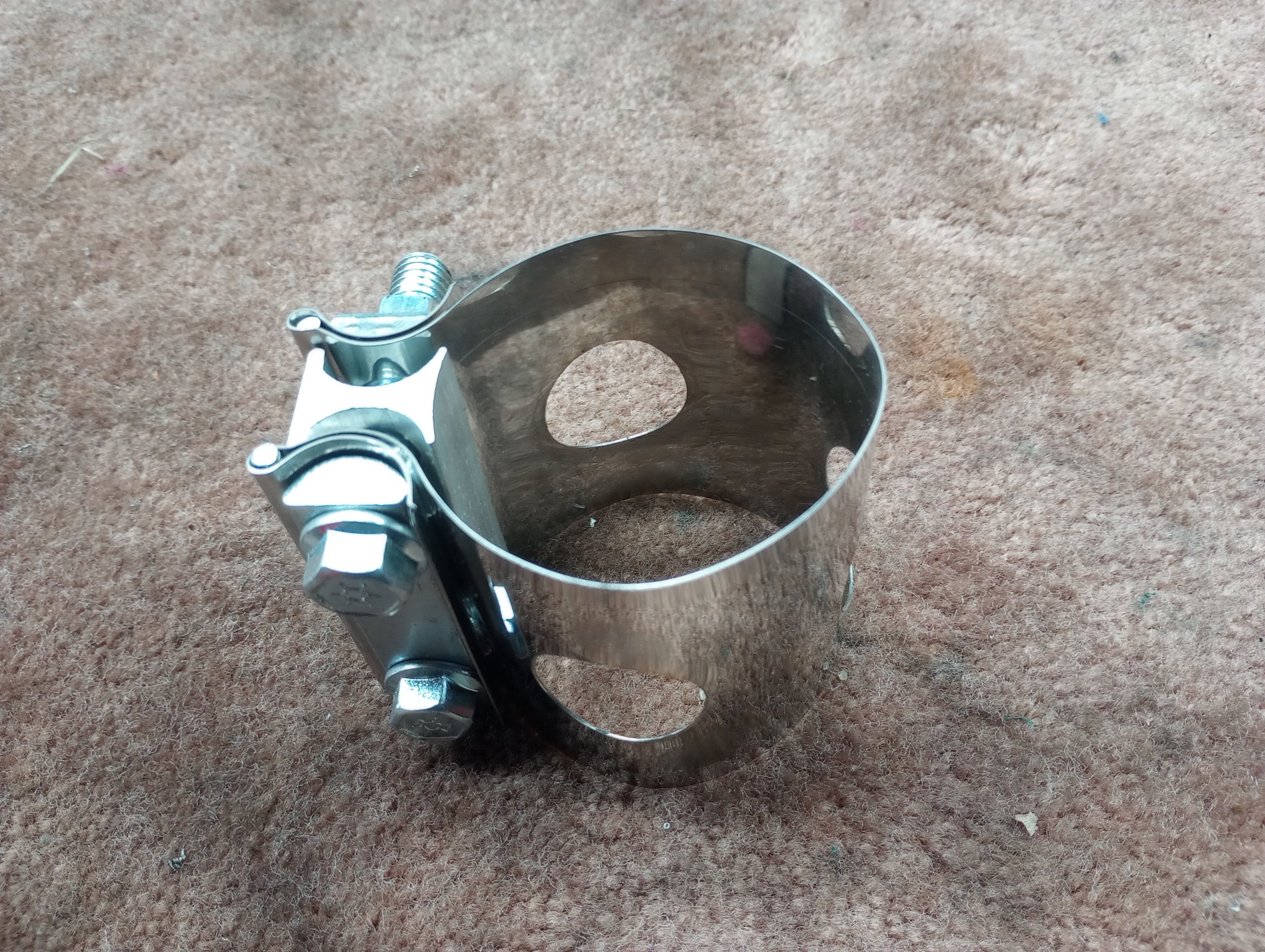

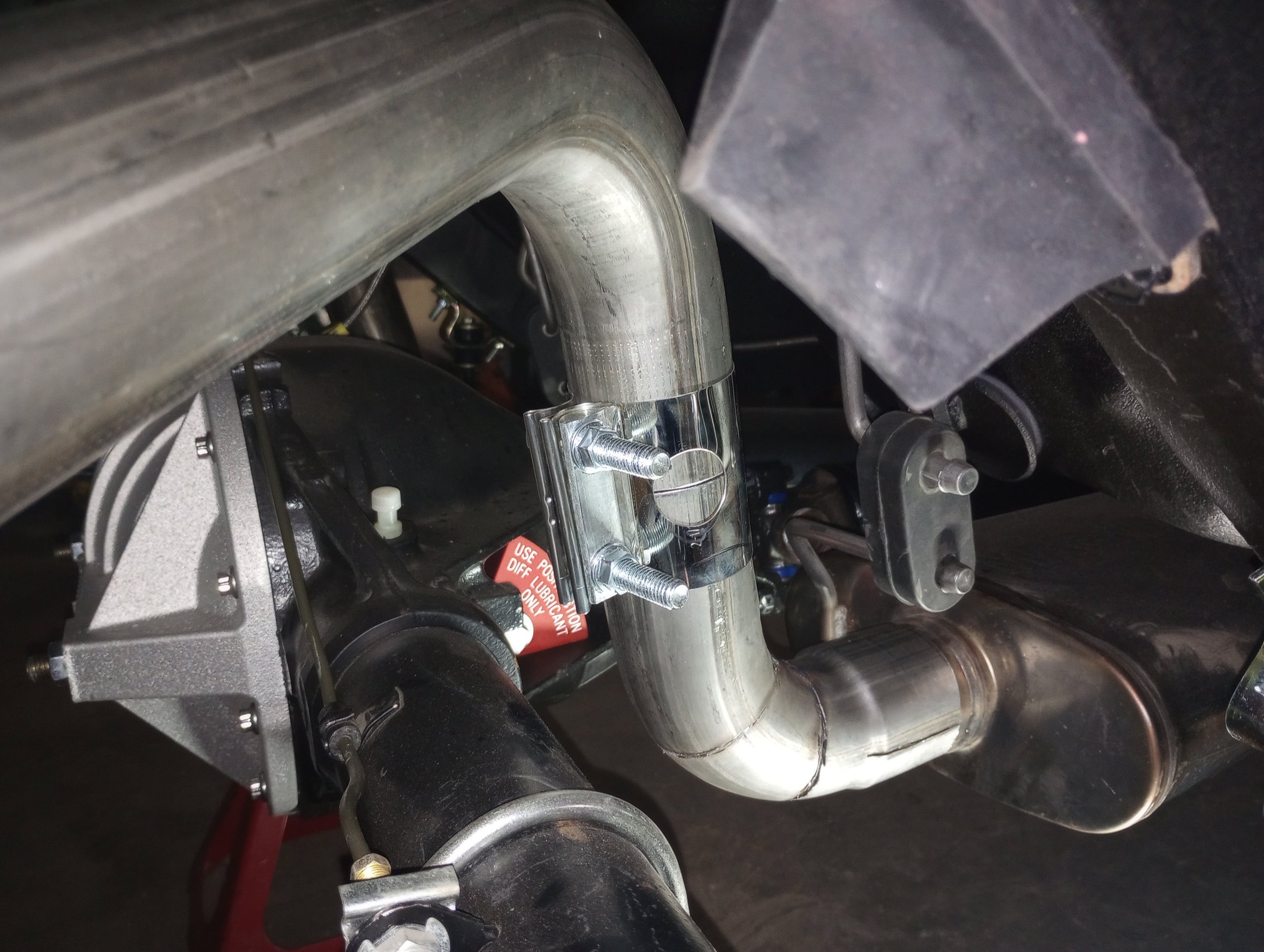

I needed to use some kind of mount to hold the pipes in position at the rear, so I bought a couple of mounts from Summit racing, welded them to the pipes, and fabbed a couple of brackets to bolt them the the trunk floor. Last thing to do was to slide the chrome, angle cut tips on, mark their positions, cut the tailpipes to the right length and clamp them in place.
I think I have had the tailpipes on and off at least six times during the process, but I got 'er done.
